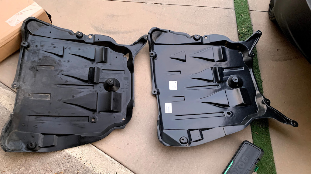

songzunhuang
- Posts: 374
- Joined: 08 Jan 2009, 21:04
- Year and Model: 98 V70 T5
- Location: Silicon Valley, CA
- Has thanked: 2 times
- Been thanked: 30 times
Namo, I'd take off the skid plate. It'll be less messy in the long run. It's not hard to get under the XC90 since it's got lots of ground clearance. Incidentally, I got an aftermarket skid plate when one of the mounting arms in the rear on my original broke off. It was about 1/3 the cost of an OEM Volvo part. It's not as sturdy, but it should be fine. In the picture below, the aftermarket part is the clean one.
Good luck with the fix. Mine has held up extremely well. Car just flipped 159,261 miles on a recent ski trip. I made the upgrade at 101,638 miles back in March of 2015.
