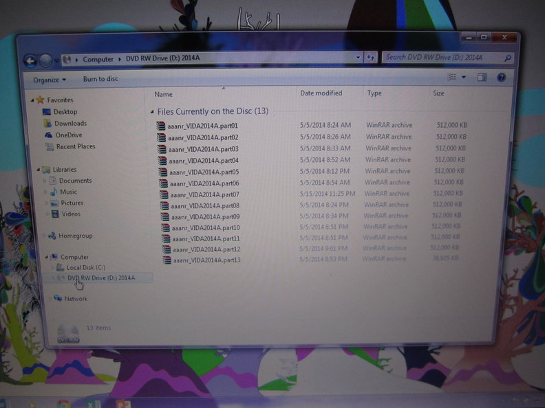

From what you say there should be a 'patch file' on the disc. I have posted a picture of the disc content:
There is no patch file here.

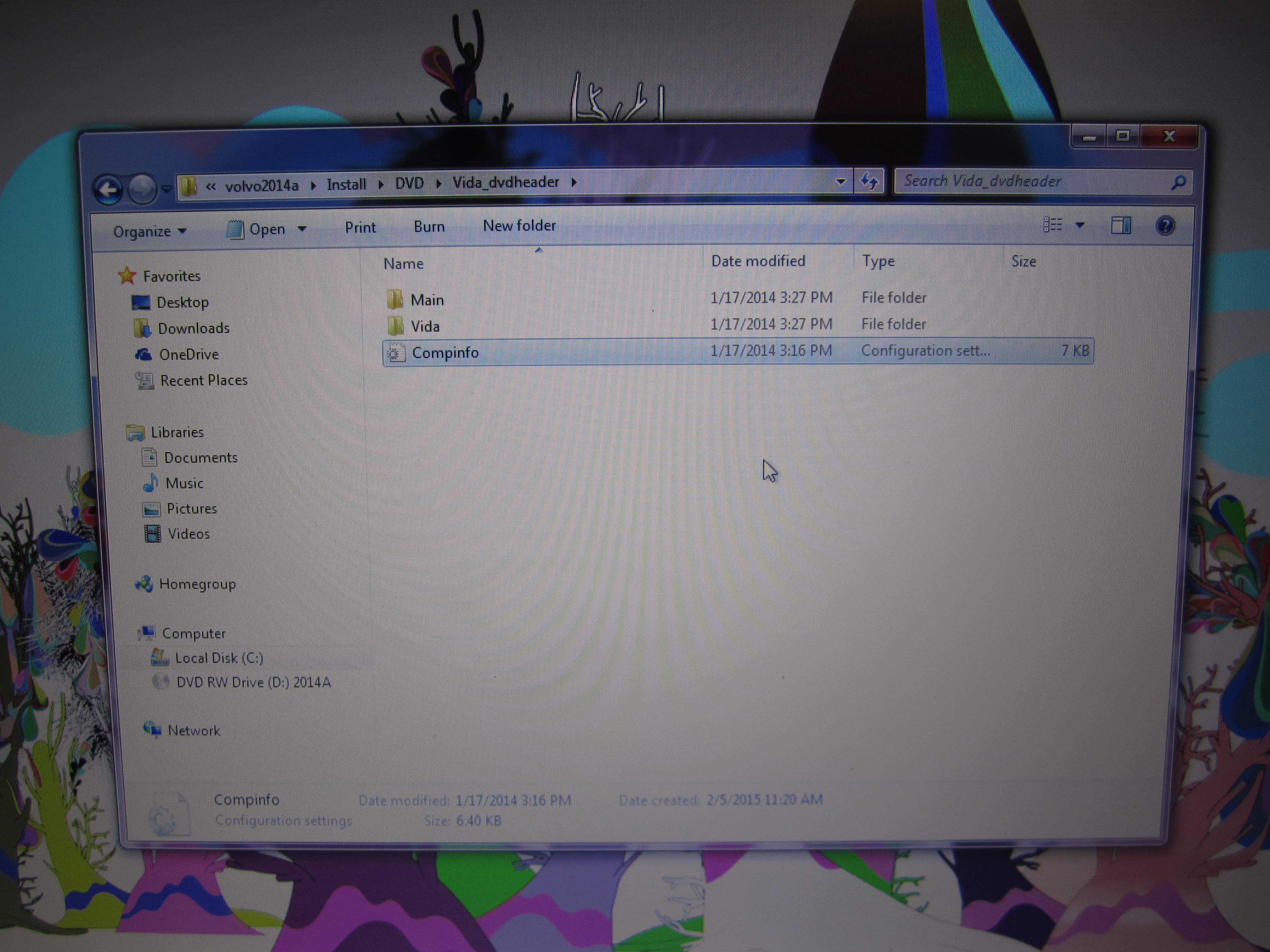

I then decompressed the disc files and got a file named VIDA which has these 3 files:

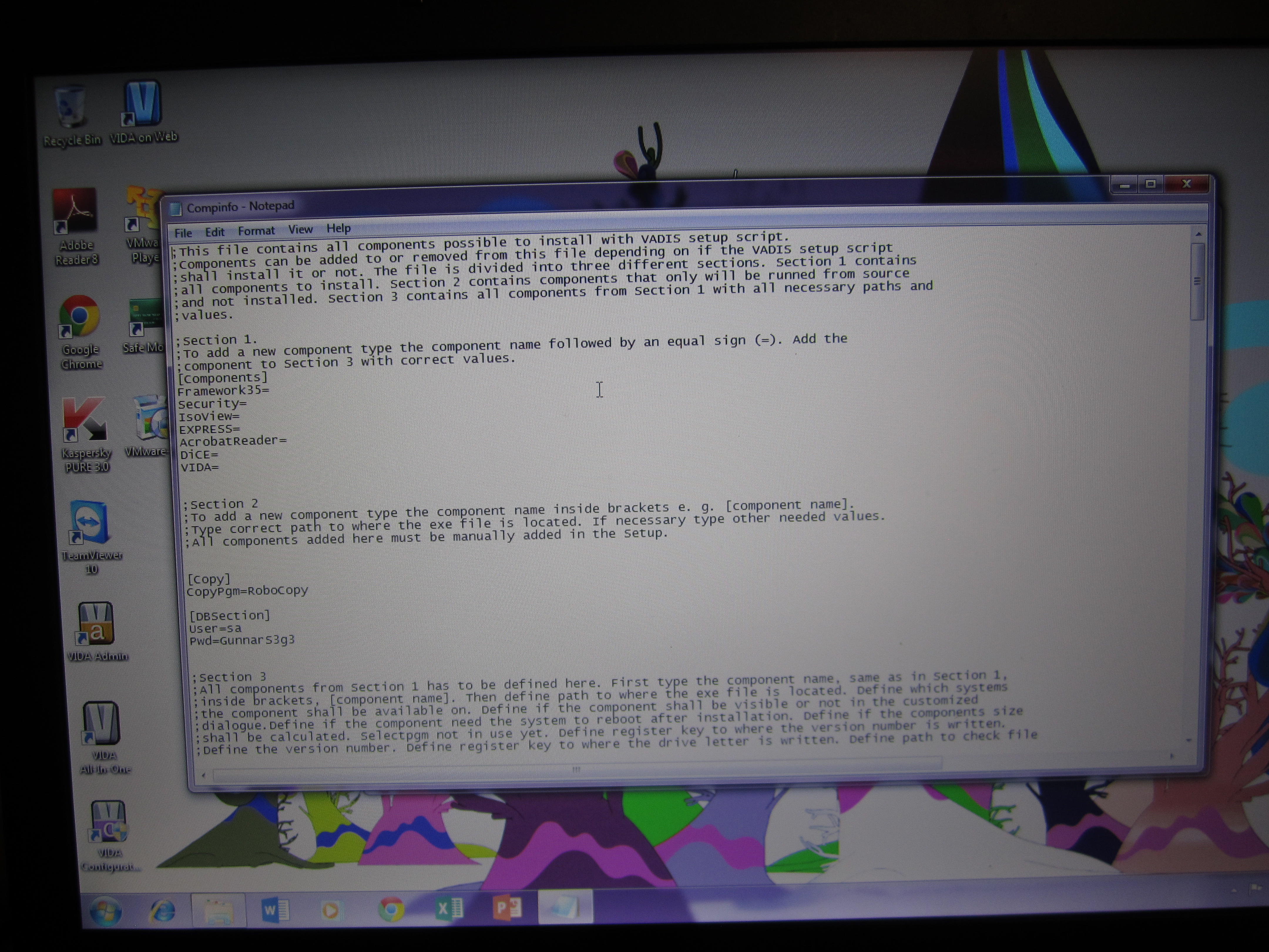

Opening the Compinfo file gives this info and more:

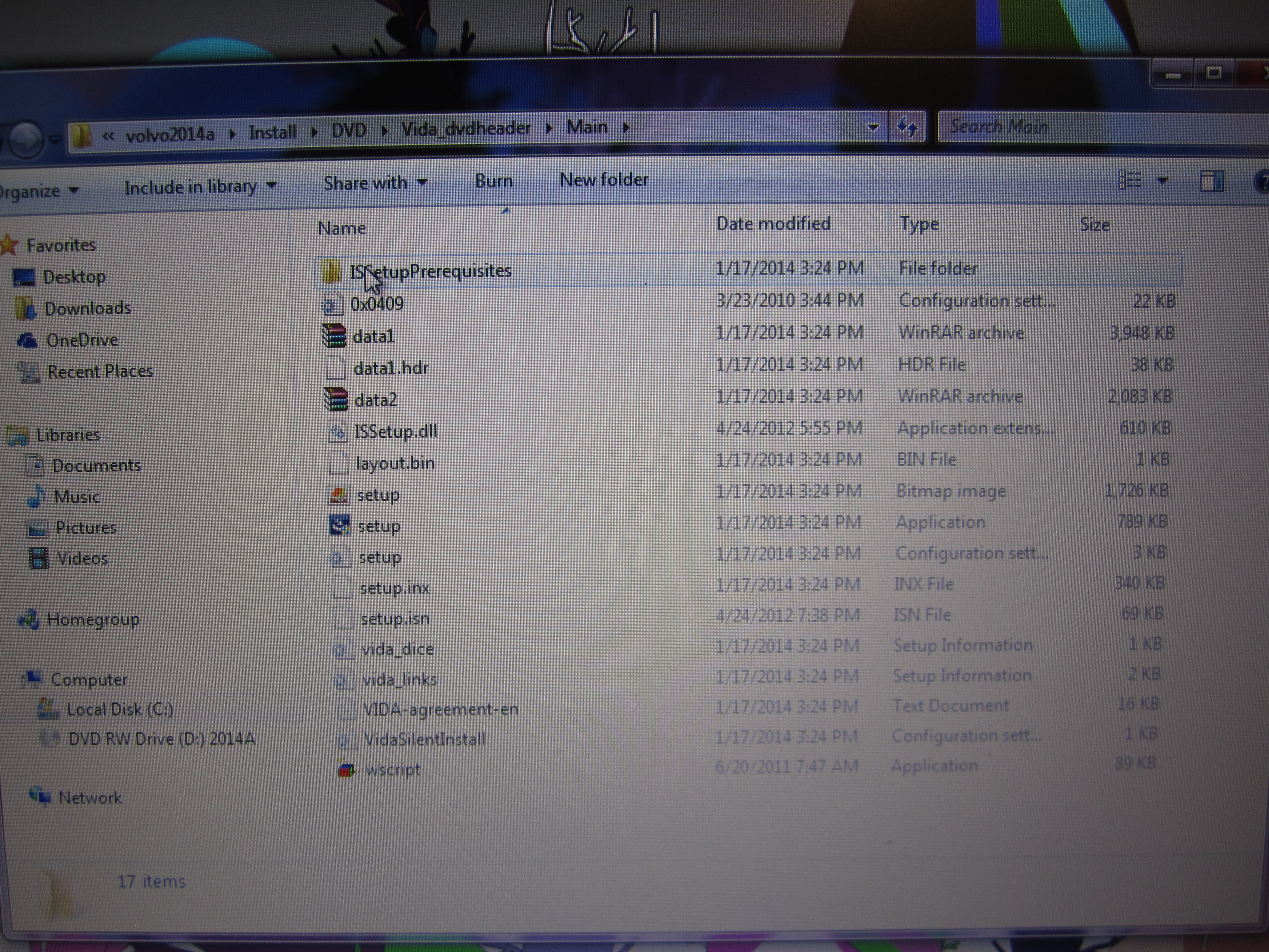

If I go into the file named MAIN I get these files:

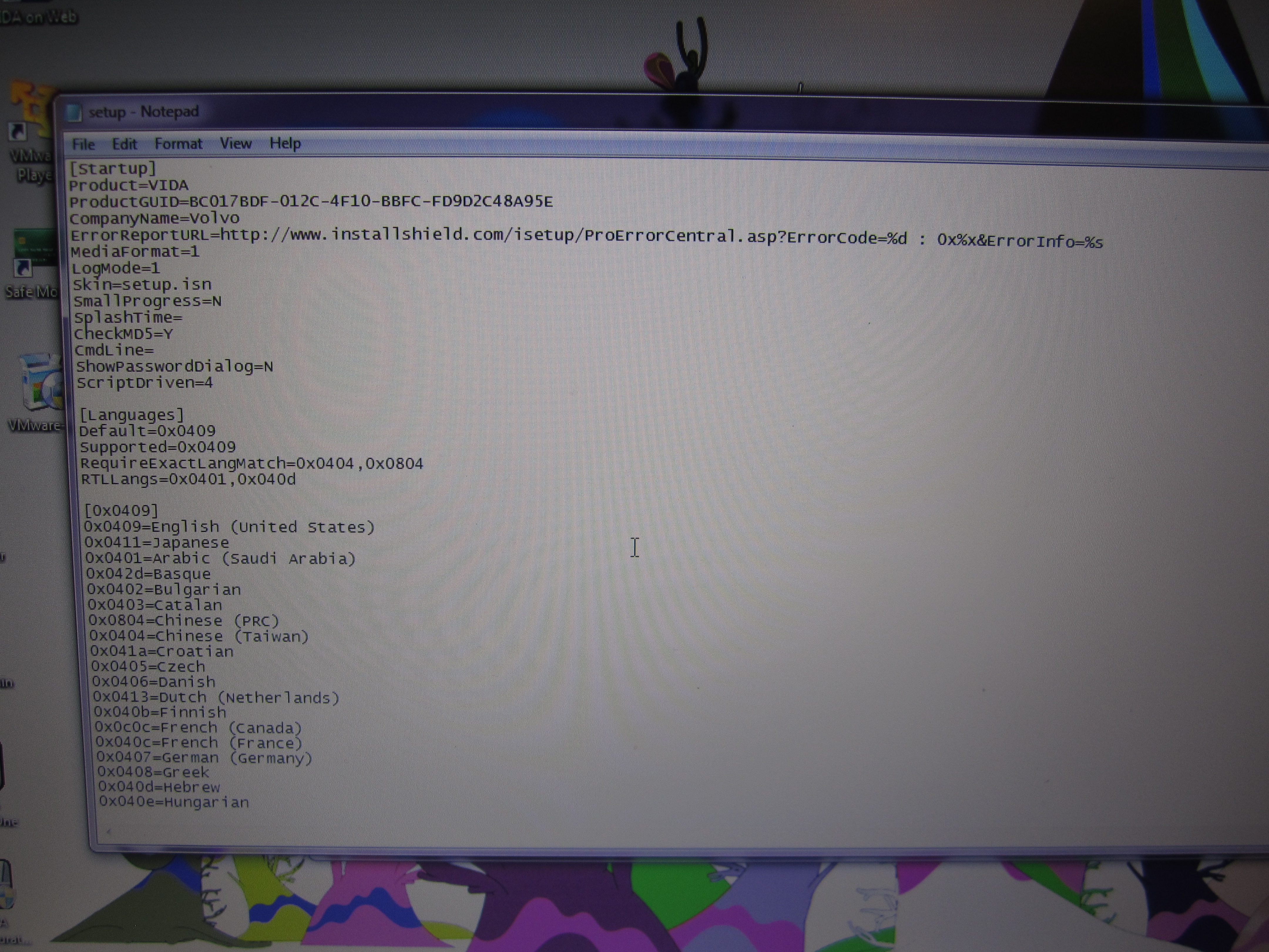

Opening the SETUP instruction file you get this content:

old VIDA 2012, 2013A should be installed on Win XP or Virtual machine, but 2014A or new 2014D MUST/HAVE TO be installed on Win 7, do do not need to installed it on Virtual machine running XP mode.scot850 wrote:Need help here. Received my DICE unit a couple of days ago from the recommended supplier and I'm working with Mandy Deng to figure this out.
2014A is supposed to run on XP or Win7 Pro. I had some issues getting 2012A running in VWware in Windows 7 Pro, but with your able help on the forum I got there in the end.
As supplied, the disc for 2014A has 13 files in 'Winrar' compressed format.
I have tried to 'un-pack' the files and store on the 'C' drive into a new file both directly from the disc and by copying the files over first and then un-packing.
Once un-packed, the files become one and I have then dug down and found the 'Setup.exe' file and run that. However, every time I run that, it comes up with a screen as below:
