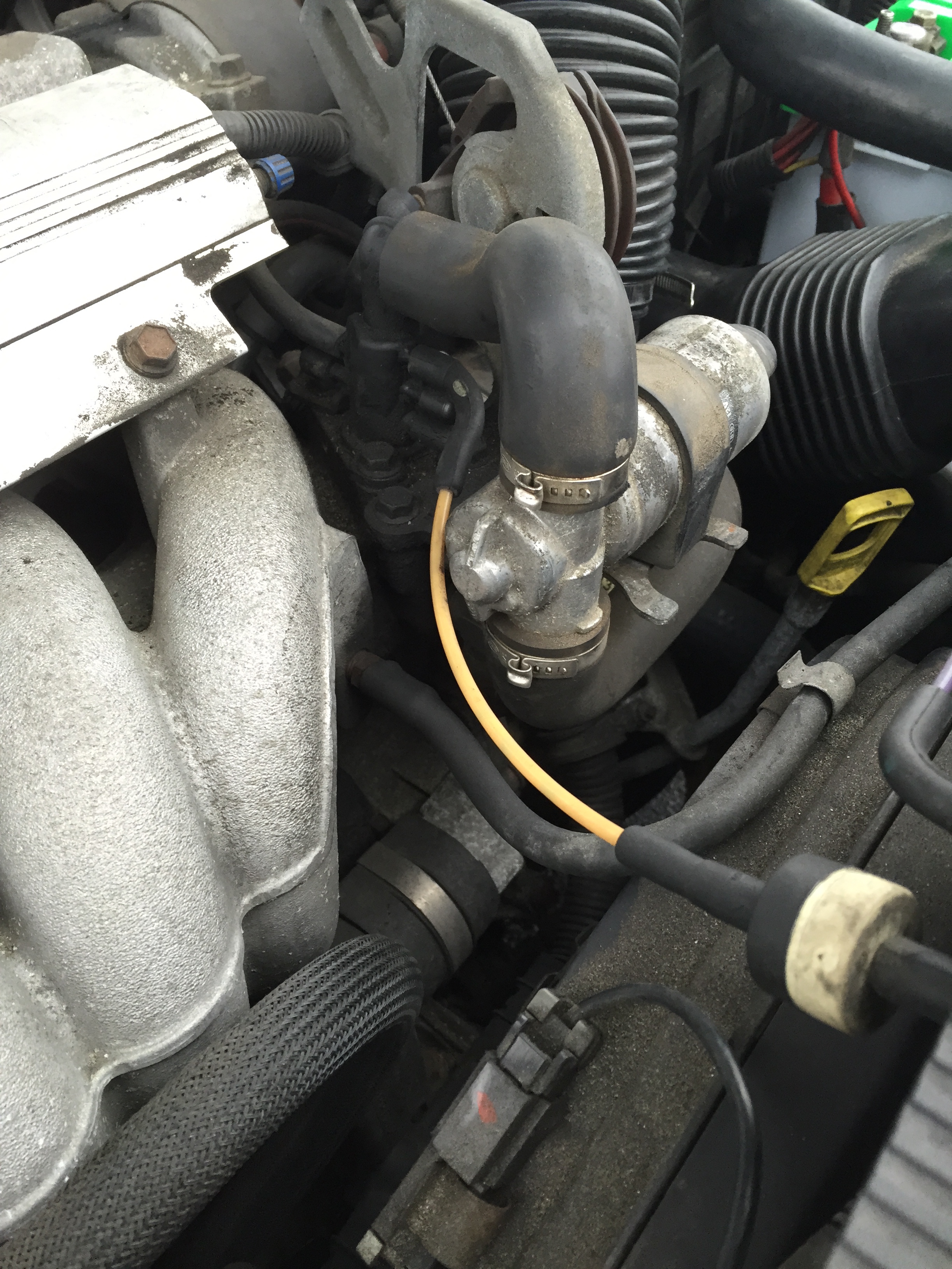

OK, checked all the vacuum lines - for the most part they seem fine. The only one that was broken looking was the line that goes from the vacuum tree to some sensor/valve on top of the fan shroud. Its not actually on the the diagram that erikv11 linked to, so I'm not sure what it is/does. Its the yellow line in this photo. I replaced it with a rubber vacuum line - I assume this is fine to do?
Vacuum tree
Vacuum tree
Took it for a drive after changing that and it drove fine - but it isn't a Thursday so it would have driven fine anyway...
Is the IAC the shiny piece of equipment in the front of the photo with the two thick lines coming out of the top and the bottom? If I take it off and clean it, can I just replace those clamps with the screw down type clamps?

@ 850corb: that white line is a vac line for the SAS, it goes to a solenoid valve at the fan and then that purple line (barely visible in your pic) goes from the solenoid to the SAS valve, back near the exhaust manifold.
Check the top of the thread there is some explanation that the info refers to non-SAS cars. But also, there is a diagram at the very top of the thread that shows how to route the extra lines for SAS, if you want to keep it.
And yes and yes on the IAC and its hose clamps. Clean it out real well with carb cleaner. Work in a well ventilated space. :)
