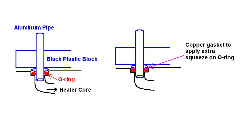

I made a simple sketch re O-ring, this is generic stuff re O-ring.
- In the recess (in the heater core), the depth is important: if the recess is a bit deep (we are talking 1/10mm here), the O-ring iwill be somewhat loose (not squeezed enough), so it will leak under pressure.
- Or the O-ring may be a tad too thin, again maybe 1/10mm thinner than Volvo O-rings (just a theory).
- By having an extra copper gasket (or something similar such as plastic ring found at firewall coupler), the O-ring is squeezed better, fixing the leak.
I understand some people get away with the ebay O-ring and some have leak using ebay O-rings.
I knew about this ebay O-ring leak from another forum, someone had the exact same problem as mine: leaking ebay O-ring, he fixed it by adding the plastic ring (found at firewall coupler).
Anyway, photo below...

- The hoses are supported by the plastic coupler @ firewall and the caulking material. Plus this is no longer aluminum pipes that run the length, it is mostly flexible hose.
- The Torx 25 bolt is the one that holds the pipe assembly (the black plastic block) tightly to the heater core.
- The coolant leak is fixed by a combination of: copper gasket (mentioned above) + Volvo OEM O-rings.
I have no leak now. So the cause is either:
a. Ebay O-ring a bit thinner than Volvo O-ring...or
b. Heater Core recess is a bit deep. Remember that this is aftermarket HC that may or may not come with proper spec (i.e. how deep the recess is). This explains why some have and some don't have coolant leak using the supplied O-rings.
