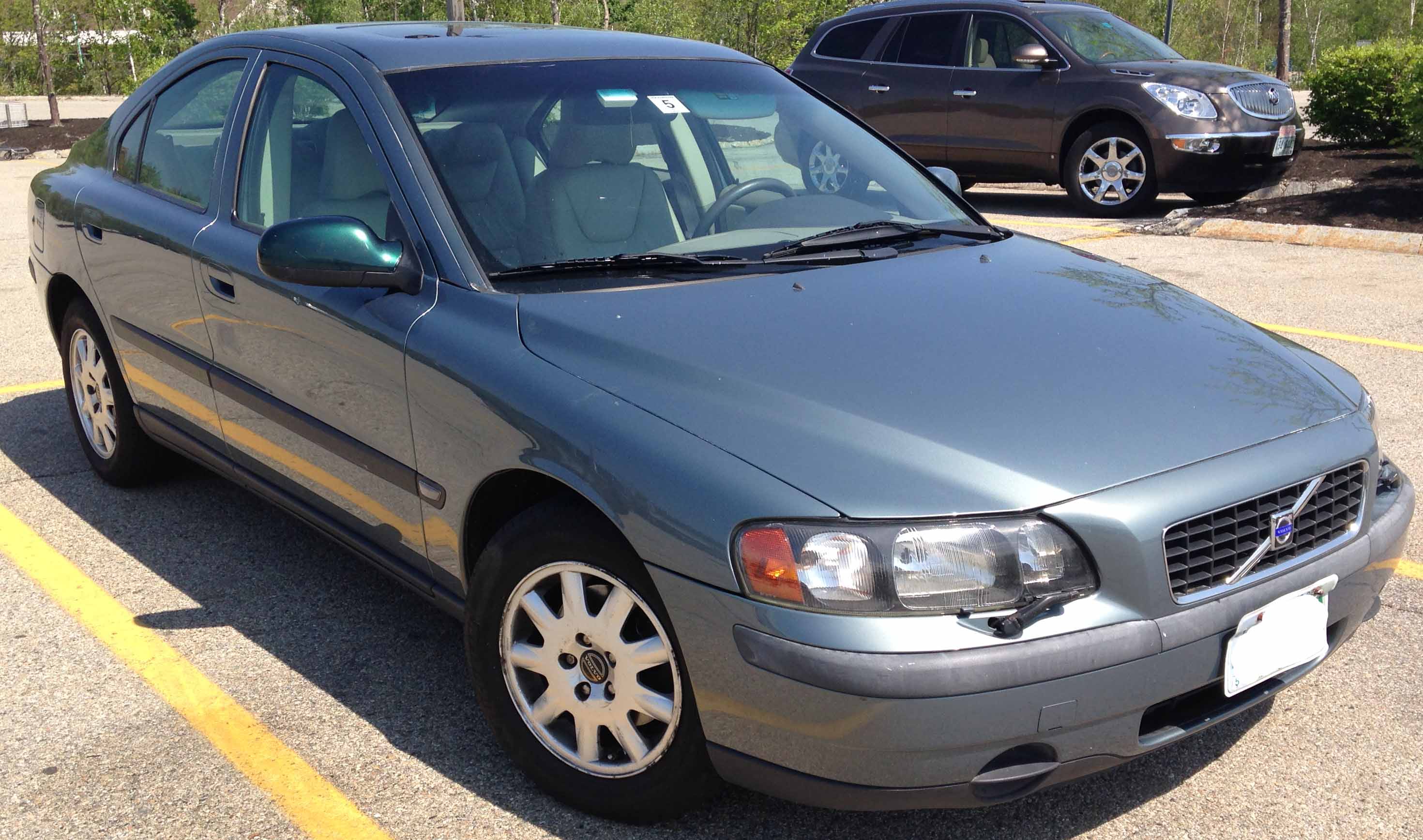

Well, I decided to keep it for now. Below is a photo I took of the car:
Notice this the rare special edition with the passenger's side mirror a different shade of green from the rest of the car!
So my plan is to mainly keep it stored in the driveway except for occasional use on weekends. I plan to get a car cover to keep it clean from pollen, tree sap, etc. Does anyone have any recommendations where I could get a cover for this car?
