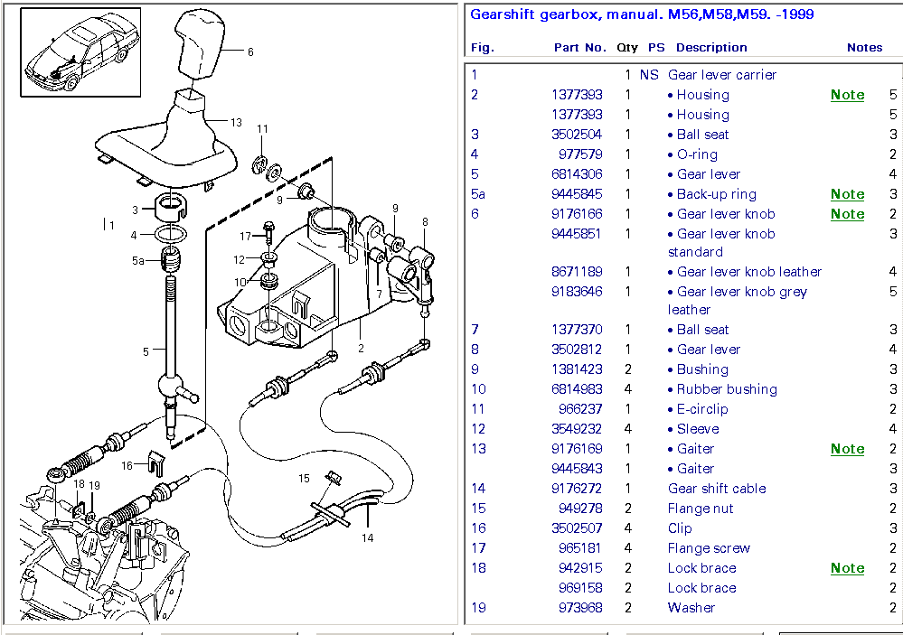

Hi ES,
Does it look anything like this:

Nope. That's for a stick. I'm working on an automatic transmission.

Hi,
Ok, couldnt find anything for an automatic, sorry.
