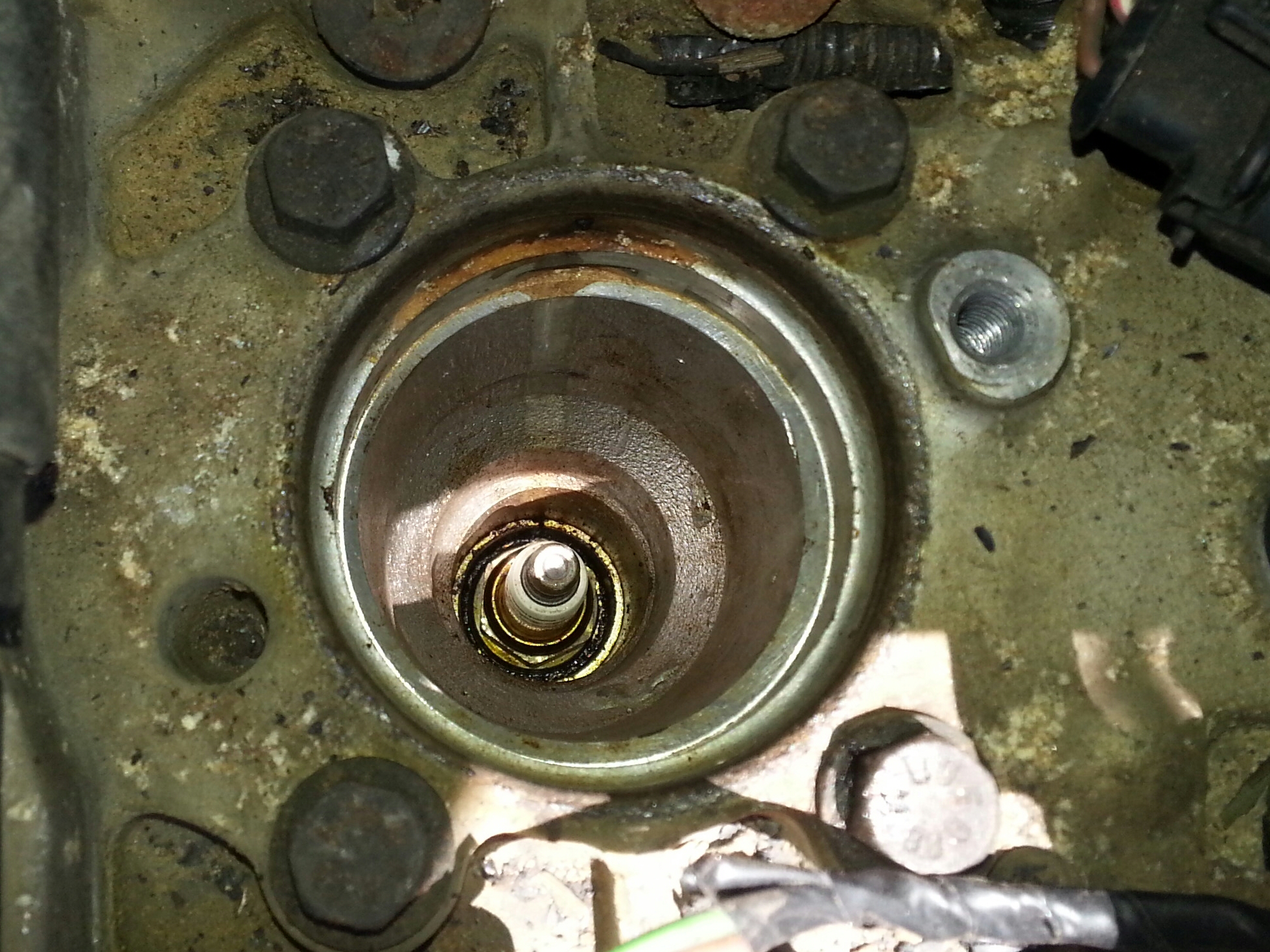

draser
Posts: 790
Joined: 18 Aug 2011, 10:49
Year and Model: 2005 S60 2.5T
Location: Detroit MI
Been thanked: 2 times
Post by draser »
Can you remove plug and see if side electrode is bent to touch center, post a pic also?
2005 Volvo S60 2.5T, Zimmerman/Akebono brakes
2012 Honda Accord, EBC slotted rotors
rmargoli
Posts: 17
Joined: 12 Jul 2015, 08:28
Year and Model: 2001 S60 T5
Location: Israel
Post by rmargoli »
Never removed a plug, allways a first time...

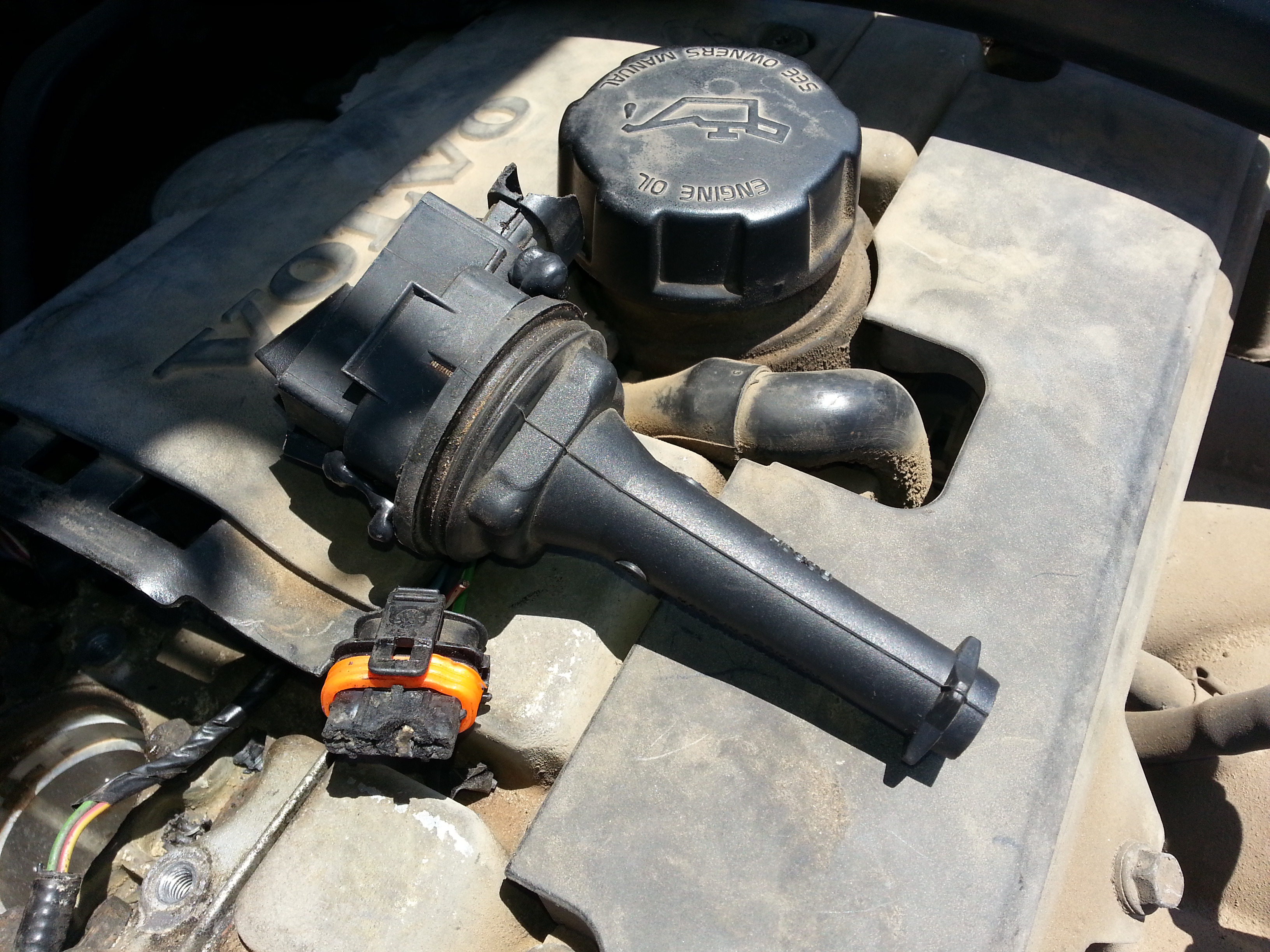

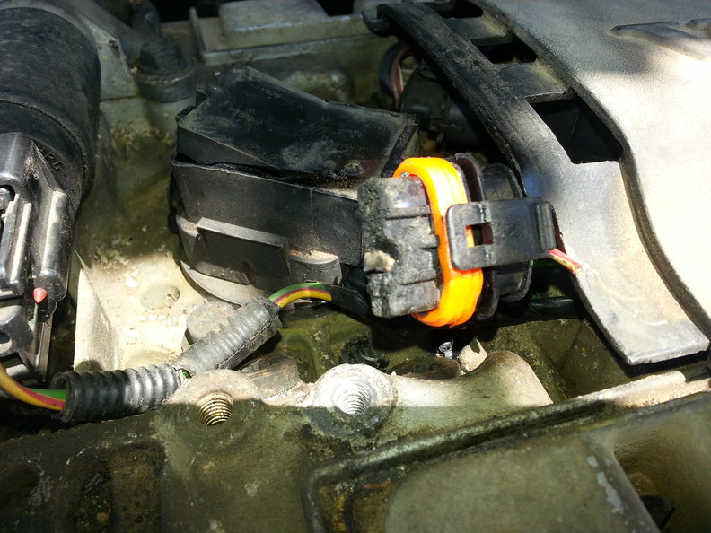

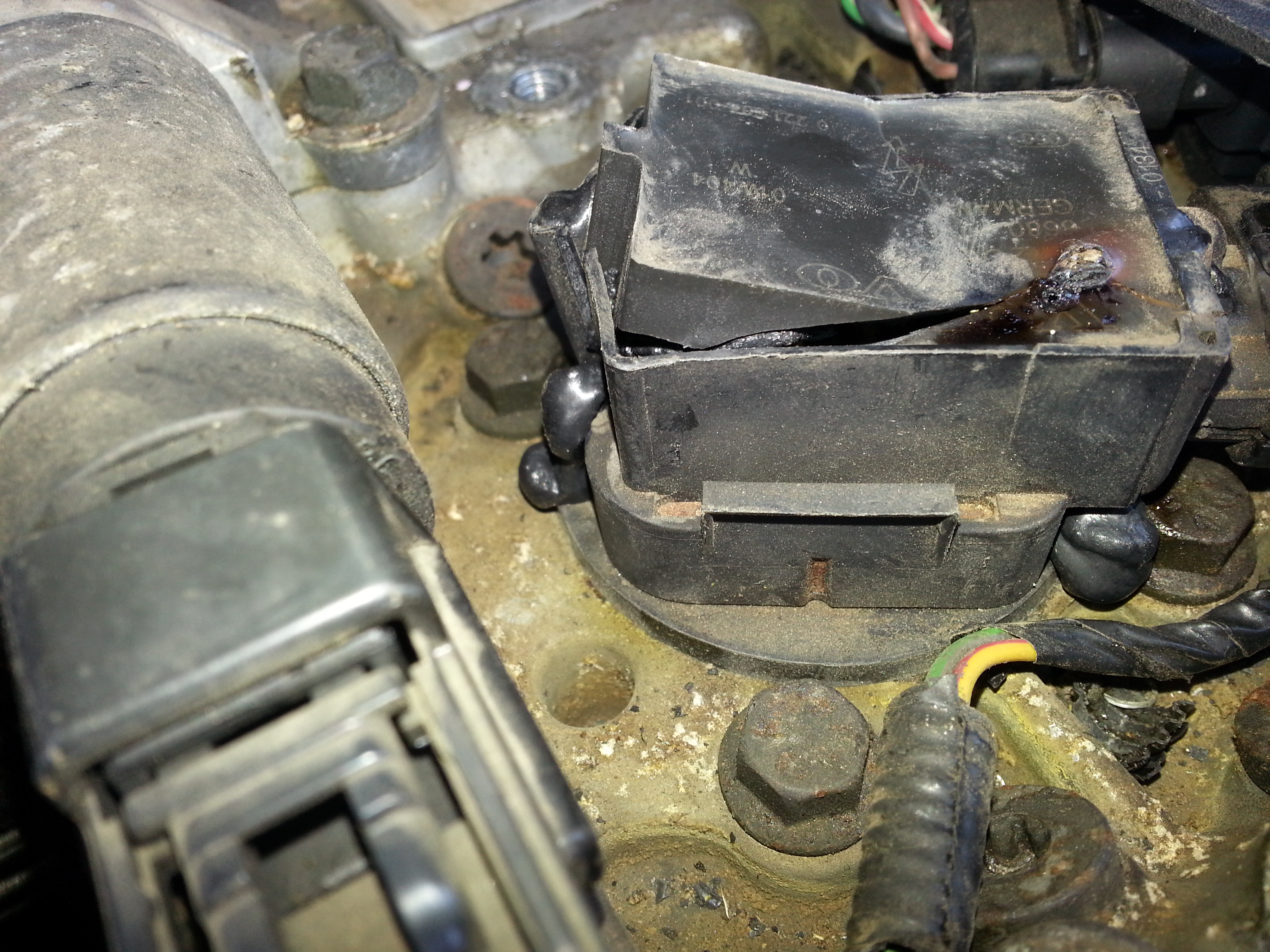

rmargoli
Posts: 17
Location: Israel
Post by rmargoli »
rmargoli
Posts: 17
Location: Israel
Post by rmargoli »
As you can see, the burning of the coil is top down, even the connector has been burned and one of its legs even changed its form when i extracted it out of its coil housing
Posts: 36149
Joined: 17 Feb 2013, 17:54
Has thanked: 1610 times
Been thanked: 4065 times

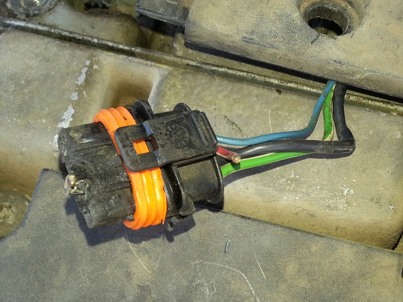

It looks like the red white wire is clipped. What's going on there?
I agree that is a top down meltdown.
rmargoli
Posts: 17
Location: Israel
Post by rmargoli »
Hi
I do not know the reason for which the red/white wire is clipped, i would guess it came that way when the harness was replaced as that wire is not going forward on the harness itself
Is that an issue? how many wires should there be to each of the coils?
I need to check with the electrition who replaced the harness
Posts: 36149
I think there are three to the coil, so it's very likely that the problem is one of the wires is misconnected. I'll guess the 12vDC is going to the trigger transformer ground.
My 1999 colored wires are different but that may be a model year change.
I think we are close to the solution.,,,Behatsclacha!!
