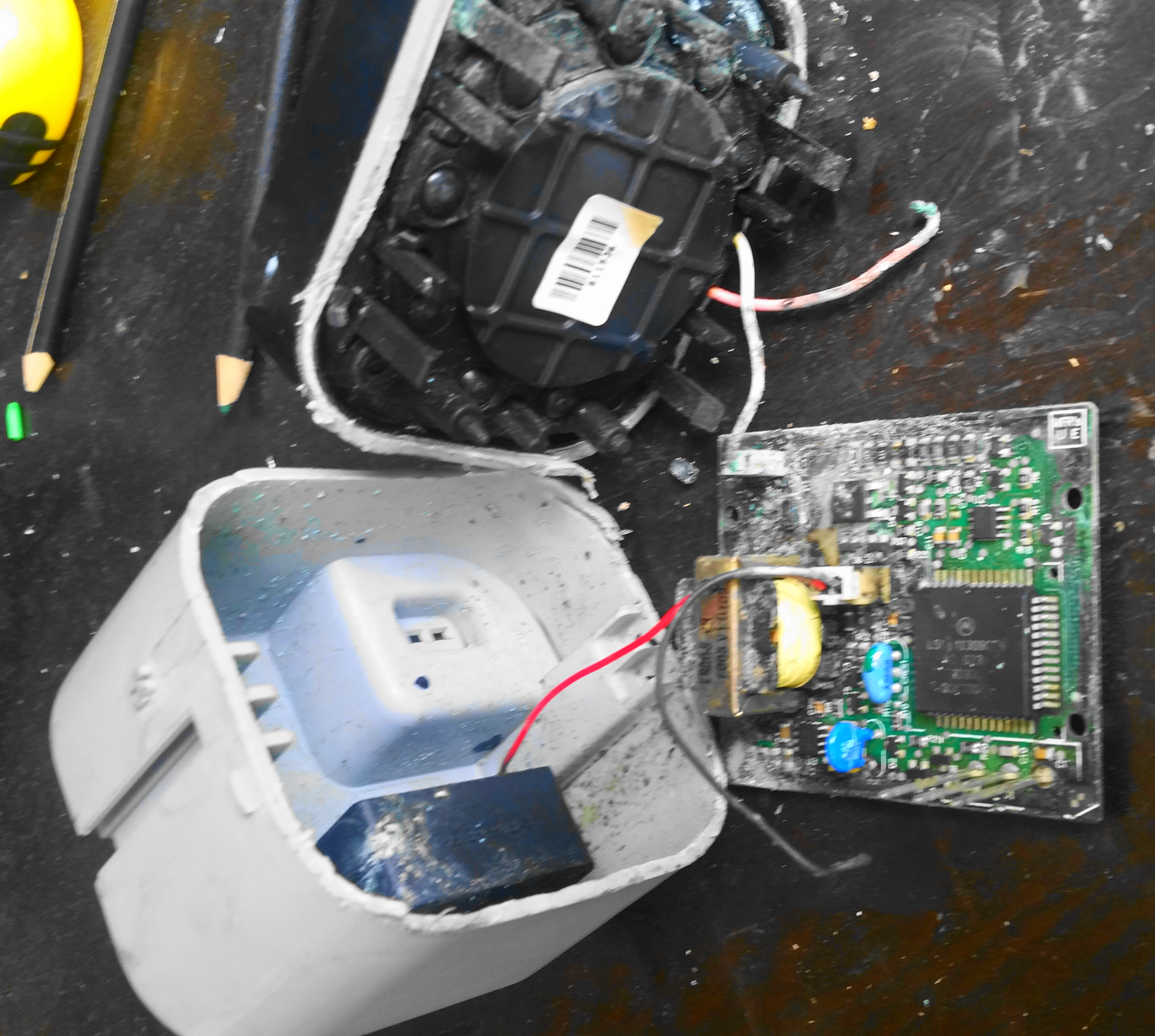

I found out once the plug popped out on its own after siren repair on wife's V70. Anyway, at this age the siren might have a bad battery. You can run the car with the siren unplugged, if you don't mind "Alarm service" messages. It does not affect immobilizer.

Cracked open the immobilizer and full of brownish fluid--batteries are shot and circuit board is totally destroyed. Going to leave it unplugged.

My immobilizer board is garbage so I took it out (it had been unhooked anyway) and everything is running swimmingly. Also serious props for the bumper/headlight access advice! Thank you precopster and vtl!

Alarm siren is not an immobilizer. It is just a loud battery-backed buzzer. Immobilizer's function in this car is spread across several computers.

Now that's a busted siren module. You will keep having that Alarm message but it goes off after a few minuted driving.
