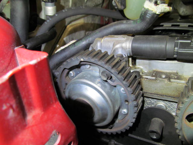

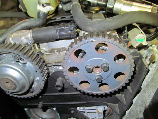

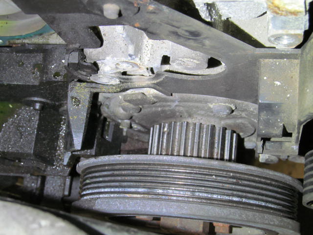

Snap a picture of your engine and the timing belt area and post them back. The two radiator part has me perplexed since a N/A car doesn't have an intercooler but the turbo does. I want to be absolutely certain what we are dealing with here.
If the car is a turbo and if the front cam seals are leaking this just became a much bigger deal and you really can't properly do it without the cam adjustment tool to set the back of the cams at their zero point. If the car is a turbo with CVVT the hub is not keyed and it needs to be removed to change the seal. Since it isn't keyed the cam needs to be zeroed (actually it needs to be one tooth off) before the hub can be torqued back down. The required torque is pretty big, around 90 ft lbs as I recall.
If the car is a N/A without CVVT the sprockets are easy to remove and you just take off the three small bolts that hold the sprocket on and remove them. You can just hold the sprocket with your hand to remove the small bolts. I normally loosen them with the belt on since it is a bit easier to hold the sprocket with it on but either way it isn't a big deal.
When you put the sprocket back on you will note that the holes in the sprocket are slotted. Just set them back to the middle of their travel in the slots. I leave doing the final torque setting until after the belt is back on since you can be a bit more precise with the torque wrench. It is also reassuring that, if the cams do move, everything moves together and the timing is maintained.
Just use the "Upload Attachment" tab below the reply window to post the pictures.
...Lee

took pictures but i don't see the upload attachments anywhere yet. found them did they show up?
the seals still look good so that dog is going to lie for now. thanks

I can't see a turbo; it looks like you've got the VVT on exhaust cam only
