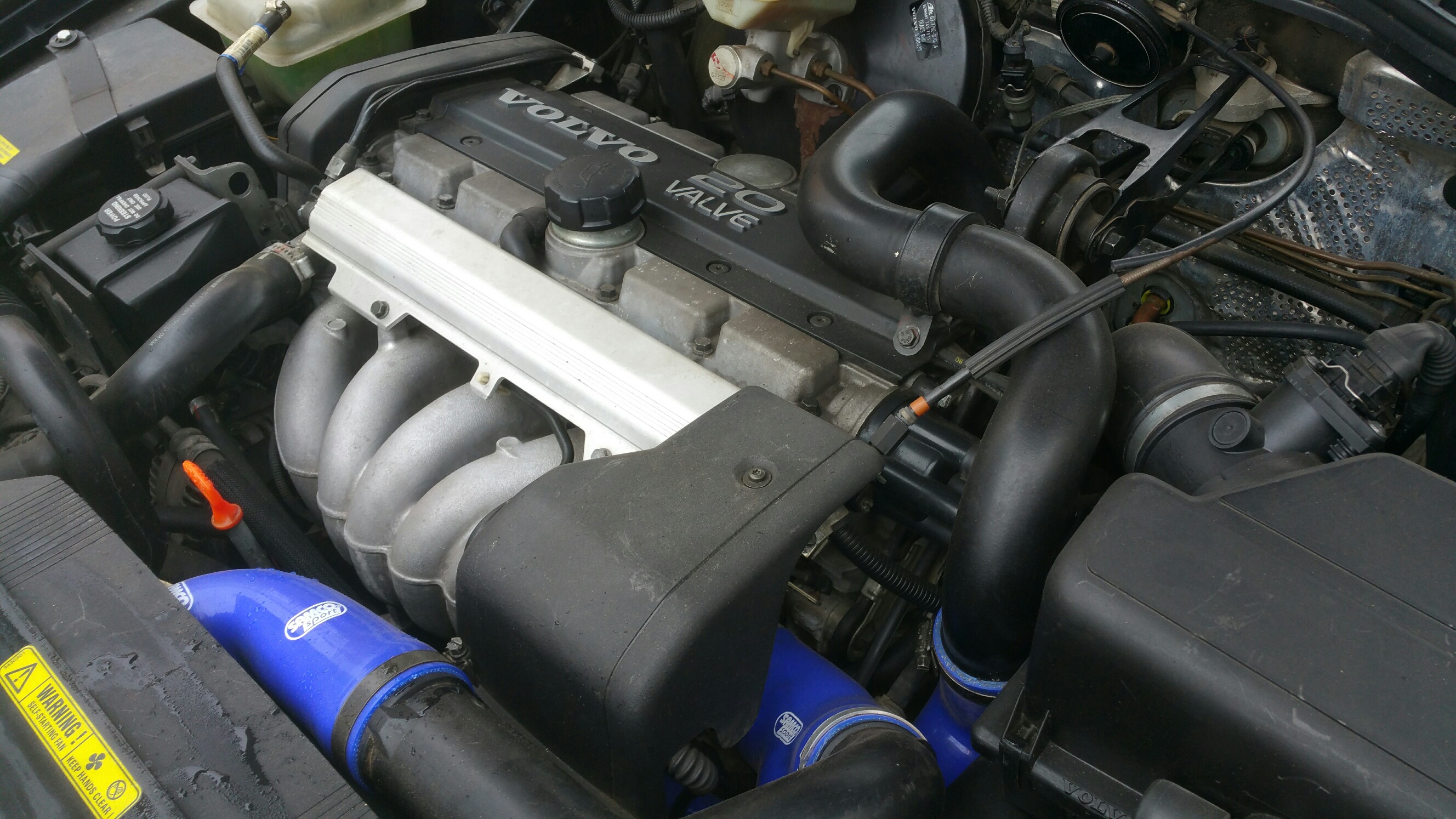

Since May 2014. Had to cut one of the smaller hose shorter, all other 3 hoses fit great.RussB wrote:tryingbe wrote:I had good luck with MOFE. If you don't want the samco logo, you'll have to ask them not to put it on. You can only use 4 hoses out the set, the rest is useless. I think they also do custom color, you'll have to ask them.
That is quite cheap. How long have you been running them? Any fitment issues?

Ooooh, looks like there's an EVAP L hose there...I had good luck with MOFE. If you don't want the samco logo, you'll have to ask them not to put it on. You can only use 4 hoses out the set, the rest is useless. I think they also do custom color, you'll have to ask them.
Black
http://www.aliexpress.com/item/Original ... eb201560_3
