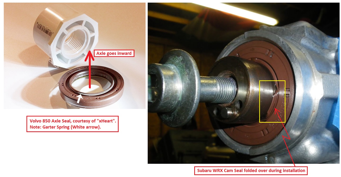

To illustrate the concept of "seal lip folding over", I borrow some random photos from the web. In terms of relative movement between seal vs shaft, these 2 photos illustrate the opposite phenomena:
- To the LEFT is Volvo 850 Axle Seal, courtesy of "xHeart". During Axle insertion, the Axle pushes the lip inward (toward the Garter Spring), so there is no way for the lip to fold over.
- To the RIGHT is a Subaru WRX Cam Seal (random photo from the web). Now the Cam shaft is fixed (stationary), the Cam Seal is pushed inward. So the lip has a tendency to be pulled away from the Garter Spring.
This was exactly what happened to my 1998 S70 Exhaust Cam seal installation a few years ago, mainly b/c of limited visibility and it was my first time dealing with it. The folded seal leaked like a sieve, glad I caught it before the engine ran dry!
Subsequently, I learned to install it slowly and used my finger to run around the inner lip as I install it. Of course, you need to oil the lip beforehand.
You can see more about this seal lip folding over in the Subaru forum:
http://forums.nasioc.com/forums/showthr ... ?t=2088820
Hope this helps clarify the issue of lip folding over:
