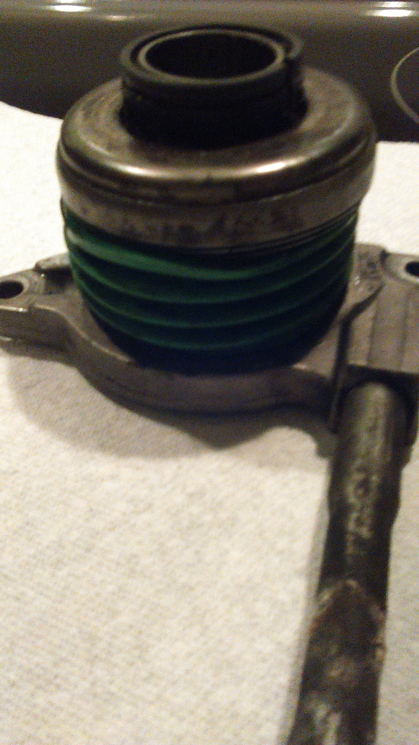

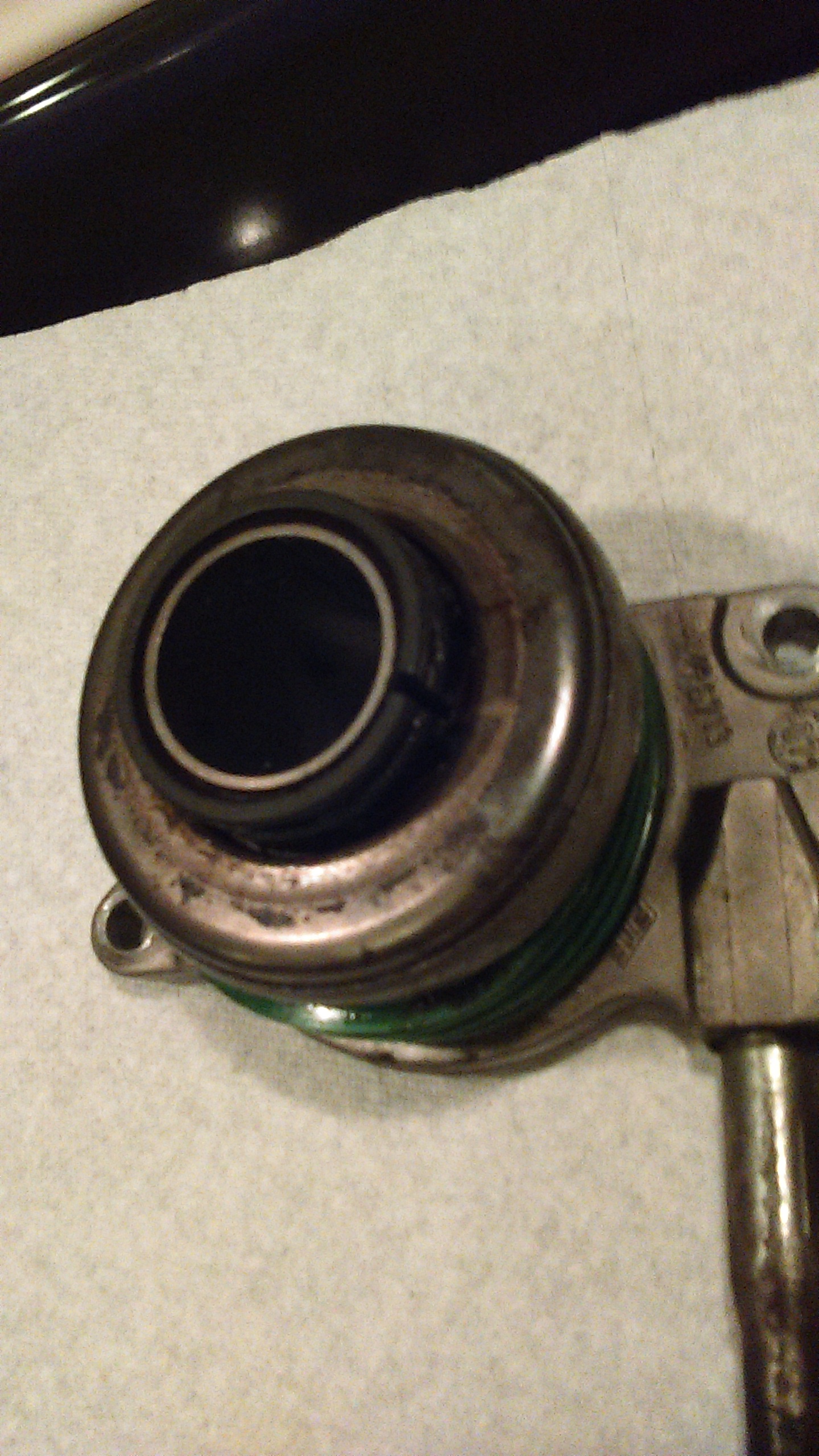

So the clutch slave cylinder replacement is underway. A mechanic is doing it, not me. Just for kicks after the failure I emailed customer service at ZF (Sachs parent) and asked whether failure at 60K miles was considered a normal service life. The response was no. When I asked what might cause such a premature failure, without seeing the part, the response was contaminated hydraulic fluid. Well, I got the part back and the plastic collar that surrounds the bushing that fits over the input shaft was cracked in half. Looks like low quality plastic used in a high stress environment. I snapped a couple cell phone pictures and asked Steve to post. We'll see if he can manage it.
I also saw the bell housing out of the car and it appears to have the circular bracket into which an external slave cylinder could be fitted so, if I had been doing the work myself, I could have investigated converting back to an external slave. Oh well, I'll know for next time. . .

Bump for added pictures...
