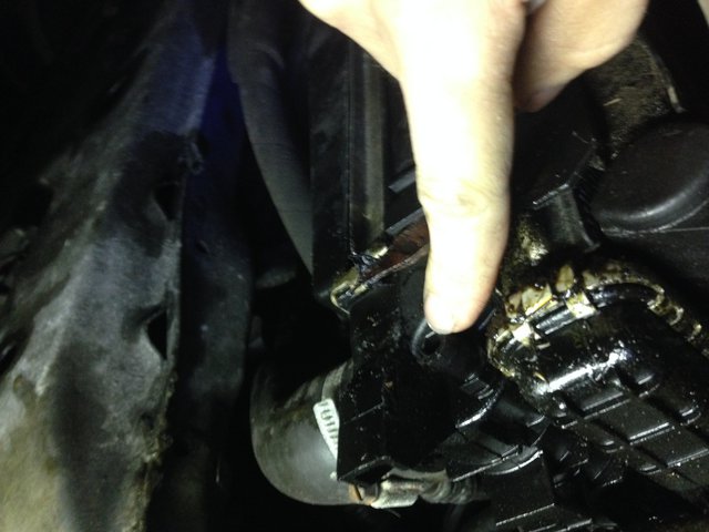

The heater core hoses are nowhere near the fuel rail though when a leak occurs it can spray in almost any direction.
If it happens to be the "J" shaped hose near the rear banjo bolt it can be duplicated. I insert a spring into good 3/8 water hose to prevent kinking and re-create the bend.
Looks like it's the hose you were wrestling with; too much flexing of an already aged hose!!

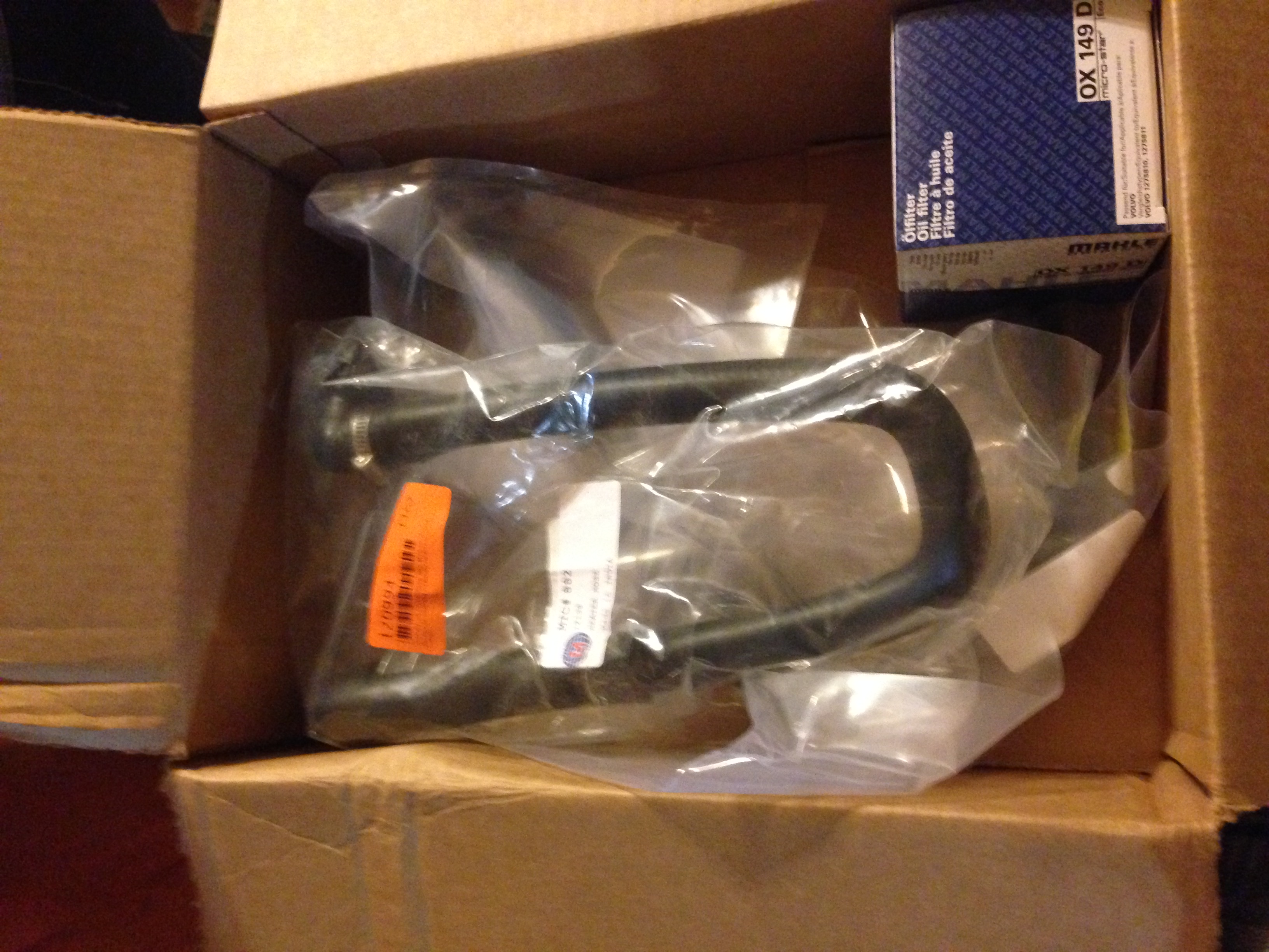

Fixed so far! Here's what I did, since info on this engine is hard to come by...

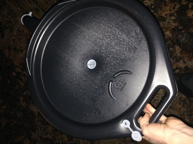

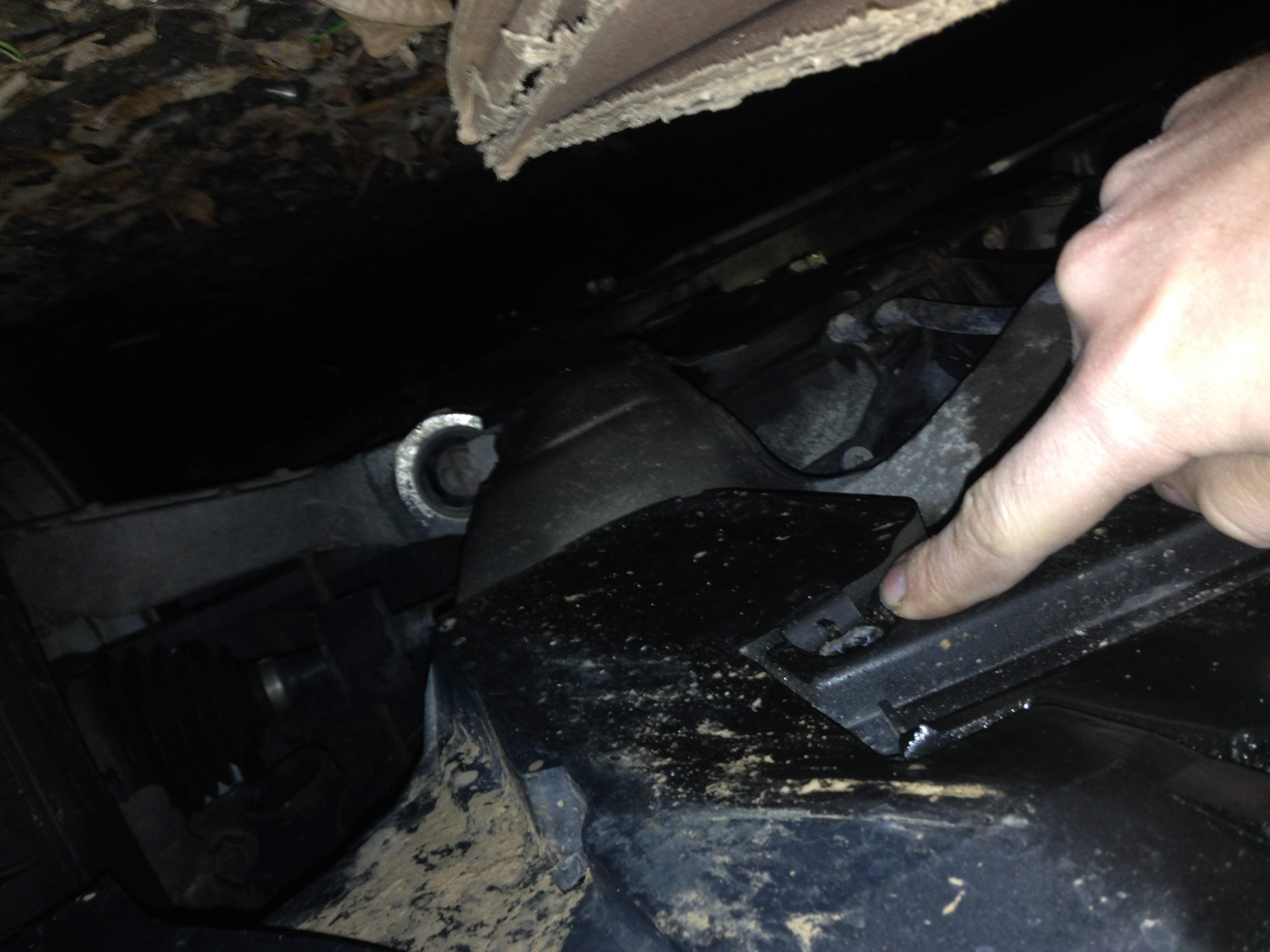

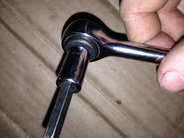

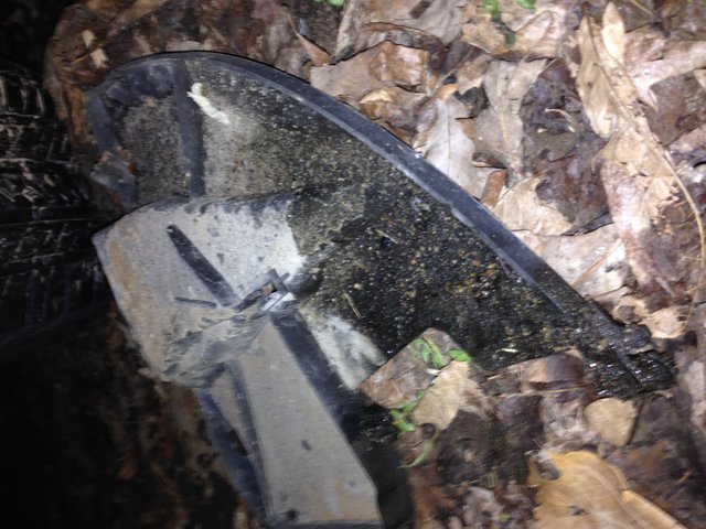

1. Get a container for draining coolant into and your parts. 2. Remove the 2 T25 screws on each side of the vehicle holding the side wings of the undercarriage bezel on. 3. Pull the friction clamp down from the wheel well and Slide them rearward and out. Look up into the underside, near the radiator on the drivers side and you'll see a 10mm bolt holding one side of the rest of the panel on, the other side is in the same mirrored location. Work the panel out being careful not to disturb the fog lights. 4. Place your coolant bin under the draincock, I found it easier to loosen it with a 6mm hex wrench. Drain coolant. 5. Release the 7mm hose clamp on the lower radiator tube to drain its contents into the drain pan.
(refer to "Draincock " picture)

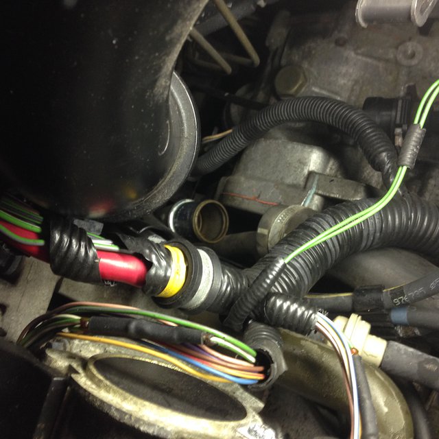

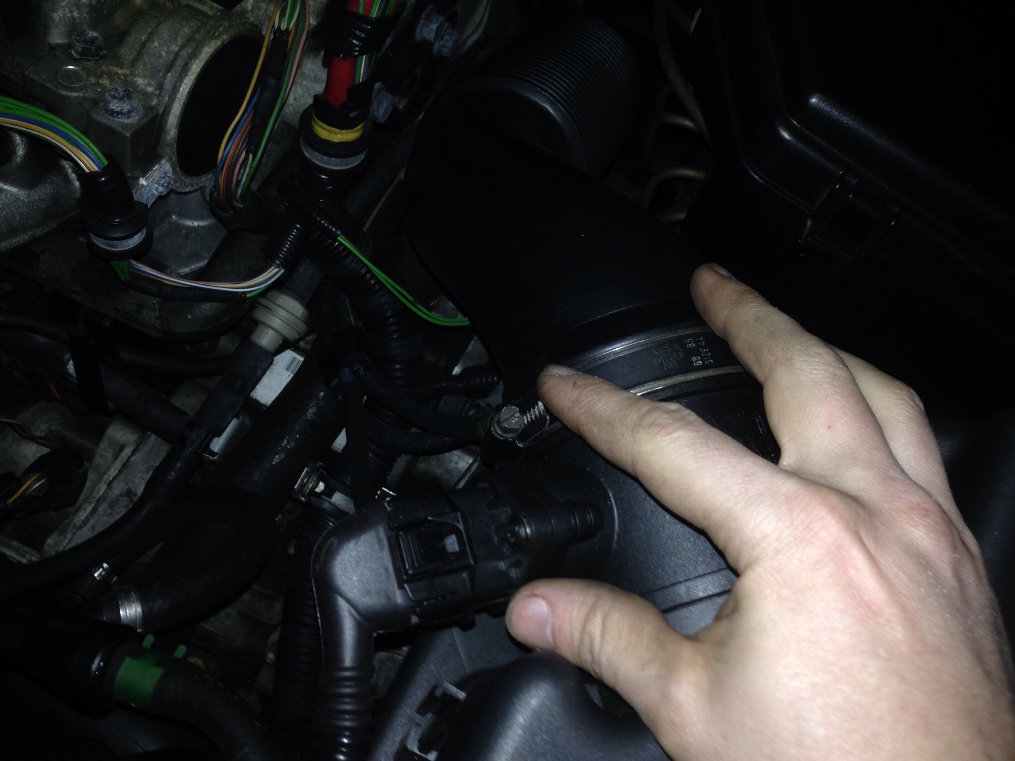

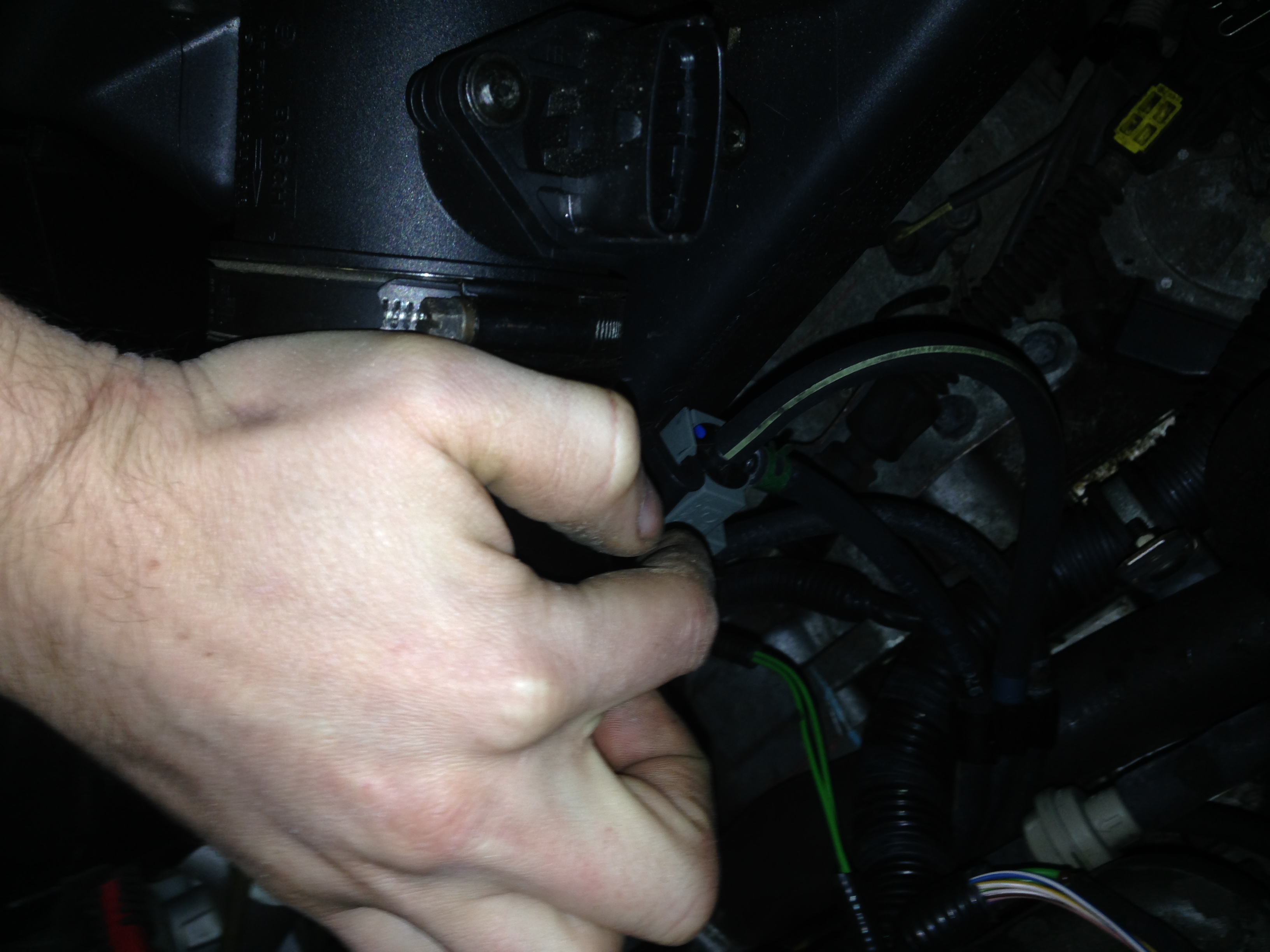

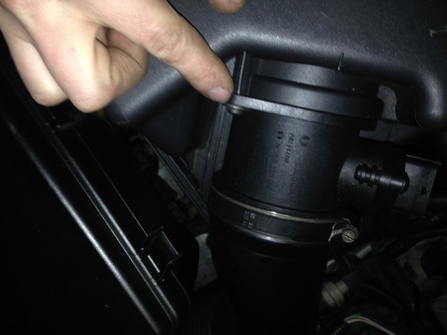

6. Go topside and disconnect the sensor on the air tube to the turbo. Unscrew the air tube to the turbo (2 T25s). 7. Disconnect the sensor from the bundle of air hoses attached to the air filter housing, then unhook the bundle from it. Now you can tuck those out of the way. 8. I chose to use a coat hanger to hold the turbo tube up by tethering it to the hood (which can be kept from pulling down with a block of wood if you'd like).

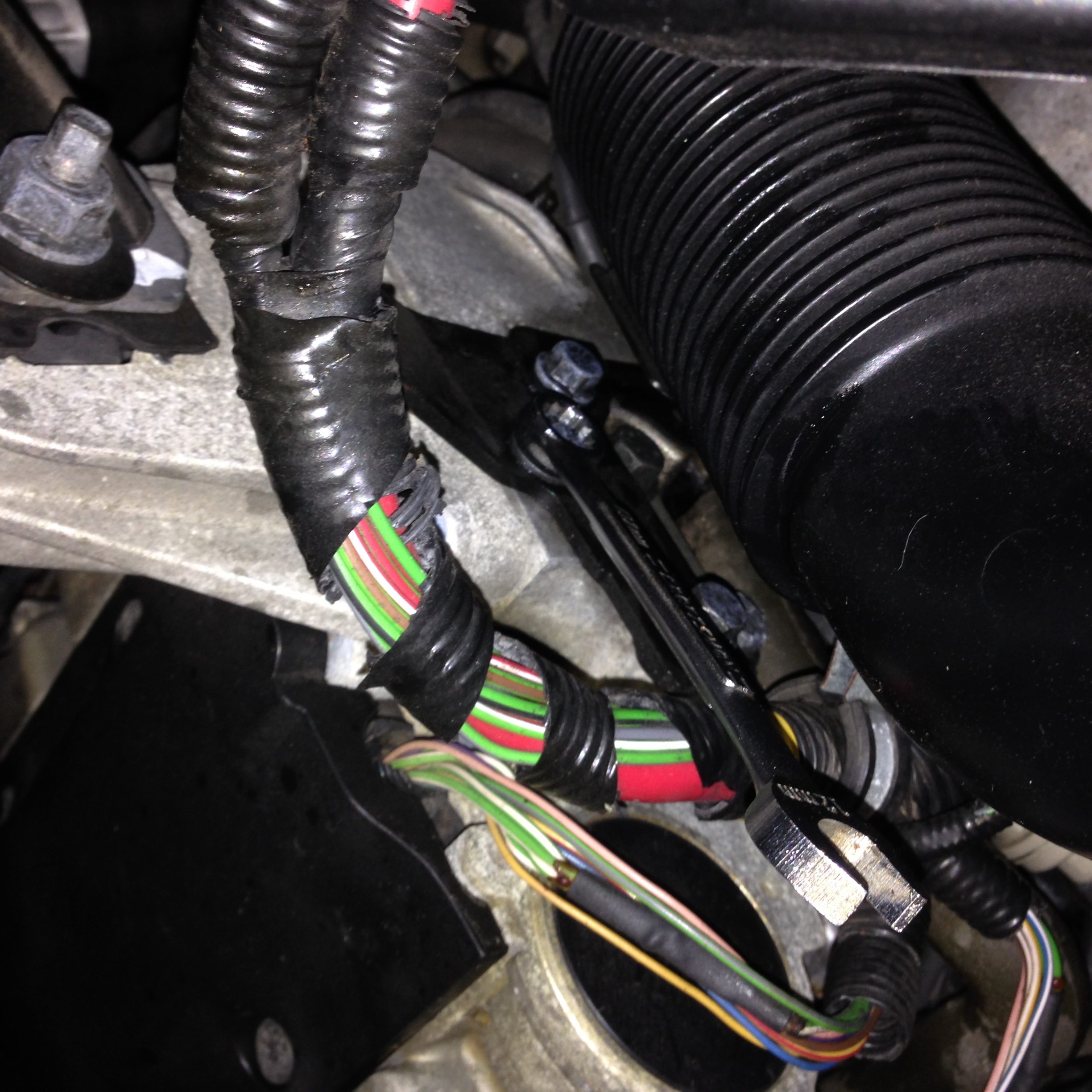

9. Now unclamp the 7mm lower radiator hose clamp to pull that hose out of the way. 10. Now loosen the 3 12mm bolts for the black hose holder. One holds a wire clamp. It's finicky to get out. Now there should be reasonable room for smaller hands to get in around that lower radiator hose nipple.
I used a 1/4" drive with extensions to get to the heater hose clamps. The first one I got from the front side. Difficult. The second one I ended up getting from the firewall side, since the clamp was pointed completely in a ridiculous direction. Even more difficult!

Now, snake the replacements in in reverse of how they came out. Not to easy, but once in place, attach and clamp on the engine side, then attach the firewall side. (I oriented my clamps in a way that a human can actually access them).
Push the firewall side of the new hoses onto their respective nipples (yep...)
And, as they say, installation is reverse of removal
. Replace the coolant that was lost with either the drained coolant, if clean, which mine was, or with new... Check level over the next few days, or just let the level sensor tell you it's low and add accordingly.
