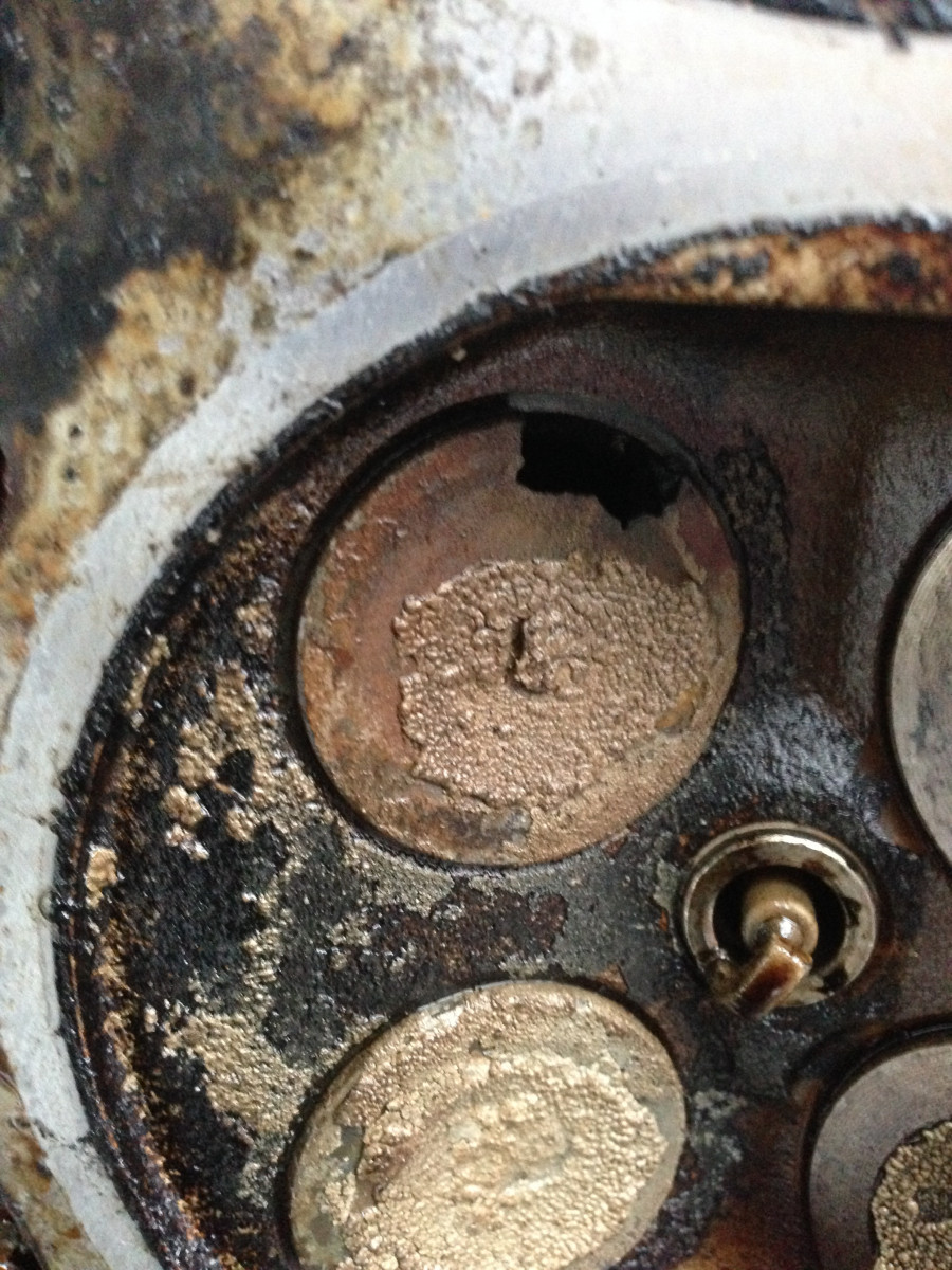

Picture of my burnt and pied #3 exhaust valve on my T5 at 260k. Root cause, badly worn stem seals
Recommend against 15F fir this job.

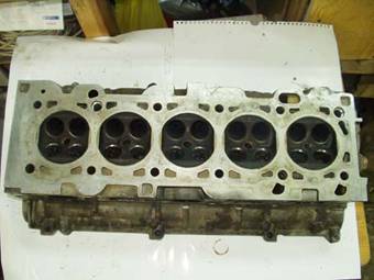

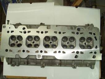

Wrong. Combustion chambers in NA and turbo heads are different.
- NA.jpg (14.07 KiB) Viewed 753 times
- T.jpg (15.36 KiB) Viewed 753 times
If my English is bad, please correct me
- Posts: 36154
- Been thanked: 4071 times
Those are indeed different.
