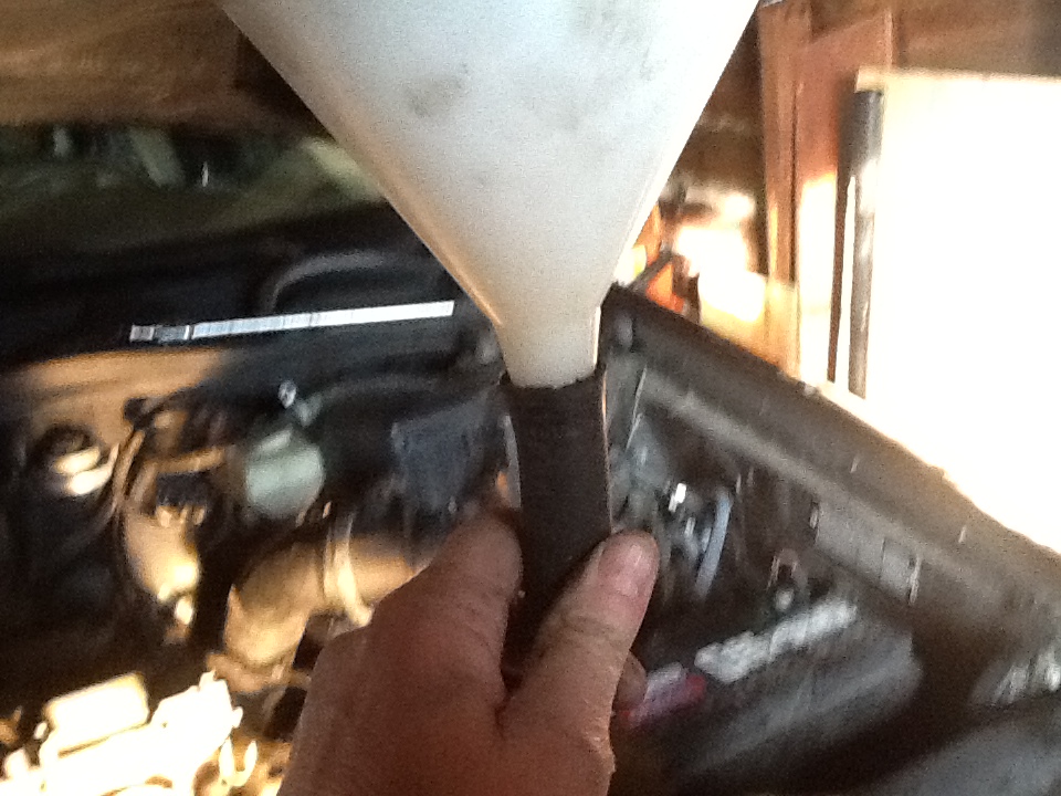

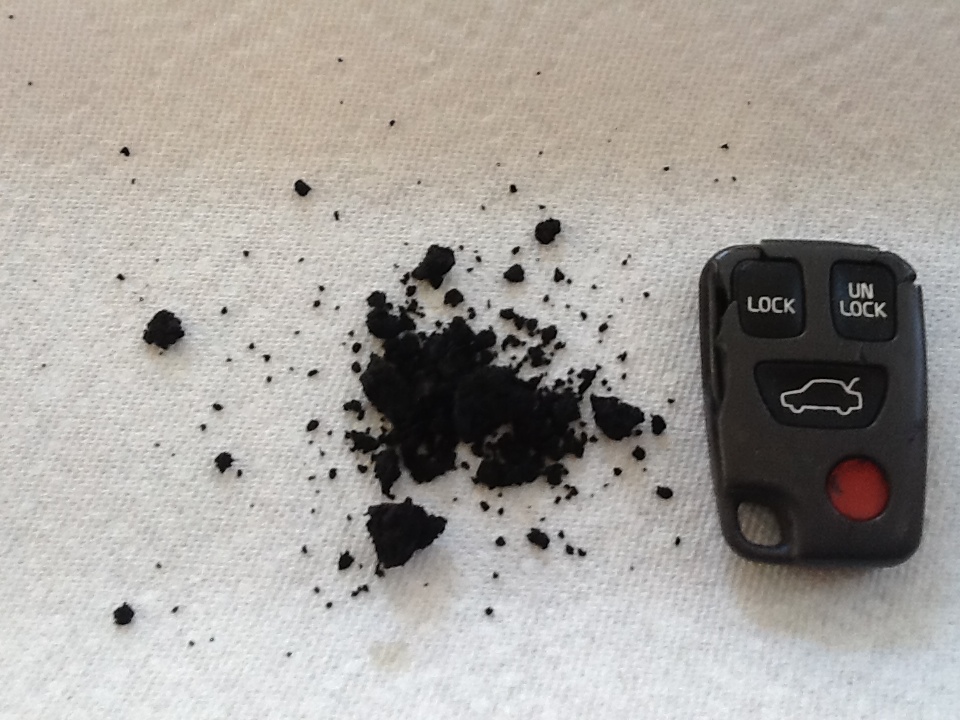

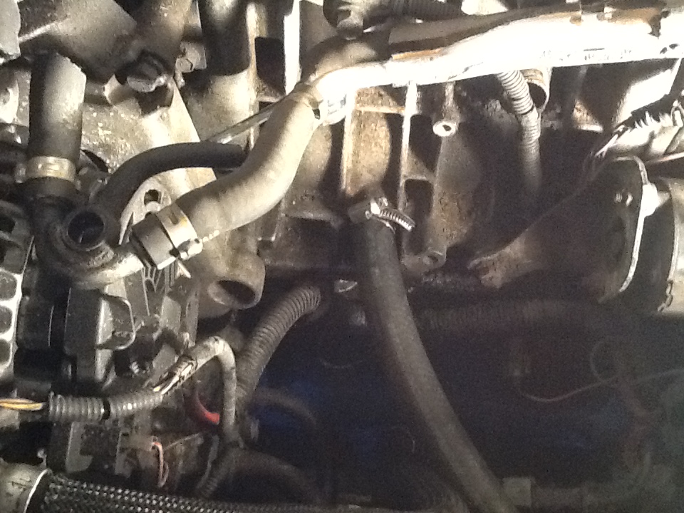

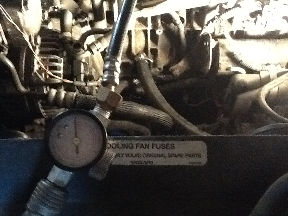

The last one I did was on my Nephew's 2000 V70XC. His sump was clogged with a wonderful asphalt hard sludge. I took a hose and clamped it to the port and poured in Sea Foam overnight to loosen debris. I then took compressed air and blew out the clog. Further cleaned out the sump with a thick tie wrap. I was then able to blow bubble into the oil pan.
