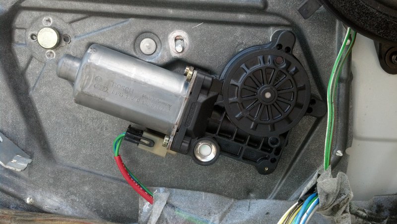

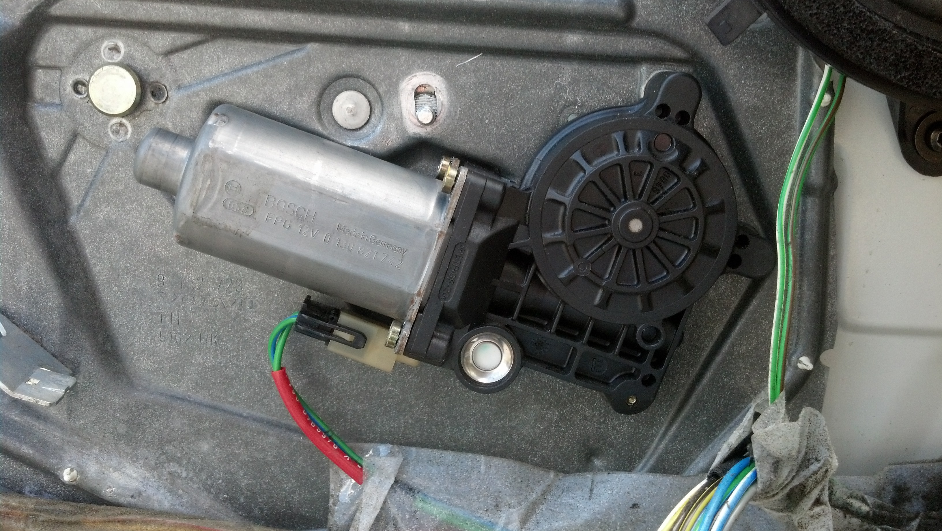

I've got the door apart, but I don't see anything that looks like a sticker covering the manual override on the gearcase. Here's a picture. Am I missing something?Ozark Lee wrote:You can crank it back up mechanically but you need to remove the interior door panel to do so. We have several writeups and I think Robert has a video on how to remove the panel and what to expect as far as broken clips, mounts, and panel delamination that will rear its ugly head in the process.juggles wrote:None of this seems to be working. I've ordered a new switch but I still think the problem may be elsewhere. In the meantime, is there any way to mechanically crank or pull the window back into place?
Once the panel is removed, so long as the window is still on its tracks, you can peel back the sticker that covers the the manual override on the motor. As I recall it is a torx head and it is fairly large, like a T45 and it is centered on the gearcase next to the electric motor. It doesn't take a great deal of force but using a ratchet is the easiest way to do it. I was tempted to use a battery drill but I didn't want to risk shelling out the gearcase so I did mine with just a ratchet and was careful not to go too hard in the wrong direction.
...Lee
Also, got a replacement switch this morning. The driver's side motor has worked a little in fits and starts, not enough to get the window all the way up. Smoke was coming off the motor earlier.

I steered you a bit wrong on the location. The silver circular grommet just inboard of the motor is where the manual actuator is. There is a sticker over the hole but you can just punch through it.

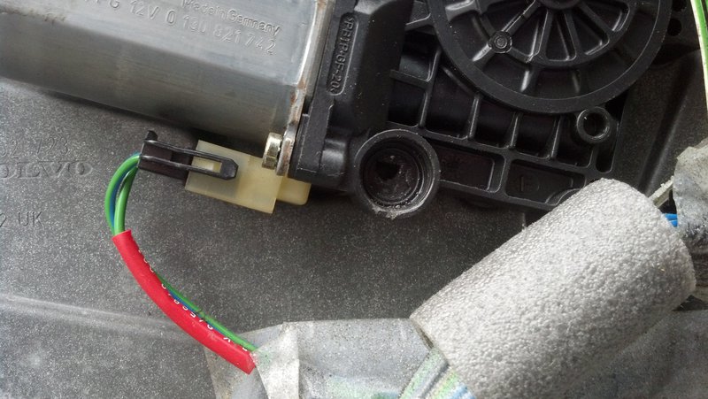

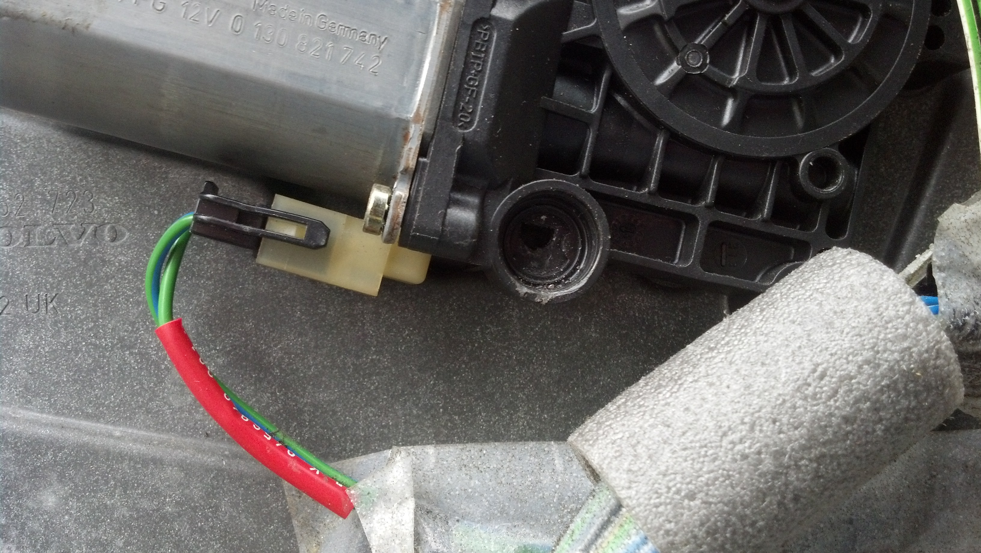

OK, punched through the sticker, removed the grommet also. Here's what I found. Is there a tool that fits in that semi-circular hole?Ozark Lee wrote:I steered you a bit wrong on the location. The silver circular grommet just inboard of the motor is where the manual actuator is. There is a sticker over the hole but you can just punch through it.
...Lee
Ozark Lee
- Posts: 14798
- Joined: 07 Sep 2006, 08:24
- Year and Model: Many Volvos
- Location: USA Midwest
- Been thanked: 76 times
Hmm, mine had a torx socket in it. Try a screwdriver I guess.
