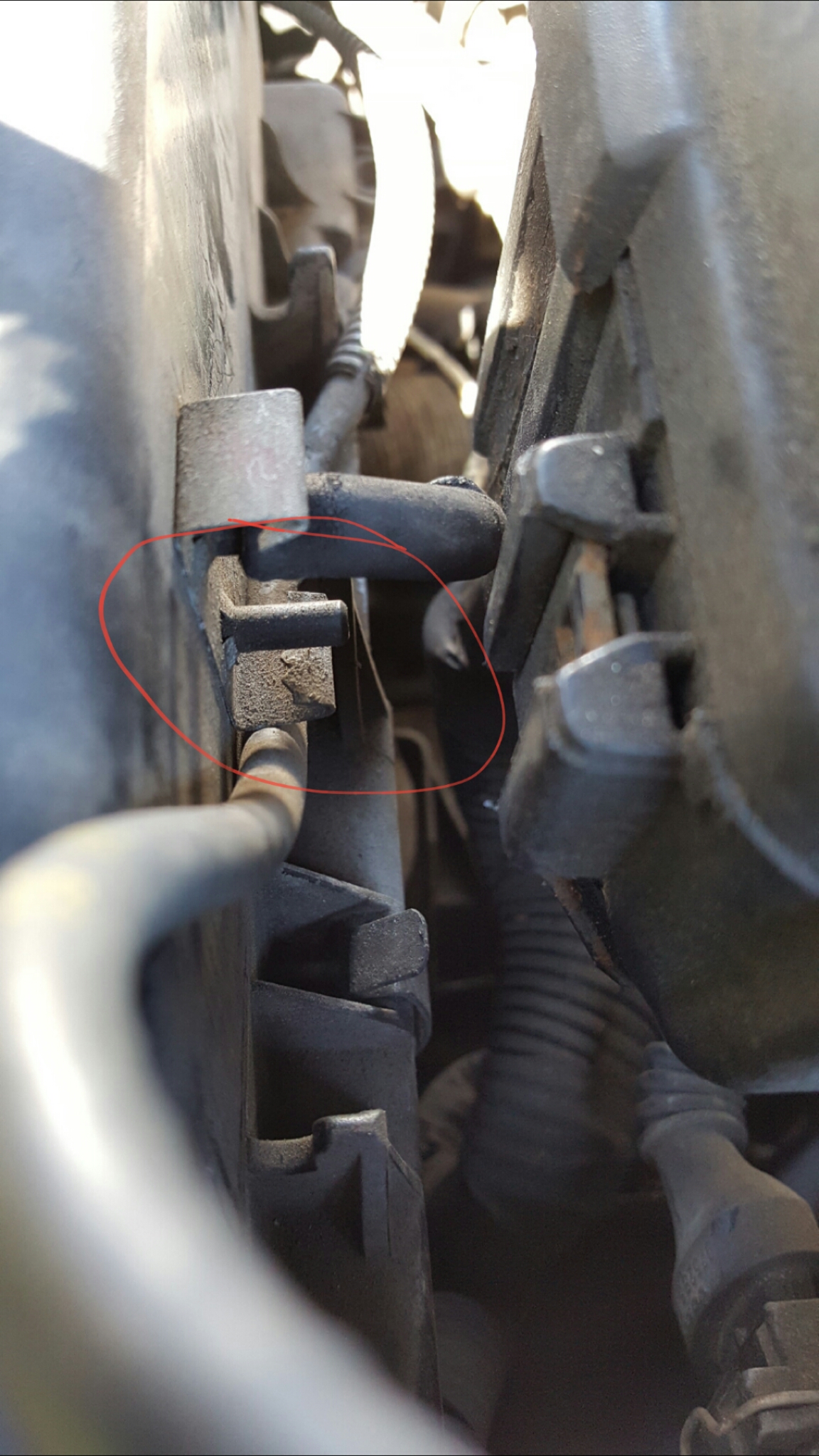

I also noticed for the first time (not sure how I missed this before) that the bottom one of the two vacuum nipples on the back of the air cleaner box has no line hooked to it. After researching on here a little bit I'm still not sure where that line goes, but my understanding is it has to do with an air box thermostat andprobably isn't really part of my problems except for perhaps contributing to my poor gas mileage. Am I getting that right?

To figure out all of the vacuum lines: check the sticker under the hood and https://www.matthewsvolvosite.com/forums ... hp?t=65002
