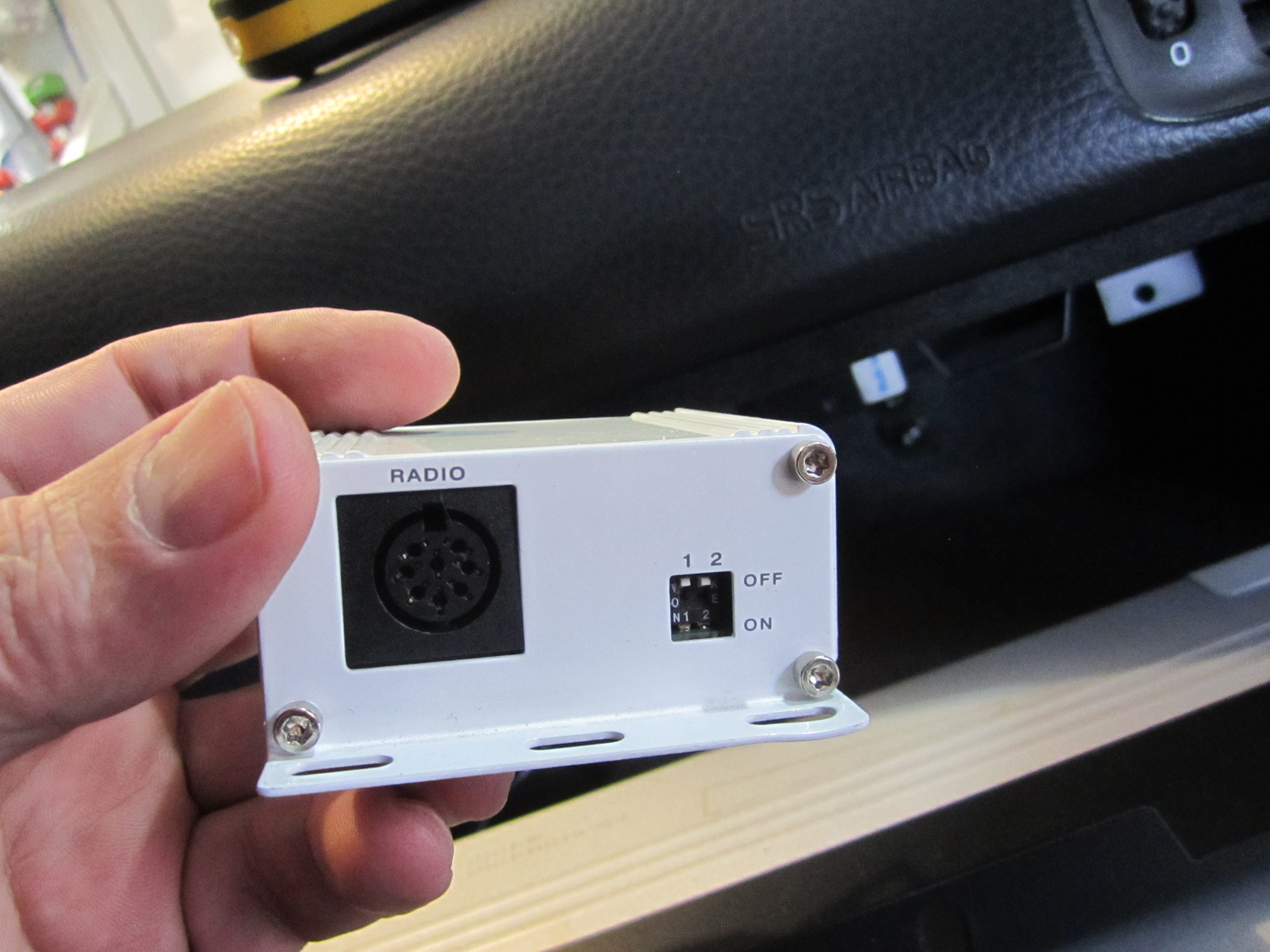

Below are a few more pictures showing more of my cars set up:
1) USA Spec PA11-HON unit wiring plug in for cable to rear of radio. What positions should the 2 jumpers be set to #1 - On or OFF, #2 - ON or OFF?
