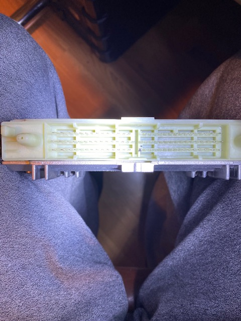

Here is the pic from the SAS delete we did on the wife's car, before swapping to a flashable ECU.

Huh, that is my exact problem. My '30' is on the opposite side of the gap than yours. Your fix looks the same as the RobertDIY video but my numbers (on the other side) are on the left side of the pic ... ?
Not sure what to think

so looking from the other side, the numbers are hard to see, so I used a trouble light and a magnifying glass and it looks like ;
*tried to make a chart but won't take
Far Left
43
29
14
Middle Left (top 2 rows)
30(?)
15
Middle Right (Bottom row)
30
Far Right
14
29
43
Far Left
43
29
14
30(?)
15
30
Far Right
14
29
43

There is a "A" side and a "B" side.
On the "A" side, the "30's" are on the top. On the "B" side, they're on the bottom.
Install your diode like I did in the pic. That is correct, A32 to A37.

I have found the difference
My Volvo was made in Brussels. Not sure if that in and of itself makes a big difference but my ECU is a P/N is 261 204 607. And it looks the same as Chuck W's ECU. The one that RobertDIY had in the video was a P/N 261 203 072. So the numbering showed up on both the outside and the inside of the ECU. That being said, it looks to me (based on the Chuck W image above) that both of these ECUs are 'wired' the same. Apparently there were quite a few variations of the same ECU so will solder away tomorrow and see what codes it gives me. Hopefully none.
