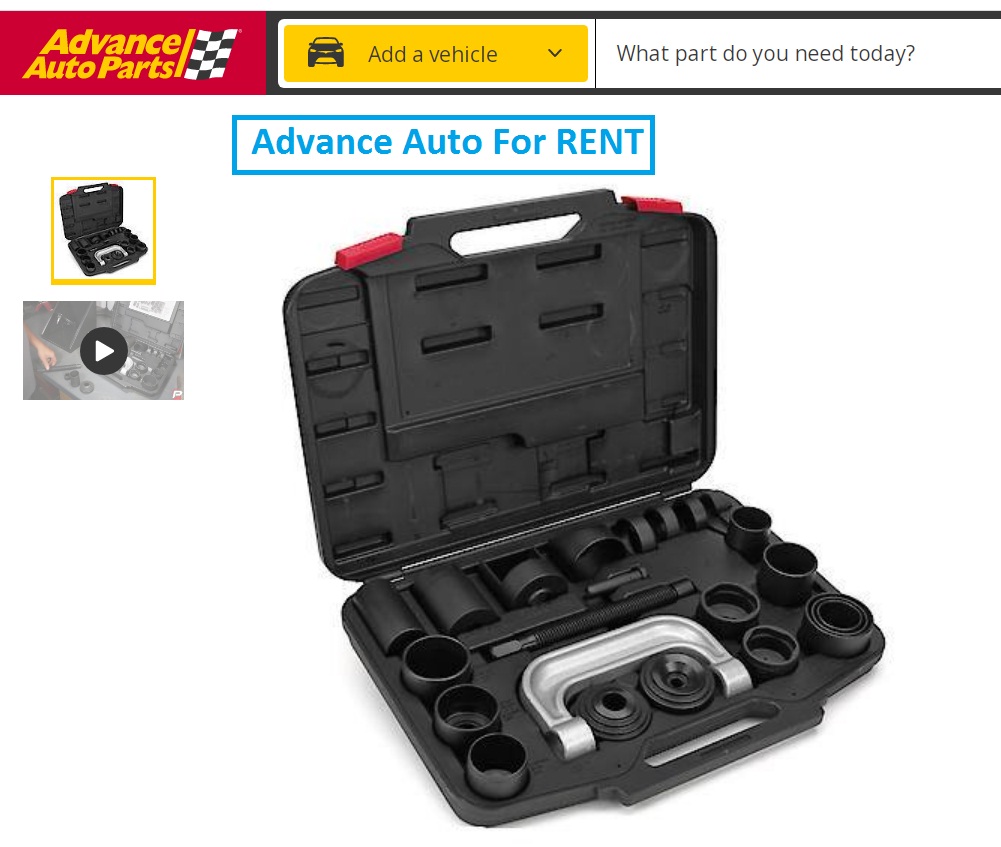

Has anyone here uses the Advance Auto Rental "Ball Joint Tool" or big C-Clamp to replace the bushings?
Or you guys just buy the whole control arms (in terms of whole CA, what do you recommend: Lemforder or Meyle on FCPEuro website)?
The Advance Auto Rental Tool is shown below...

I just tried this the other day with my harbor freight ball joint press (the exact same kit) and it won't work for both bushings. You can replace the rearward (vertical) bushings using that but it will not work with the forward (horizontal) bushings as they are too long to fit all of the necessary cups in the six inch clamp. I can see that they have multiple different sets, and one specifically for bushings so maybe one of the other sets might work. I saw a bigger 10" version of that on Amazon, but it was very expensive. I think I'm going to try to use a long gear puller with the adapters from my ball joint press, but you could probably find a socket that fits over the mounting tab on the bushing. Also, make sure that you have the correct bushing before you press out the old one. The smaller rearward bushings are different between AWD and fwd but the only difference is the outer diameter and it's only very slightly different by about a millimeter.cn90 wrote: 14 Feb 2022, 18:23 Has anyone here uses the Advance Auto Rental "Ball Joint Tool" or big C-Clamp to replace the bushings?
Some notes on using those ball joint presses: Grease the threads so it has less friction.
Once you get everything lined up and snug place the press into a bench vice or clamp it to a table.
Use an impact on it, you won't damage it and the vibration helps the part go in. Use a hammer and tap on the side of the control arm to help the part go in.
