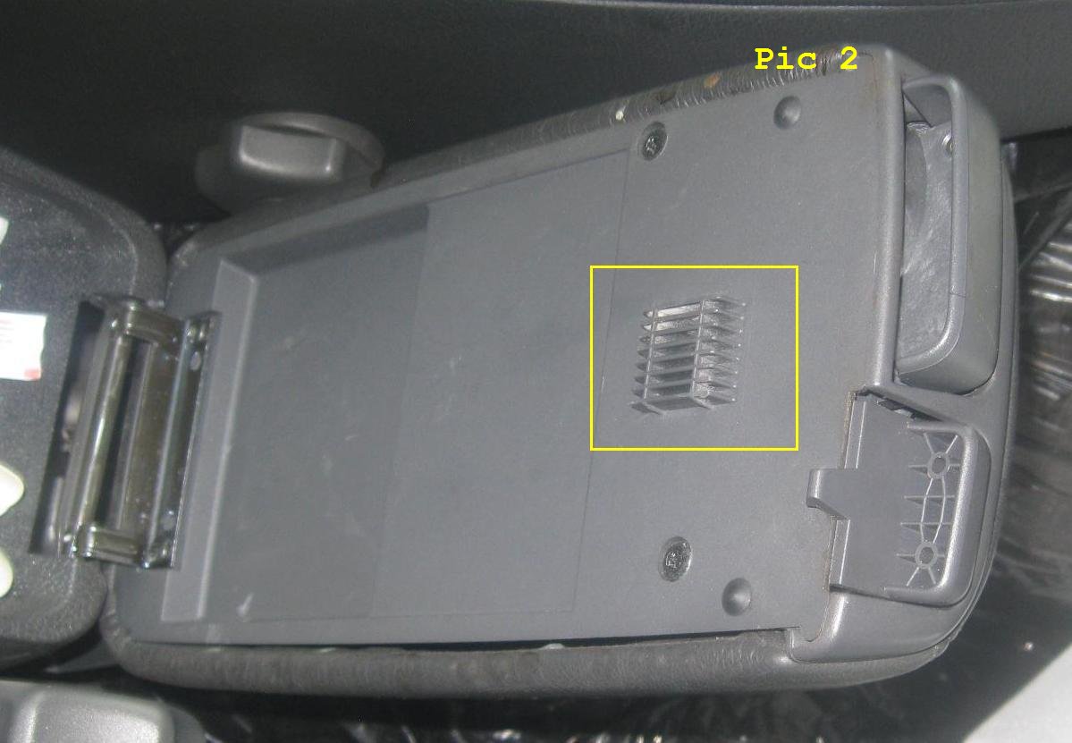

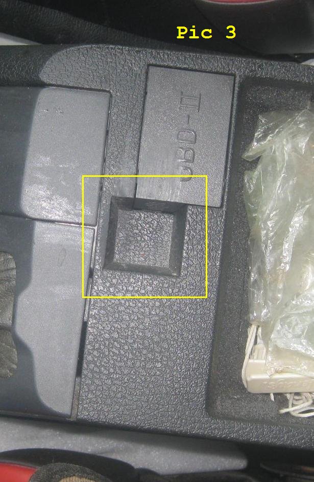

These three pictures show the break as well as the 'why' it broke.
The three pictures are, "ArmRest-1, -2, and -3" which i call picture 1, picture 2, and picture 3 here. They might get ordered backwards here.
In picture 1 we can see one break just under the screw head near the bottom left, and the other break to the left. The plastic piece that went in between the two breaks is missing from the photo and i'd have to find out where it went in the car in order to glue it back.
In picture 2 we see a strange looking ribbed 'protrusion' which presumably is supposed to fit inside the 'indentation' in picture 3. The protrusion part and indentation part are shown in the pictures with a yellow square drawn around them.
The other thing shown in picture 3 is the latch (to the left side of pic) and that is clearly intact and working.
What it looks like caused this break was the protrusion is supposed to sit inside the indentation when the arm rest lid is closed. If that happened correctly then the latch (pic 2) would actually meet up with the lip on the edge of the compartment (pic 3 to the left of the yellow square but hard to notice). That would hold it shut, and the indent/protrusion would help keep it from swaying left or right and thus put less stress on the hinge.
The main problem is the protrusion does NOT match up with the indentation, apparently because the lid is NOT aligned properly with the indentation. This is probably because of the cheap hinge (pic 2 left side) which if it bends even a little it will cause the lid to be misaligned with the compartment and thus the protrusion does not fit nicely into the indent.
If it fit as it should, then the latch would have grabbed the 'lip' on the edge of the compartment, but since it is not aligned properly the latch doesnt work (yet).
