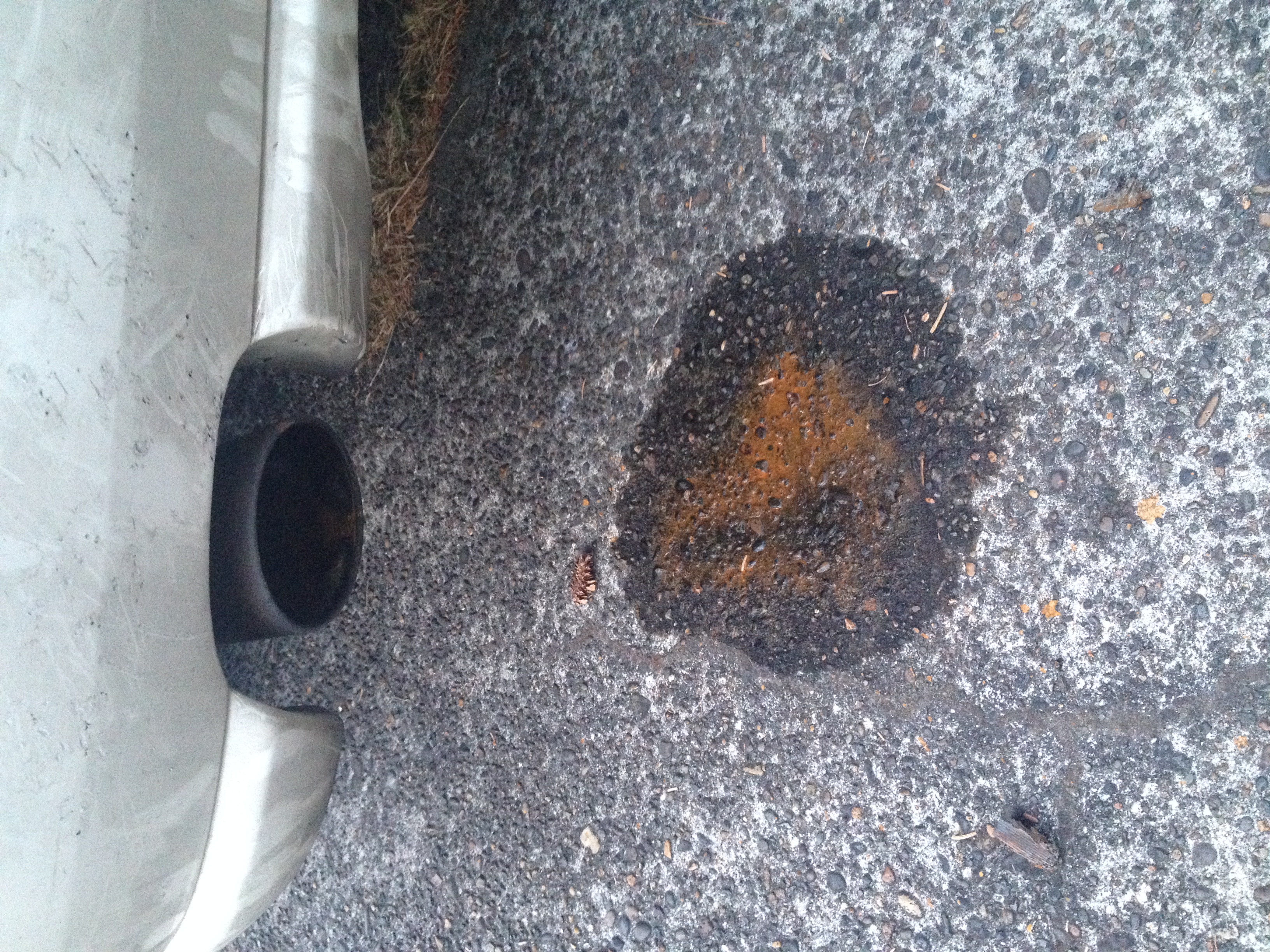

So here's where I'm at. Put new plug in it. Filled the coolant and had the kid in the pictures crank it. Had him go gas to floor and keep cranking and after a minuteish, it started.
We let run for about 3-4 minutes, see video and pics. While it was running I connected my scanner and it has multiple misfires. Again the plug wires are toasted. I will compression check each cylinder tomorrow.
There was a boat load of fluid leaking from just in from of the rear axle area and after the car was shut off I checked the resivour and it was empty.
What are your thoughts?
