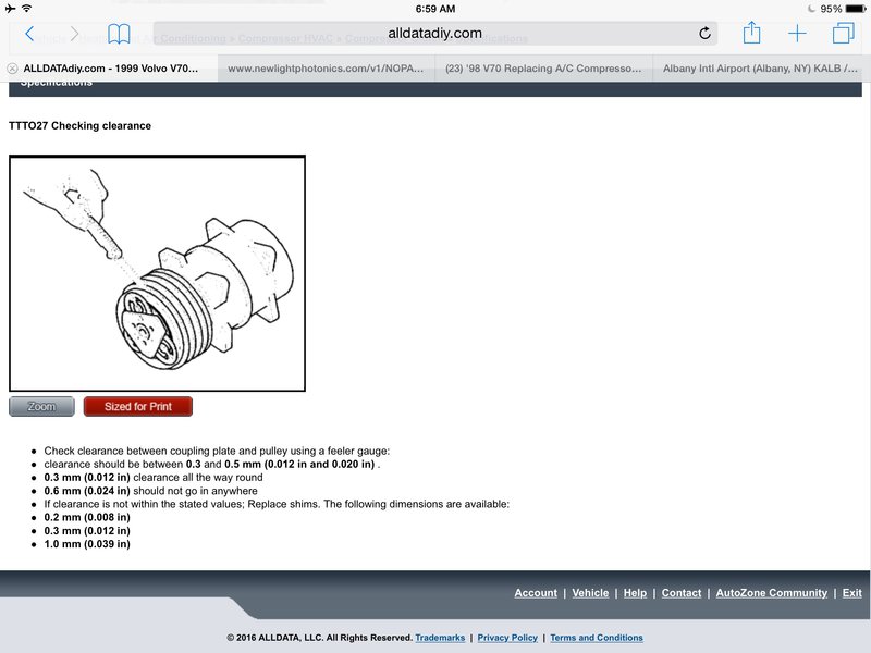

Anybody got the spec. on the a/c compressor clutch gap? cn90's right, if I'm all in on the job, I might as well get it right from the get go. Steve, I've got a postal scale so I'll add the r134a by weight. Thanks.

Clutch gap specs. Sim for the low side and check all the way around.
Remember to take out any bread clips or zip ties. You will have to come up with the right shims to adjust the gap from Volvo or from your old compressor

No bread clips or zip ties on the used one I got from Harry's but I haven't put a feeler gauge on the gap yet. . .

Compressor clutch shims no longer supplied by Volvo per my local dealer parts department.

Do they sell bread clips? - I couldn't resist.E Showell wrote:Compressor clutch shims no longer supplied by Volvo per my local dealer parts department.
In most cases there are several shims on the clutch and you can get it to spec by removing them one at a time.

Can some of you guys junking these pull the shims off the compressors?
Let's get the dimensions, too, as they can probably be sources from Grainger or McMaster Carr

Big props to the guys at Hackettstown NAPA on Willow Grove Ave. Took the A/C compressor up to get some bolts so I could lever off the clutch plate and remove a shim. I explained what I was looking for and what the job entailed. Before I knew it, we were removing the clutch plate, cleaning off the pulley surface with a Scotchbrite pad, removing the appropriate thickness shim, and putting everything back together. They were extremely helpful and I was the only customer in the store so they could afford to spend a little time really helping me out. I came within a whisker's breadth of not taking the compressor with me, but I figured, why not?

Pulley does about one free rotation when spun with a finger, then stops.
Not sure I have the clutch plate all the way tight based on tightening the center bolt. I have to see if it will tighten further, since the math on the gap doesn't add up (or really, subtract out) after I removed a 0.3mm shim. Is it hard to seat the plate all the way down on the splines with the compressor out of the car and flopping around on a table?
