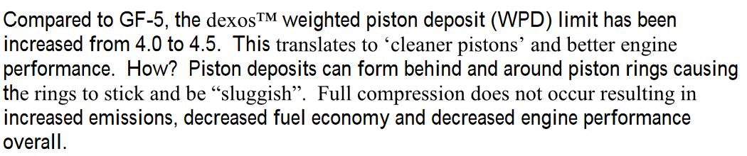

GM had a ring deposit issue, causing an increase in oil consumption, some years ago, and then came out with their oil, and then improved on it. More here: Understanding GM’s dexos1™ PCMO specification......Manufacturers are downsizing engines and incorporating features such as gasoline direct injection (GDI) and turbocharging to optimize fuel consumption. These smaller, lighter engines tend to run hotter and are under more stress than older engines, meaning they need stronger protection.

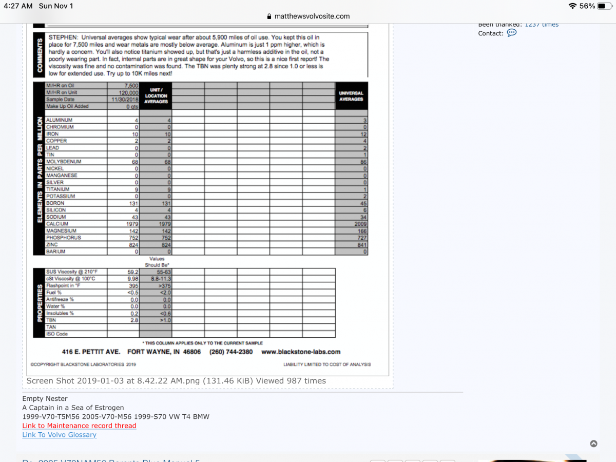

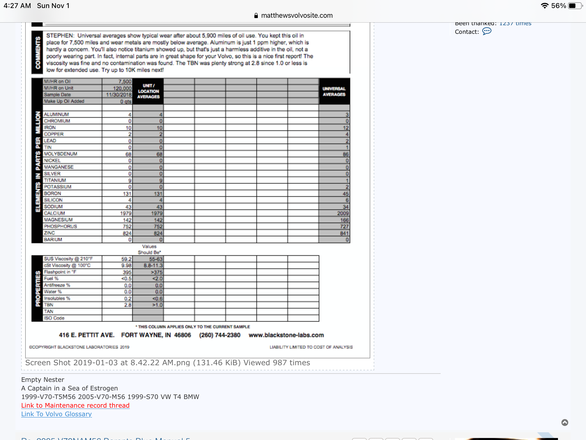

For those seeking a generic path to oil change interval nirvana....
Unless your driving is really pathological ( all short trips) use a synthetic oil and change it at 5000 miles, and have Blackstone run an analysis. Adjust interval accordingly based on data, not on colour or drip tests
Example test report, cost is $25
