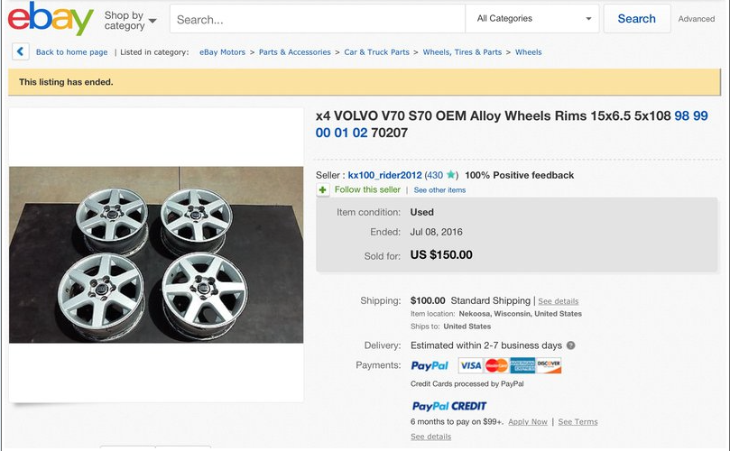

If you click the link I posted you will see the wheels I bought for about 3 seconds. Then they disappear. It's plenty of time to see them though.abscate wrote:This is tough with out pictures so people know what wheels we are talking about here.

I actually linked to the eBay auction in an earlier post today and the link works for about 3 seconds and then the photo disappears. You can briefly see the wheels there. Don't beat me up for the shipping price which in my opinion was extreme. The wheels were in very good shape and 37.50 each. Unless shipped FOB anything heavy will cost a fortune to ship.98v70dad wrote:I don't have a picture with me today that shows the new wheels. I linked to the eBay sale and since the auction is over is doesn't stay on the screen for more than a few seconds.
- Posts: 36158
- Has thanked: 1611 times
- Been thanked: 4074 times
Hacked the eBay server for you ...that password is too easy by the way..

Thanks for posting that for me. I couldn't figure out how to do it with an iPad. On my PC it wouldn't have been a problem for me but I'm not at my PC recently. Based on the comments I'm leaning toward thinking that the Cetus type bolts will at least work.abscate wrote:Hacked the eBay server for you ...that password is too easy by the way
Does anyone know what the name is for the wheels I bought? If I knew that I could probably find some info about the bolts required on the internet myself.
