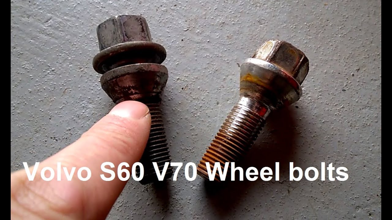

i check my bolts periodically, there are two types of wheel bolts the new style have captive washers where early cars had plain bolts (no washers) these bolts with no washers should be torqued less because the bite into your alloy rim and can lock.

So since my P2 is a 2002 most likely with the old bolts, would you recommend getting the ones with washers?

Umm check first? If you have rounded out bolts or $80-$120 to burn then go ahead. Otherwise, there's other parts you should save up for.

My opinion based on some incomplete knowledge of fasteners and bolt torquing, risk of incorrect (but close) torque on the lug bolt is less than risk of galling the threads or washer seat in corrosive areas. Use the schmear of anti-seize on threads and washer and check torque again at intervals.BlackBart wrote: 30 Sep 2021, 12:13 Would you ever put a schmear of anti-seize on those earlier type bevels, or does that mess up the torque number?
