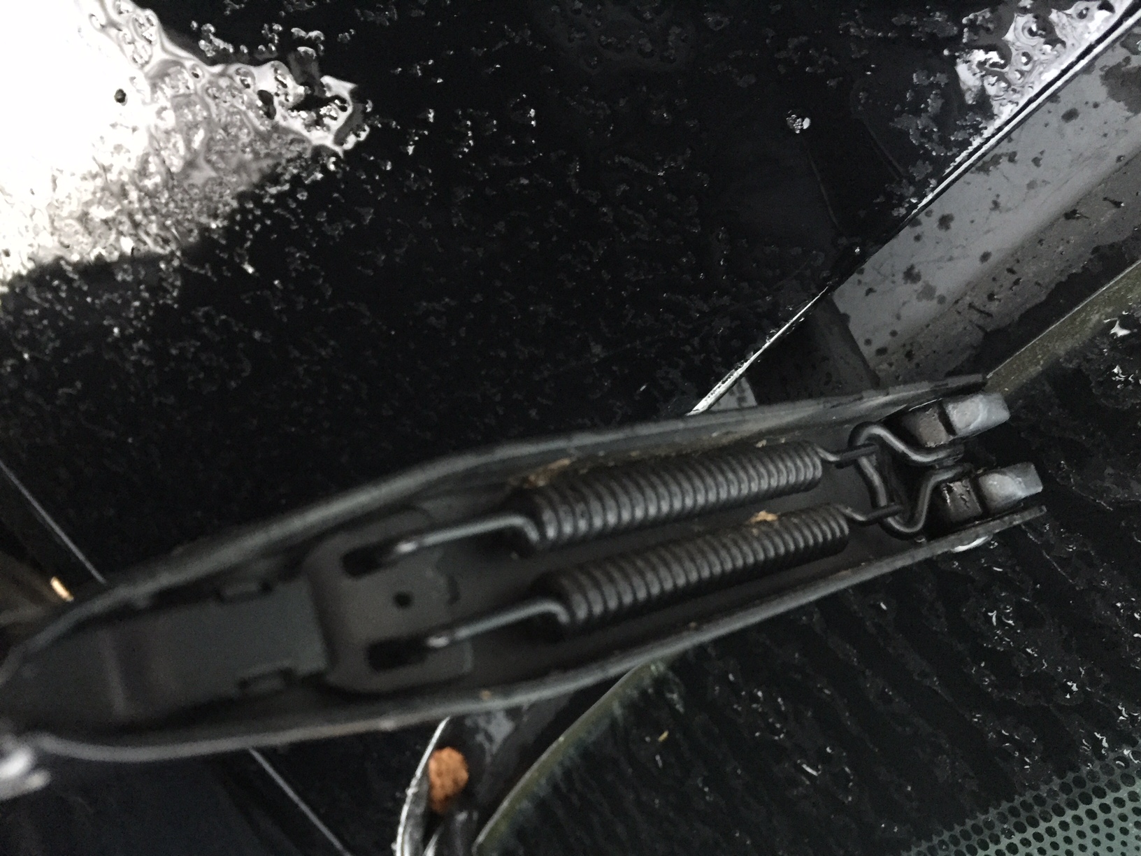

You are correct that many people have reported that an S70 arm fixes the problem on an 850. But yes, the info from dosbricks is not to be discarded, either. I have never tried to sort out the issue(s), so that one is a question mark for me. I have an extra S70 arm in the garage, may get around to putting it on one of my 850's eventually ...

I'd like to see that.Clemens wrote:Someone on a german forum posted that he used a dremel to file away some material on the lever where the wiper arm is mounted on. There seems to be a little ridge that prevents the arm from touching properly as that lever ages and bends over time. I will try to look that up and link it here. I might give it a try on my wifes 850 where the wiper barely touches anymore and post results here.

This is interesting, I'll have to take a look under my wiper arm to see what region you are talking about. I don't believe I have come across this method on MVS, but if it's here, I hope I can find it. I've searched before, so maybe it came out after I did a lot posting.dosbricks wrote:I tried several different bending contortions and also the '98 S70 passenger wiper arm for the driver side 850. The latter contacted (by height) the hood at the end of the down stroke. None of that worked to give a good clean wipe.
Finally I stumbled across the method for reducing (I used a Dremel tool) just a bit off the two little bumps under the arm that act as the limit for how tightly the springs can pull the arm down toward the windshield. This increased the spring pressure against the windshield and have had a full sweep clean wipe ever since no matter how light or heavy the rain. I think this method is discussed somewhere on MVS.

Bend the arm up at the hinge, you will see the two little nubs dos is talking about. Can't miss 'em.

This is now a serious issue for xHeart -- help.
A good 1/3 driver's vision is left untouched by the DS wiper with new blade - rain is here, snow is coming. It gets dark around 5:00 p.m.
Any pix of the "two little bump"?

It is the two lighter colored nubs at the base of the spring-attachment-loop, down at the base of the arm. Shave some material off the top surface that is parallel to the sky:xHeart wrote:This is now a serious issue for xHeart -- help.

I know we all have to find the path to Volvo enlightenment that is right for us. But for those still wrestling with this issue, if you own or can borrow a Dremel tool, it's super easy to relieve about 1mm or less from those two nubs shown at the right of Erik's photo. The result is a totally clean wipe at zero cost.
