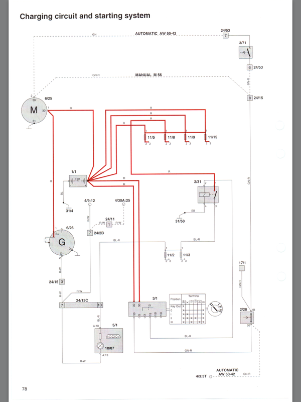

The big red cable from the alternator to the starter to the battery is HOT all the time. Your issue is NOT there.
I really don't want to nag, but this is my third time saying it. Follow the wiring diagram I provided and check the circuit.

It's connected directly to the battery, so yes.Myvolvo850 wrote:Should the red battery cable show power to the starter at all times?
If the starter doesn't keep running when the small green/red wire
is disconnected, it pretty much has to be a bad ignition switch.
The only other contacts in the run from the ignition switch
to the starter are the PNP and the alarm's starter cut relay.
And the PNP contacts and starter cut relay interrupt the
starter trigger circuit, so they aren't likely suspects.
The ignition switch contacts are the only only set that
connect 12 volts to the starter through that circuit.
Refer to the diagram and start shopping starter switch
contact blocks. Most folks suggest sticking with OEM.

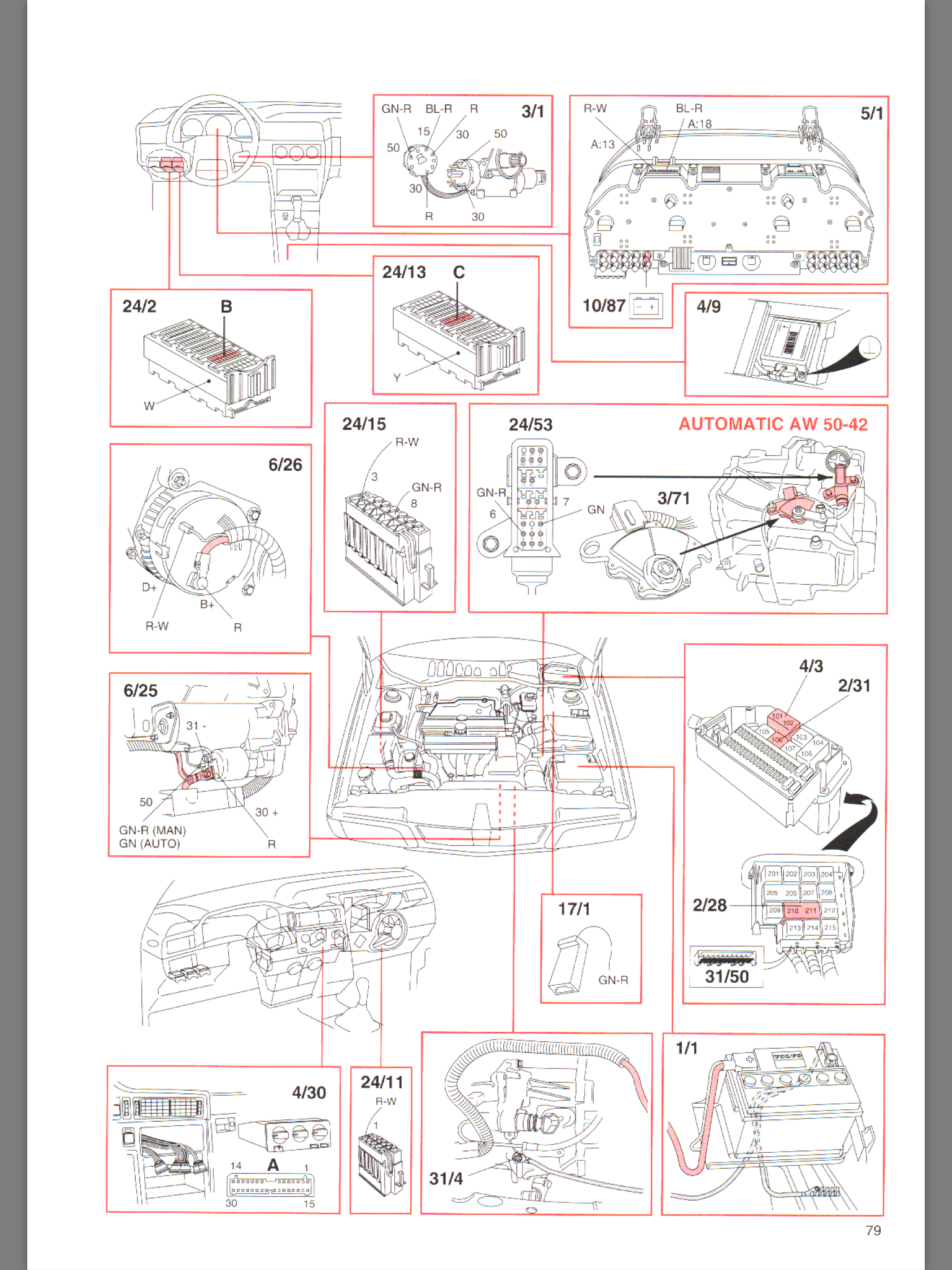

A little more good stuff on this topic:
2/28 is the alarm system stuffed into a dual relay sized package.
It includes the alarm brains and the normally closed starter cut relay.
( It also handles locks, interior lights and door open alarms, IIRC ).
This relay opens the starter circuit when the alarm goes off,
otherwise it passes power right through to the starter.
3/71 is the PNP ( Transmission Range Switch ).
It only allows power to pass along to the starter when
the trans is in P or N, so the car won't start in gear.
17/1 is the underhood starter service connector.
It lets you inject 12 volts from the engine bay so
that you can bump the starter over during service.
It should be disconnected and hanging free.
