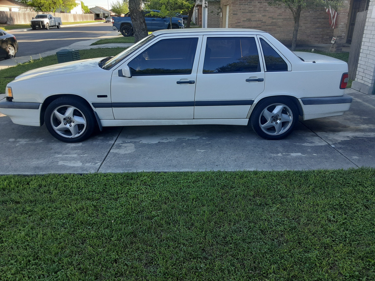

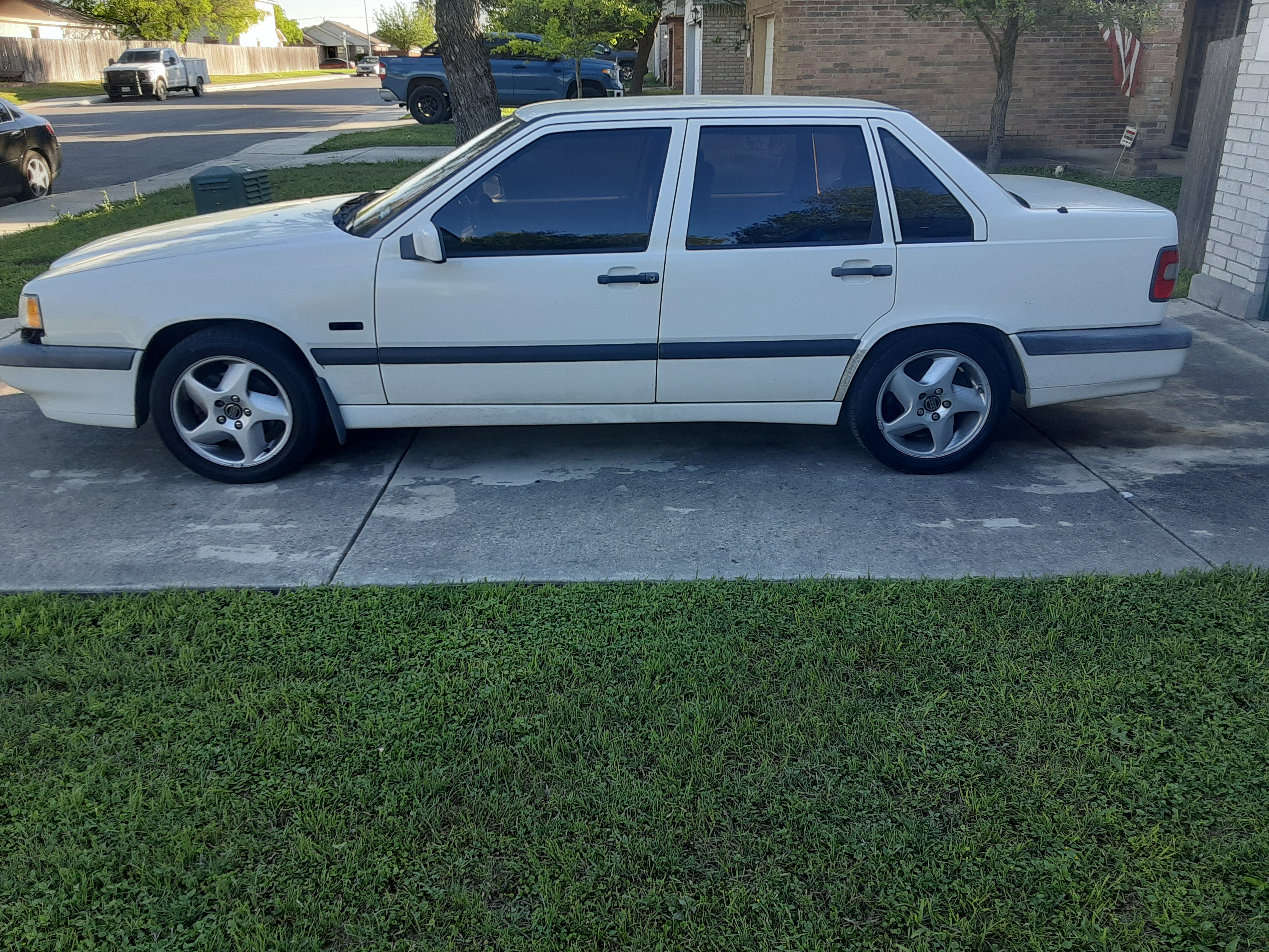

I've been waiting for a compatible block for close to a year now haha. Not giving up tho! As soon as one comes up I am locked and loaded, ready to respond with cash money to get my project started. My search radius includes Austin, San Marcos, San Antonio, Waco, etc. Basically central Texas, if there is a rear ended or otherwise trashed 850 Turbo I am probably willing to go get that block!
In the meantime here is my current daily driver: a 1996 Volvo 850 NA that is the beneficiary of all the harsh lessons I learned while absolutely abusing her 850 Turbo predecessor. As you can see she is borrowing the wheels off my Turbo. The only "upgrade" I'm interested in at this point is a Prancing Moose decal! My goal is to get her to 500k miles, maybe even more depending on how she holds up! As it stands she is SOLID. Major problems: the AC has gone out (who cares) and she needs a head gasket replacement. She's losing coolant however she just recently stopped losing oil after I completed the PCV job, which is what I was *hoping* for but wasn't exactly expecting...kinda weird by hey I'm not gonna complain. I keep a close eye on her coolant/oil levels daily but I haven't really been driving much due to the Corona situation. She starts right up everytime, never acts up, gets me everywhere I need to go.
