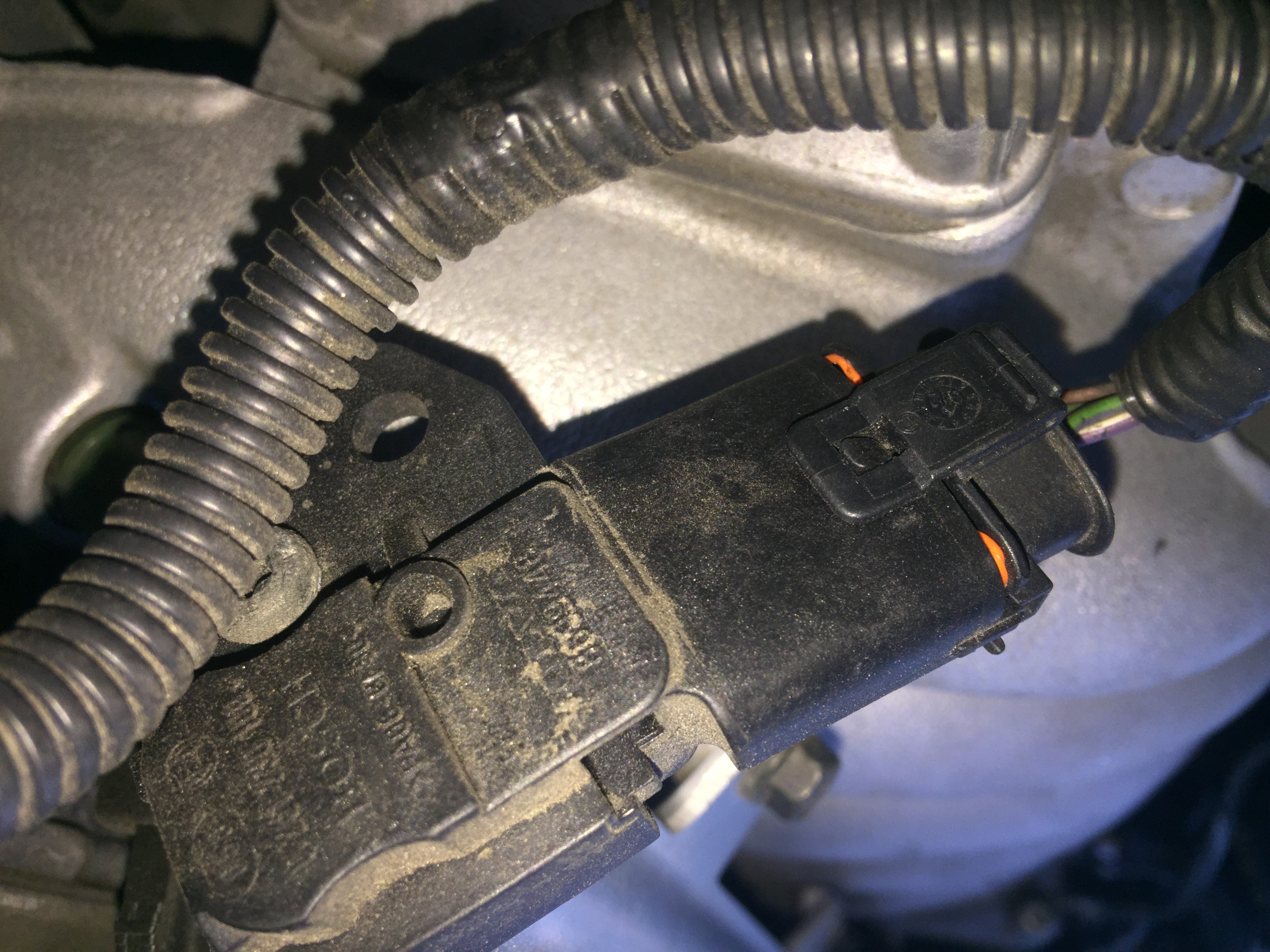

Amazingly helpful info, look what i found
Posts: 36153
Joined: 17 Feb 2013, 17:54
Has thanked: 1610 times
Been thanked: 4069 times
Nice Enrique and orangex....that's the fuel pressure regulator on the end of the fuel rail. On P2 cars that controls fuel delivery of course

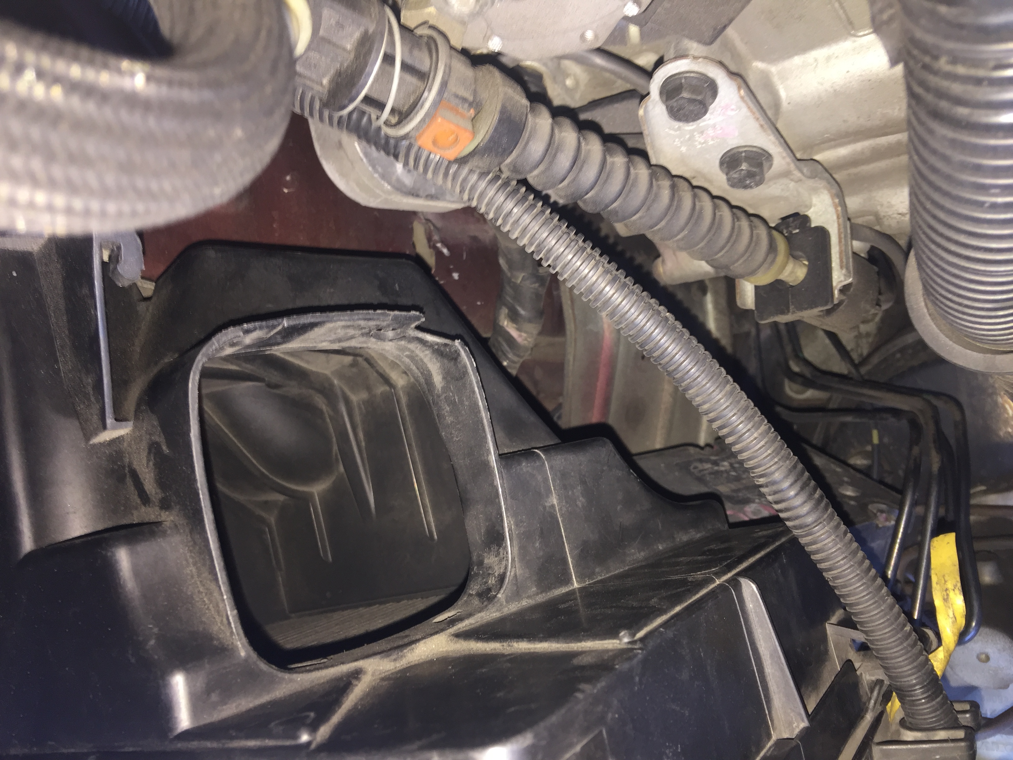

Thanks, also if you see the picture of my air filter box, there's no other hoses connecting it to the assembly that sucks fresh air located above the grill. Could this be creating an unusual condition and possibly be the cause of my stalling issues?
