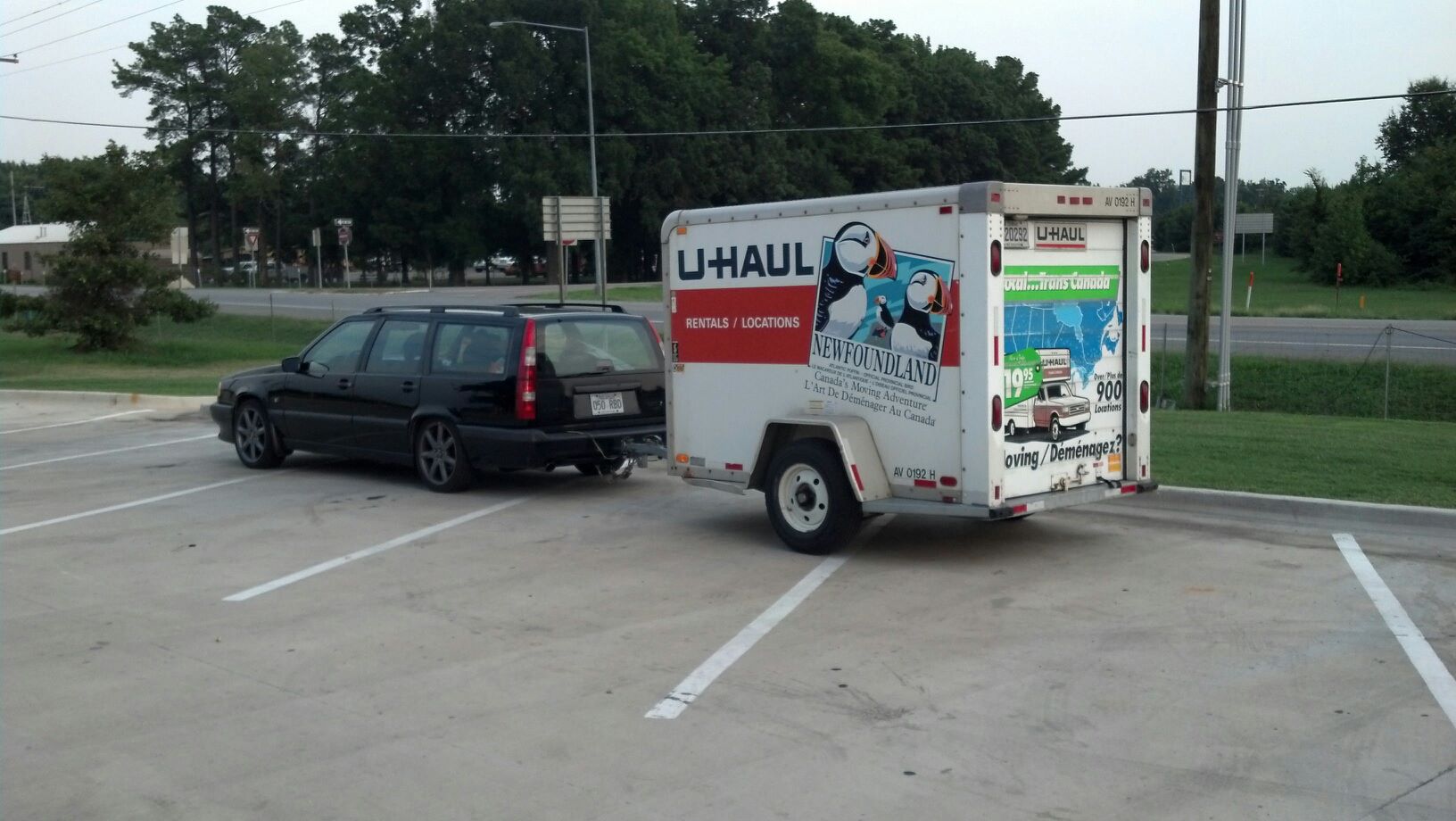

Here's my towing prep post. If I could do it over, I'd have sold all that junk... bed, furniture, bike even. For some reason I was "invested" in that crap. But since MVS isn't a philosophy site, I digress...
Here's the rather light on details after-towing post.
My 850 had only 82k miles on it, and was freshly Stage 0-ed. I think I averaged 12mpg and 55mph.
I wouldn't do it, 98v70dad. That's my unsolicited advice.
