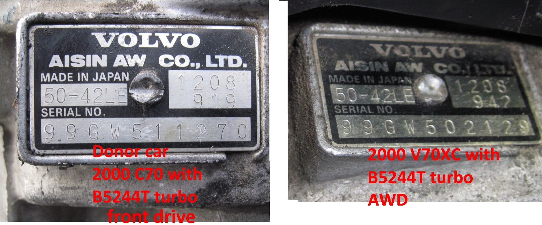

I've gotten the name plate data from both transmissions. Both have the same model number 50-42LE but a small variation in the other number. I don't know the significance of the 1208 919 vs 1208 942. Maybe a different final ratio? Time for more research. Pic below.
- Posts: 36147
I think those might be date codes and production line codes but the experts here will confirm

I've not had the transmission side by side but I can't imagine that the XC transmission will swap out directly for a FWD. There is a splined collar that goes between the transmission and the transfer case that drives the gearcase for the rear wheels and the seal arrangement is totally different since it is a double seal arrangement on the AWD transmission to seal both the drive collar and the axle. The right hand axle is driven directly by the transmission like a FWD and the axle goes through the collar. The axle and the collar are sealed separately.
There are also mounting holes machined into the side of the transmission where the transfer case bolts up that I don't think are there on the FWD version.

My 2000 build T5 (P2 FWD 5 speed series) has the angle gear holes. Perhaps it's a 2000 build thing at the Aisin factory to cut down on production costs so all casings can go one way or the other.
The rear of the case needs to come off so the angle gear collar can be fitted from the inside as Ozark mentioned . It's been done successfully here on MVS on a P2 T5 (the guy converted an AWD casing to FWD) however the final drive ratio would need to be matching.
