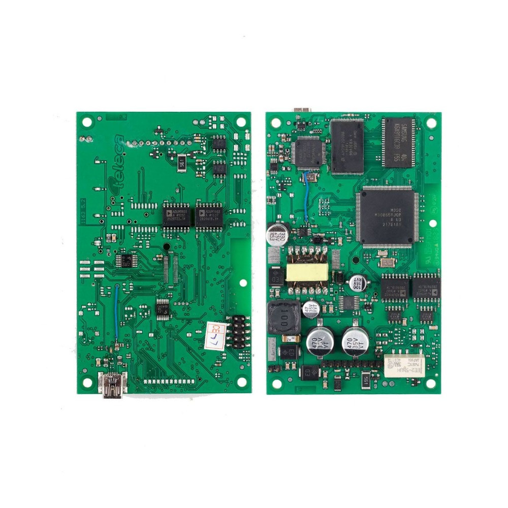

I tested other options and it seems that the problem is in Dice...
Vdash was trying to read the car without success; no problem reported...but nothing happened after 10mins of reading
Instead, ELM327 was able to read the VIN and operational values of running engine...from ECM
I wonder whether Dice can be repaired...has anyone wiring diagram of Dice/Teleca green board? I checked my board quicly under microscope but have seen no obvious problem in soldering (some reported unsoldered contacts of the white relay etc). What attracted my attention however are pictures (from aliexpress) of some Dice boards obviously repaired or at least different to my board)...see picture

Hi there!
I had fully the same issue you had. Even more, i had two DiCEs, both having the same issue. So I disassembled them both and realised, that one of them had incorrectly soldered white relay (EE2-4N3) and the other one is not, but relay was quite damaged. So muy suggestion will be to order this relay somewhere or just buy it and resoleder on your board even though it looks fine. Or just unsolder it and testaccording to datasheet. Good luck!

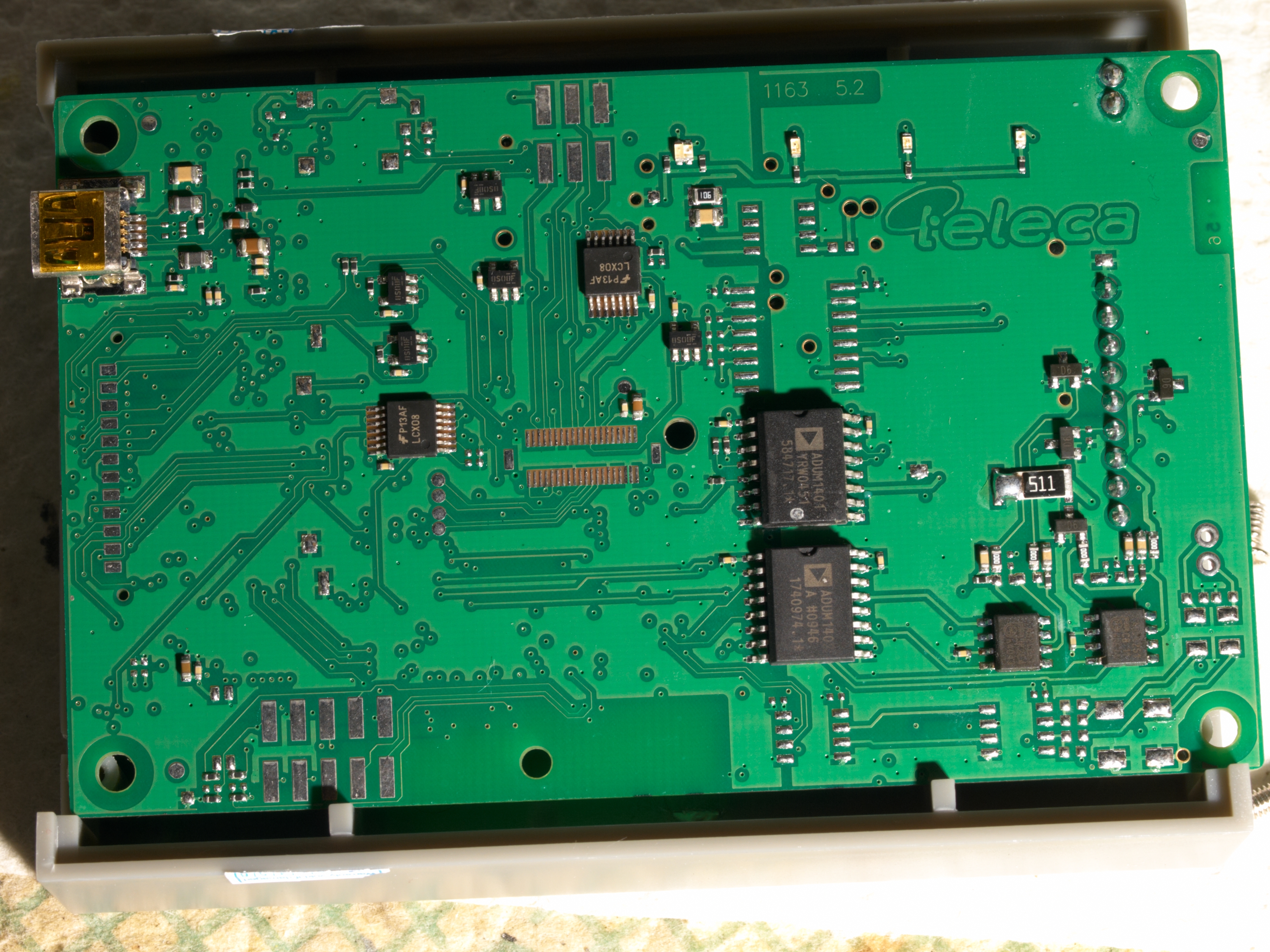

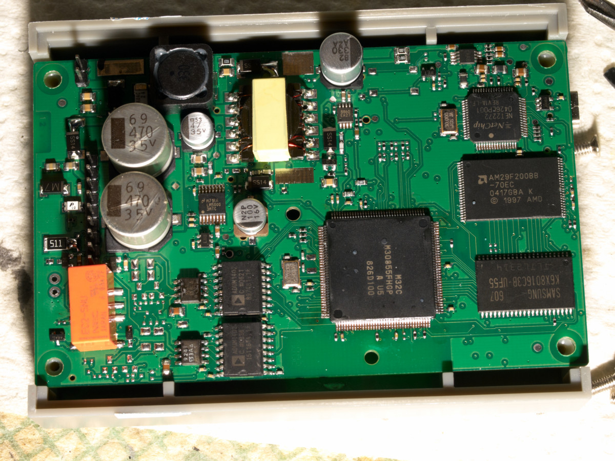

I found these extremely high resolution photos of the PCB online so I'm going to upload them here both for reference for others, and just so I don't lose them, thanks for the bandwidth Matt! Will be continuing troubleshooting shortly.

br0dy519 wrote: 23 Nov 2021, 21:07 I'm going to upload them here both for reference for others
The boards are not all the same. There is more then one company that produced a DiCE clone.
You should post some high restitution pictures of your board.
If you got a color scanner. You might try using it as a camera. Set the scan restitution high and save it in a picture format.
