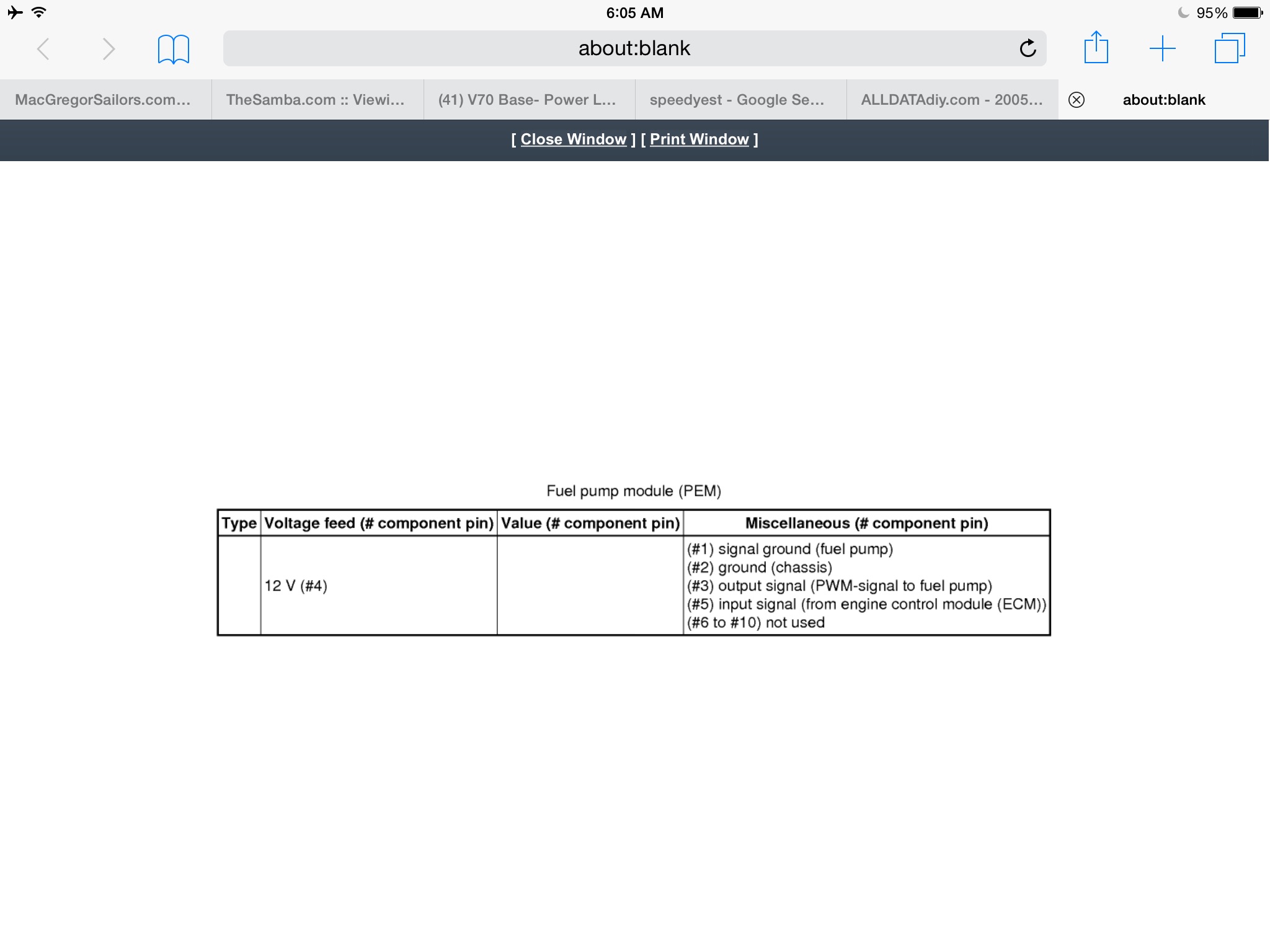

- Posts: 36149
The pump module modulates the voltage to the pump to control fuel pressure, so you need an oscope to look at the waveform
On my 2005, pin 4 should carry the battery voltage per attached

So a reading of 10V at the pump may be a GOOD sign - showing that the FPS is doing its job???abscate wrote: 06 Apr 2017, 04:09 The pump module modulates the voltage to the pump to control fuel pressure, so you need an oscope to look at the waveform.
- Posts: 36149
It's not definitively good or bad
Pin 4 at the PEM should be battery voltage though
