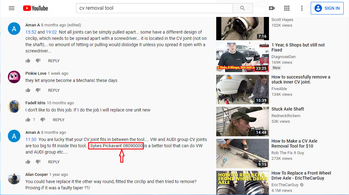

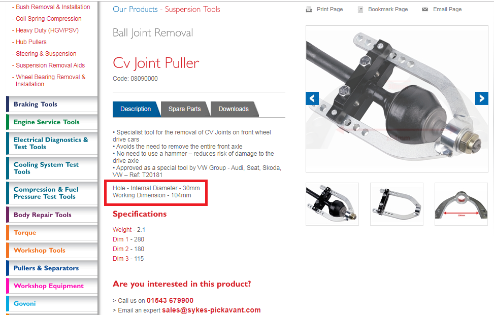

The tool mentioned above has a width of 100mm, so it can handle axle with CV width of 95 mm or so.
While watching youtube video on CV Removal Tool, someone commented that for bigger CV Joints, use Sykes Pickavant 08090000.
Has anyone here used Sykes Pickavant 08090000 for bigger axles (such as in SUV Volvo XC90, BMW X5 etc.).
I see this Sykes Pickavant 08090000 on sales on ebay UK website for about $50-$60.
