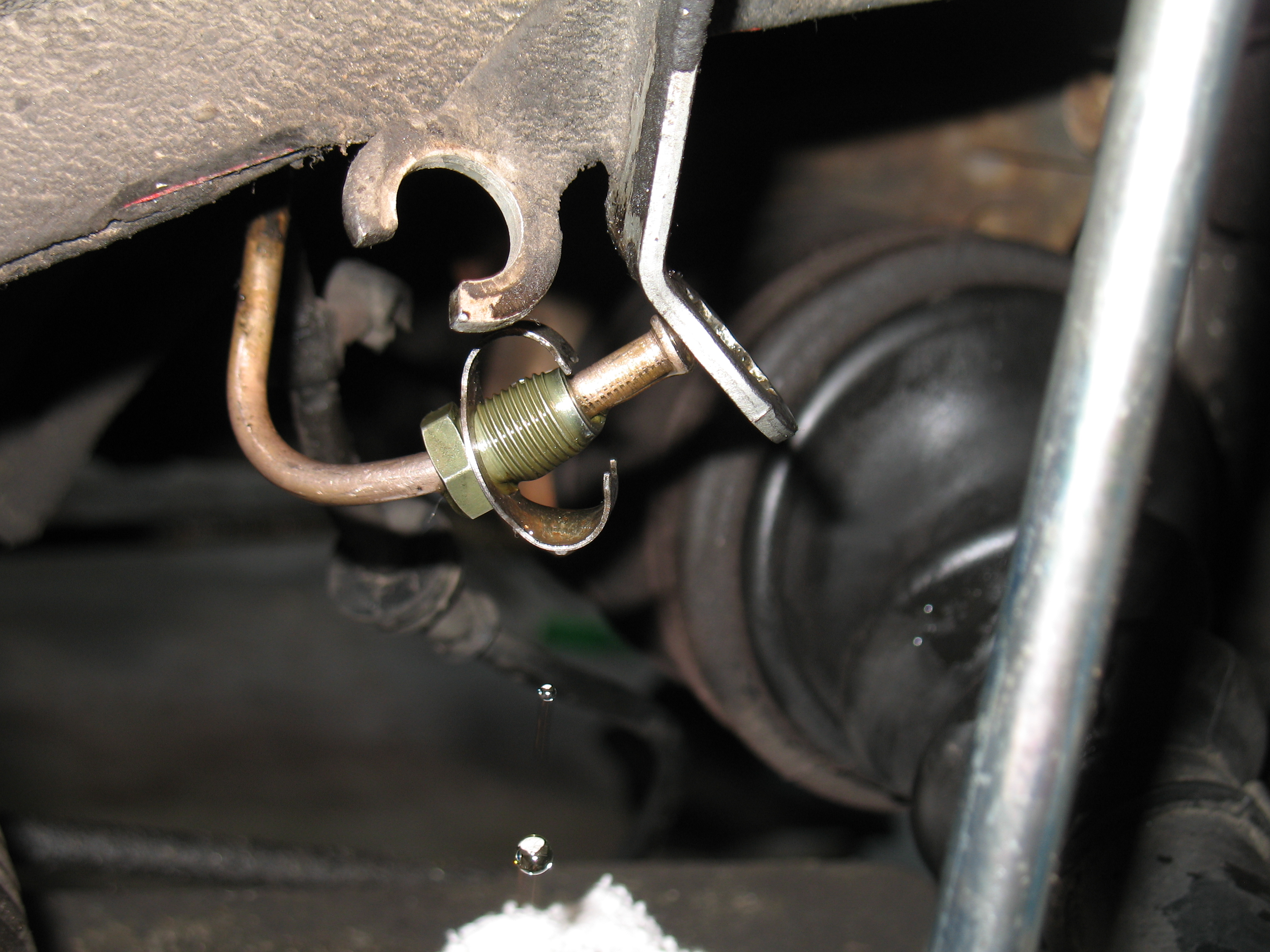

Or search forum for the dremel trick, basically cutting slowly on the hose's female side until it is almost done.
Make sure you don't damage threads parts on the pipe side.
Once the hose is removed, you will see this:

- Posts: 36153
- Been thanked: 4068 times
You probably won't see the drops....cn90 wrote: 26 Jul 2017, 18:01 Or search forum for the dremel trick, basically cutting slowly on the hose's female side until it is almost done.

It is off.
I hit the difficult hose connection in front of the driver's side rear wheel with
PB Blaster, WD40 and Kroil, 3 or 4 times. Today I heated it for about 3 minutes
with a propane torch, aim the flame at the muffler so as to not heat up other things.
I held the flare nut with the snap on 11mm wrench and wedged it up against the
frame. I had pulled on the metal part of the hose end to release it from the notched
bracket and broke it free with a 6 point deep socket on the metal part of the hose.
It was tight the whole way probably due to corrosion in the threads.
I believe that the flare nut is a brass alloy so it looks okay.
Once it is all free the end of the hard pipe and flare nut can be pulled down about 2 to
3 inches lower so that it can be seen below the car.
The flare nut does not seem to want to turn free of the hard pipe, any tips on how
to free it up? Soaked it with PB Blaster and WD40, will give it some time.
I'll probably turn the hose if I can't free it up, then have to remove and turn the Y
connector that goes on the other end - a pain but perhaps easier than dealing with
damage to the hard pipe if I break it forcing the flare nut.
Strange that the hard pipe does not look rusty at all but is stuck to the nut.
