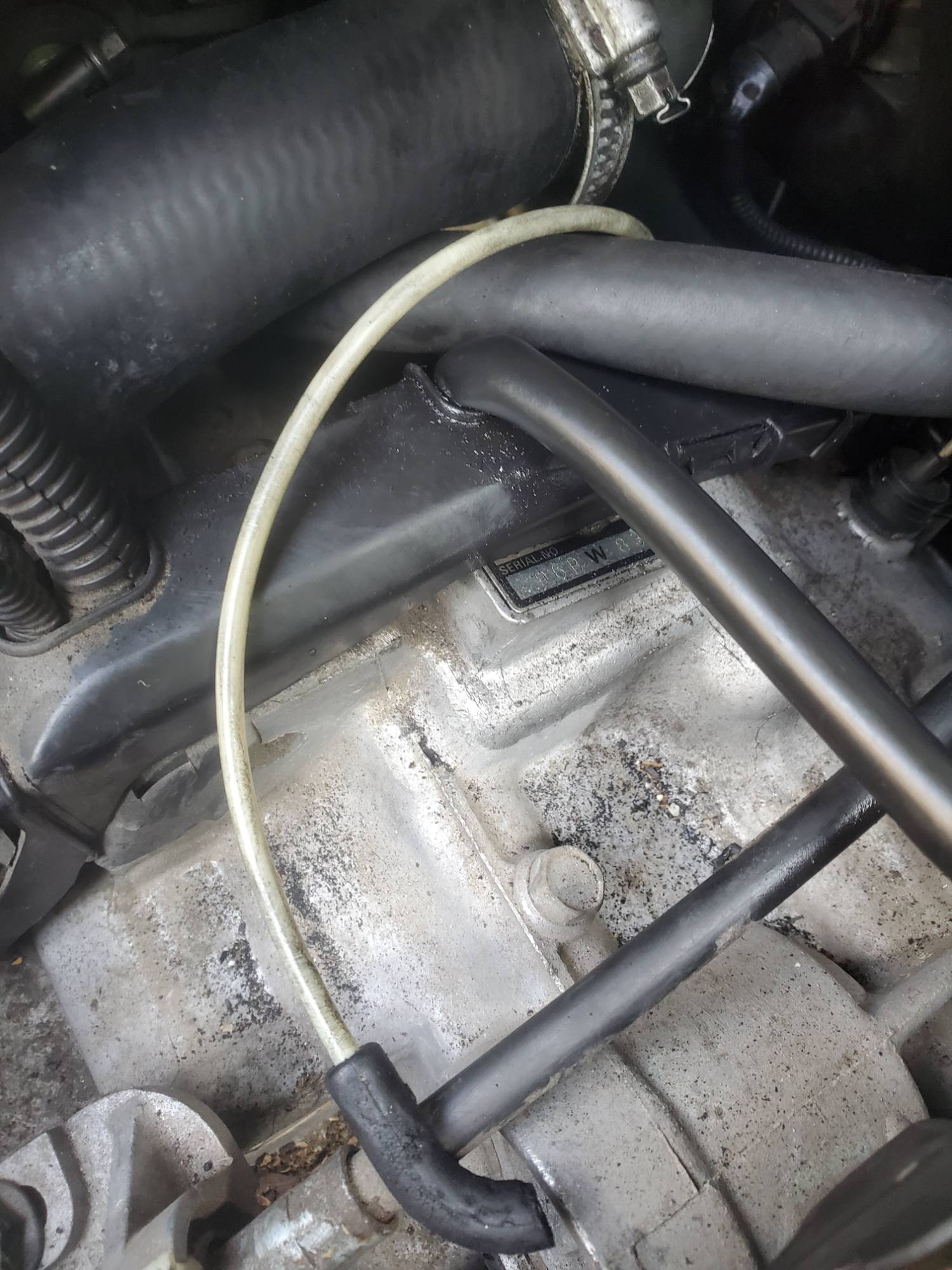

1997 Volvo 850 GLT Turbo - very small hose above lower radiator hose in engine bay is broken.
- Posts: 36142
- Been thanked: 4064 times
It’s a vacuum hose for the heated air motor on the air cleaner

Turbos don't have them. There is a small hose that runs to the PTC nipple area on some turbos and to the top of the snorkel on the older engines if I recall correctly.

Other vacuum operated stuff nearby…
Hot air motor noted above
supplemental air system solenoid, mounted high behind radiator
Cruise control?
EGR system, unlikely in a 1997
Cruise control?

The GLT is a low pressure turbo.... no boost gauge or "Turbo" script on the airbox. My 99 S70 GLT doesn't have those things either.moses3 wrote: 28 May 2023, 23:47 Mine has it, and it has a turbo. Maybe the turbo was added later, because I don't have a turbo gauge on the dash or an air filter box marked turbo.

I think my '97 855 GLT also had a hard white hose like this, with a crumbly rubber elbow, and it was part of the SAS system, connected to the solenoid valve on top of the radiator as abscate mentions above. If you're keeping it, I would recommend using a piece of silicone hose to replace the rubber elbow because the rubber elbows don't seem to have a long lifetime -- maybe 2-5 years at best and possibly less depending on which elbow location. The silicone hose is flexible enough to make a bend similar to what's molded into the elbow.

How can I use a silicone hose to replace the rubber connector? One side of the rubber connector is wide, where the other side is narrow?jreed wrote: 29 May 2023, 07:33 I think my '97 855 GLT also had a hard white hose like this, with a crumbly rubber elbow, and it was part of the SAS system, connected to the solenoid valve on top of the radiator as abscate mentions above. If you're keeping it, I would recommend using a piece of silicone hose to replace the rubber elbow because the rubber elbows don't seem to have a long lifetime -- maybe 2-5 years at best and possibly less depending on which elbow location. The silicone hose is flexible enough to make a bend similar to what's molded into the elbow.

I had that concern too -- flexible thick wall silicone tubing worked. You can get a tight seal on the narrow end and still be able to stretch the tube over the larger fitting on the other side.
