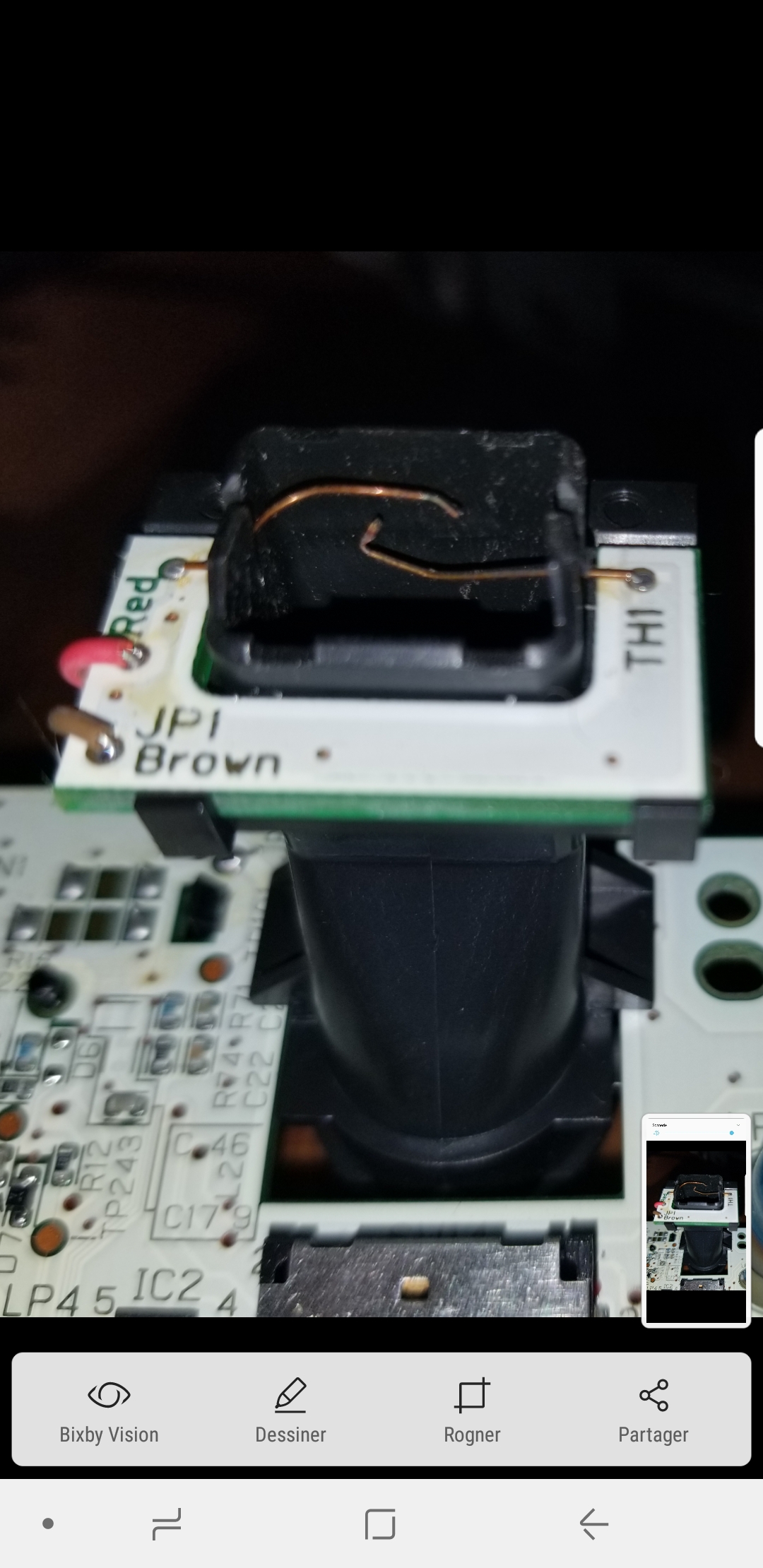

I soldered the thermister wires at the tips and my thermister is now working. Ordered a new one from Mouser anyway. 2001 v70 t5

That is a very high value resistor.
I donβt know if you can use a junkyard CCM but I would certainly try

Actually dug around the forums for a good hour and found out that people replaced/fixed this issue by getting a NTC Thermistor with similar values to fix the issue. Going to give it a shot this week, only 10$...

I already took everything appart though but that guide would have been usefull while doing it. Not that hard of a job but I guess Ill clean out the little fan while Im in there. Got my part on amazon, was 10$ for 100 NTC glass thermistors while a 10k value so technically should also work with plenty of spares...lol
