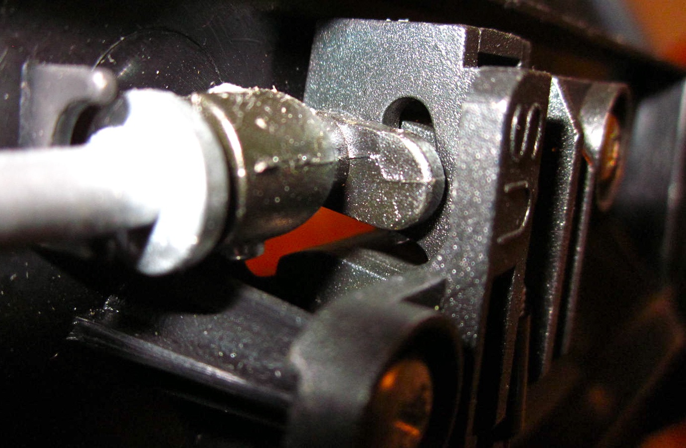

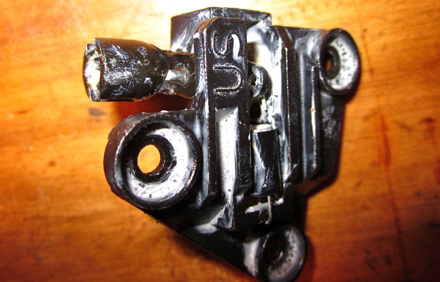

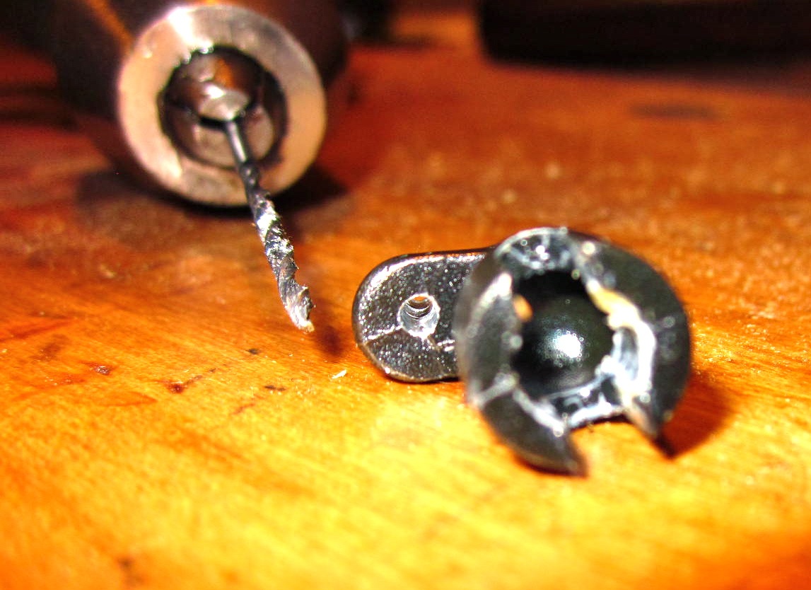

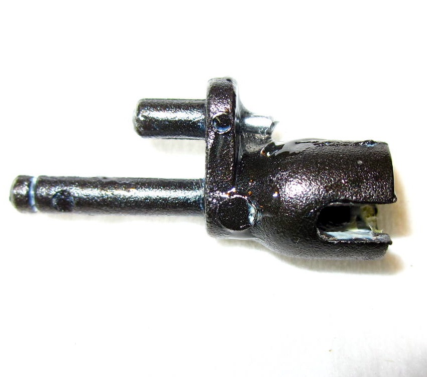

I was inspired by the images of hacksaw blades and holes in the glovebox door to go and do some preventative maintenance on the latch mechanism...(pictures below).
I disassembled the glove box door and the mechanism. The metal actuator arm was still intact (no signs of bending, cracking or shearing) but I decided to strengthen it by inserting a steel pin. I drilled a hole in the actuator arm using a 1/16" bit. Then I fed a 16 gauge steel wire through the hole and clipped it to length with wire clippers. Then I mixed some rapid setting clear epoxy and filled the hole and coated the wire with it, and put the wire in the hole so that the end of the wire protruded slightly past the end of the pin.
After the epoxy set, I reassembled the actuator in the mechanism, applied some white lithium grease and put the mechanism back onto the glovebox door.
So far, it's working as smoothly as before I took it apart, and hopefully the steel pin will add strength and be less brittle than the metal actuator arm.
- Actuator arm with steel pin held in place with epoxy.
- GloveBoxLatchDrill&Peg_03.jpg (97.83 KiB) Viewed 9672 times
- Actuator arm with 16 gauge steel wire fed through the 1/16" hole. (White stuff on mechanism is lithium grease).
- GloveBoxLatchDrill&Peg_02.jpg (318.92 KiB) Viewed 9672 times
- End view of actuator with the freshly drilled hole made with a 1/16" bit and hand drill.
- GloveBoxLatchDrill&Peg_01.jpg (204.05 KiB) Viewed 9672 times
