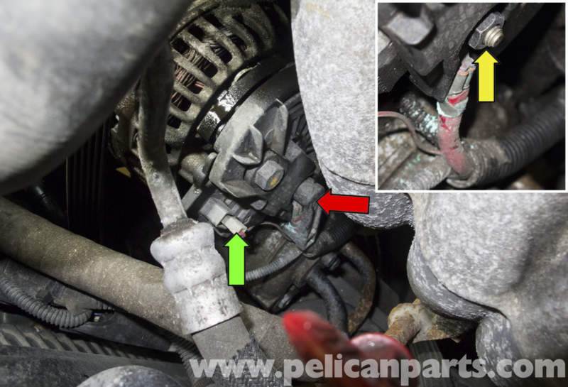

If someone can post a pic of what terminal on the alternator to measure for the voltage drop, i'll check mine too and we can compare notes.
Where is the terminal to measure on the alternator?
Same basic car, 1998 v70 non turbo, automatic trans
[i think the positive terminal is the one that has insulation around it?]
BTW i almost forgot to mention, the mounting bolts probably have to be very tight too in order to make a good ground connection. I had that problem once on an old Hyundai.

There should be two connections on the back of the alternator, you want to test with the larger one. It says B+ on the plastic casing next to the terminal.
The smaller spade connector is the voltage regulator.

Oh ok thanks, does this look like it?
I found this pic on the web.

MrAl wrote: 21 Aug 2017, 04:05 Hi again,
You have to unclup that plastic cover to see the B+ terminal, red arrow
The smaller push on connector triggers the alternator light or service required message in later cars

Hi Steve,
Thanks, this is starting to make some sense now.
Would you happen to know how that small nut cover comes off?
Is it bolted on or does it just press fit over the nut?
I am hoping i can actually get to this nut in the actual car because there are so many other things in the way.
I took a picture a year ago or so and in the pic i cant even see the back of the alternator. I'll try again though.
Somehow i'll have to try to get past the other stuff.
I think i may have an abnormally high voltage drop too so i should do this. The ground wire does not look very heavy either so it looks like someone retrofitted the wire some time before i got the car and used a gauge that was too light for the car requirement. I'll be checking that too.
So you think the positive nut cover is just press fit on?

Post by bmdubya1198 »
The cap just clips over the nut, yes. It's a little tight to get to it, but it's doable.

Post by wizechatmgr »
Just pops right off, did this job last Thursday...

Hi,
Ok thanks guys.
I guess we should use something non metal to get it off then because if it shorts to ground that could be a problem.
I have screwdrivers but they are all metal, so i'll have to see what i can find to pry it off.
