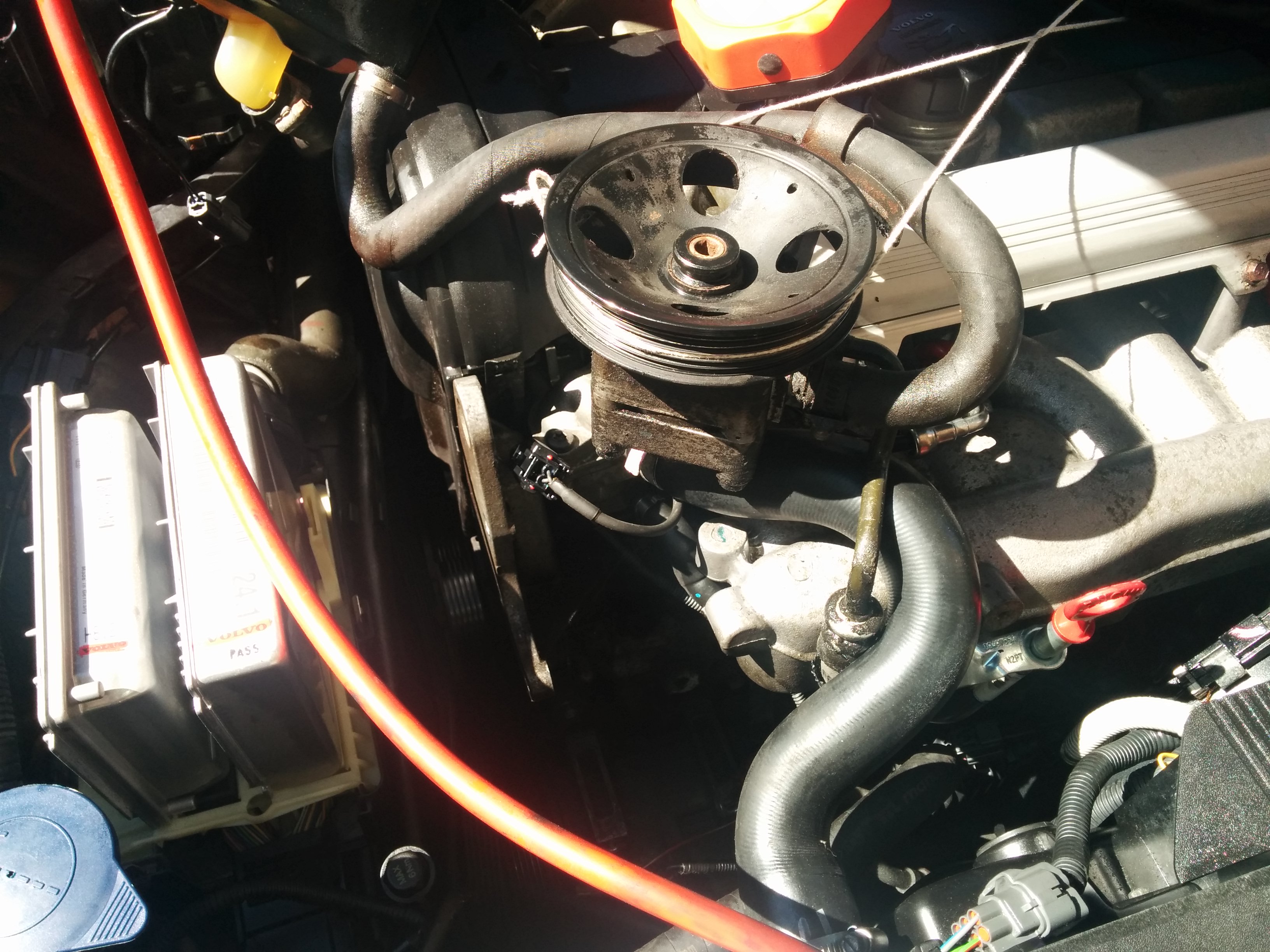

I'm not sure it would have been any easier... (starts transferring pics)

Hmm, won't let me edit to take that last picture off, or I'm an idiot, or both...
The alternator gets wedged between the upper AC mount and the block and in order to get the alternator out you have to loosen the bottom two AC compressor bolts about a 1/2" each, then you remove both upper ones. There is a bolt on the left of the alternator through the mount... Now start man handling and screaming obscenities at it...
Of course this assumes you already removed the 3 bolts that keep the power steering pump on and moved it out of the way...

And Abscate's signature holds true, the computer modules likely took a pretty big AC blast and lived... The headlamps and fog lights, not so much.
