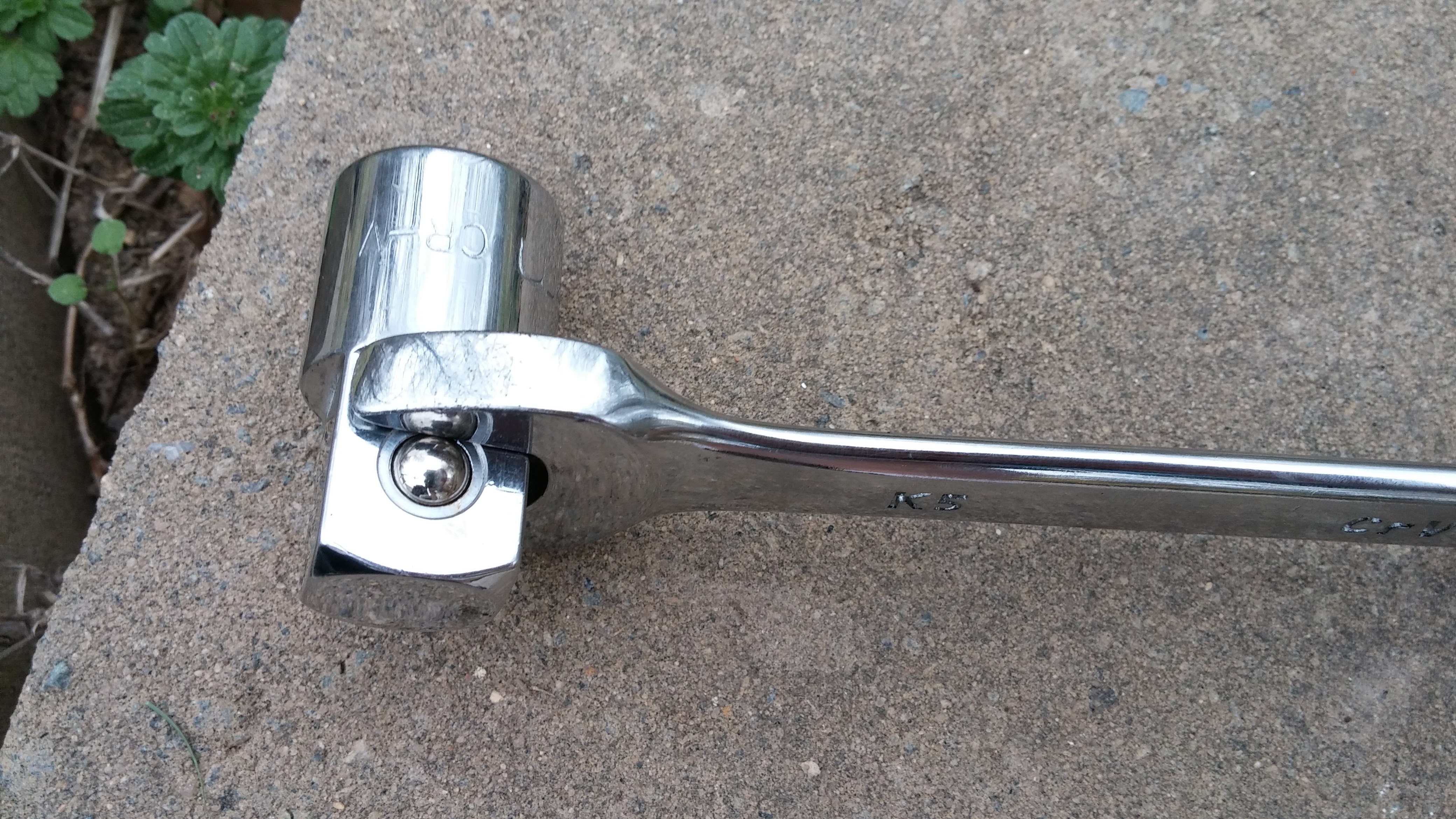

I am also going to be doing a major engine overhaul, replacing head gasket, water pump, tensioner, idler, timing belt, valve stem seals, cam seals, serpentine belt, rollers, etc.
I have almost all the parts, but I need an adapter to move the serpentine belt tensioner. Anyone know where I can get one?

It's really not worth spending any real money on a serp belt tool in my opinion (see viewtopic.php?t=60913). But if you must, you can get one at any auto parts store.

This is what I use...
1/2" to 3/4" drive adapter and a 19mm wrench. Works great on the OEM Volvo tensioner. But if you have a Meyle, this won't work unless you file down the sides of the square.
