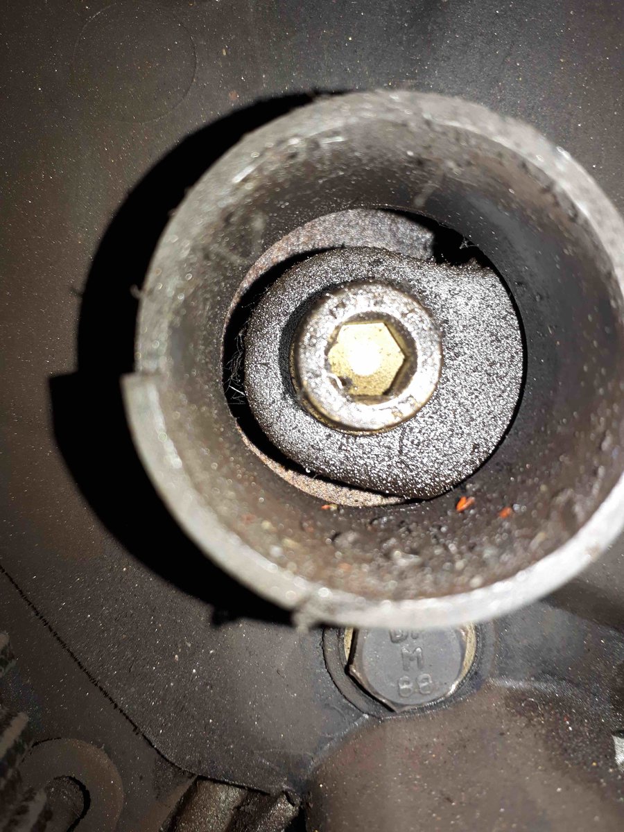

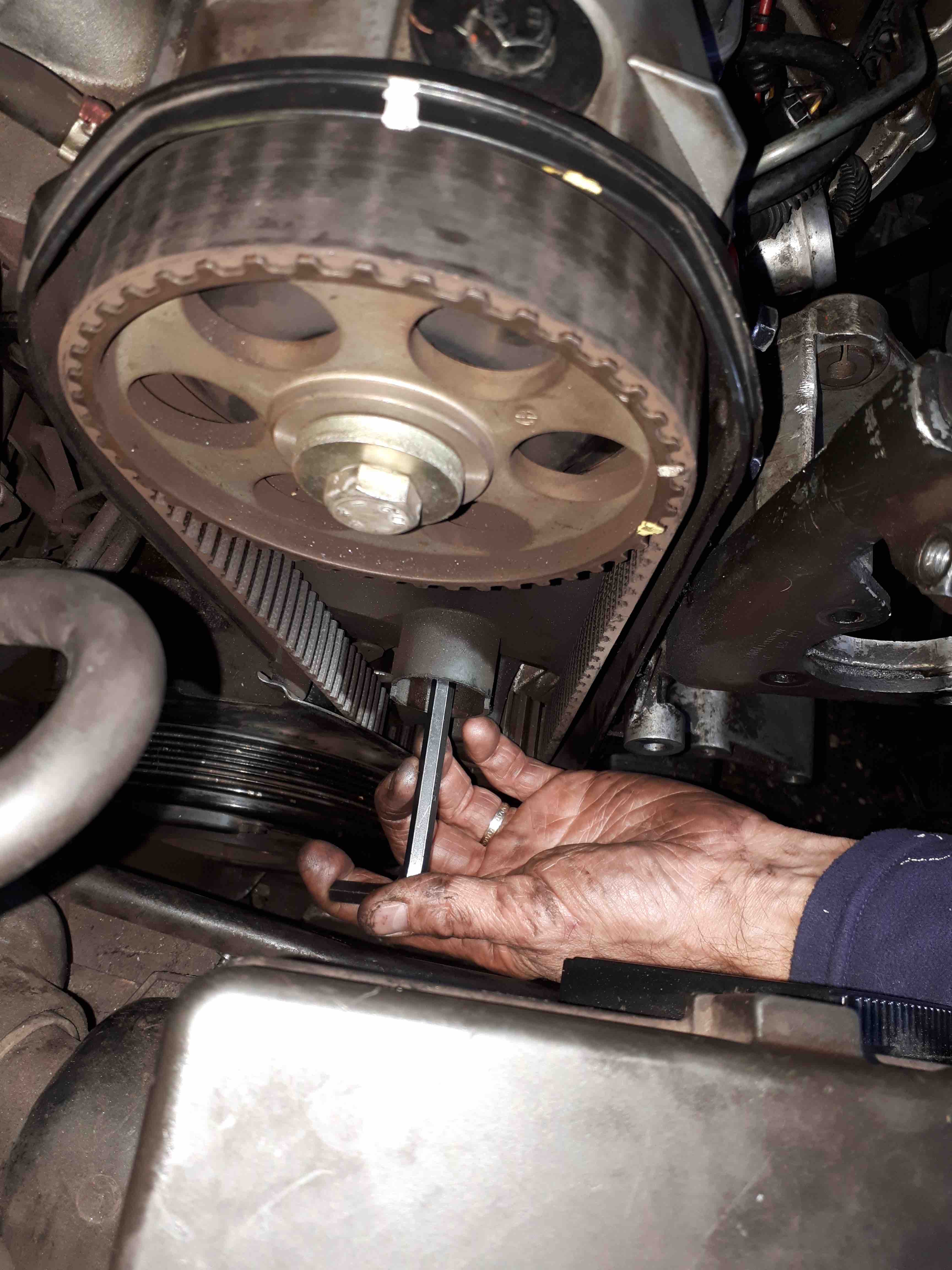

Well, at the end, assembling parts of several informations and the success is at the "rendez-vous"...Big applause to my wife Géraldine who has known have a different view on my engine, (I talk about the car of course...).
There is a screw, a 6 pans Allen, hidden under the cover of the timing belt, which was necessary to unscrew to free the accessories mounting.
A big up also to all of you who got involved in my issue. Sincerely "Merci ".
As you can see.
The 6 pans screw
The way to unscrew it: Do consider this topic solved.
As you can see.
The 6 pans screw
