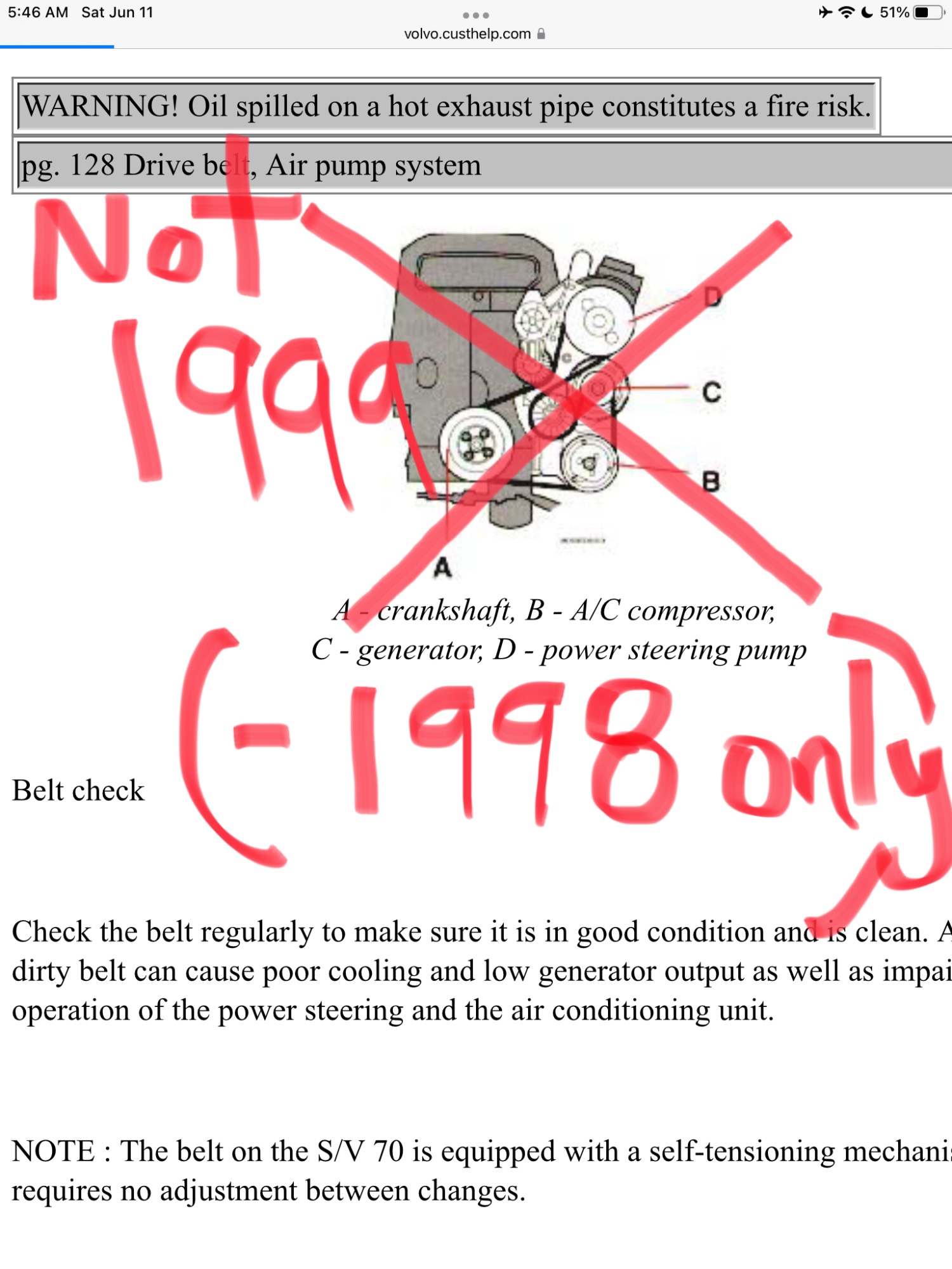

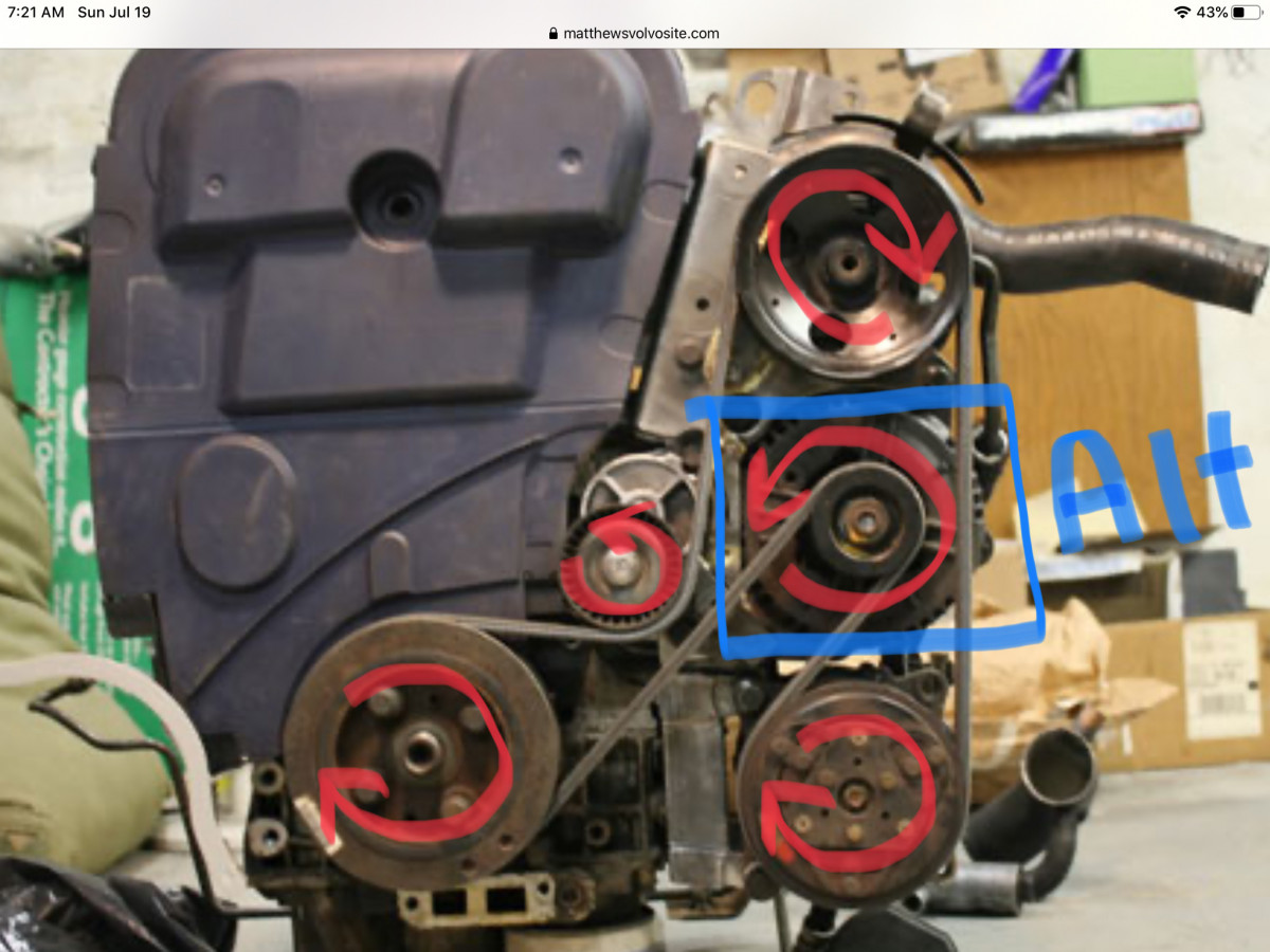

Yeah, those diagrams I posted are only for -98, I should have noted as such.abscate wrote: 26 Nov 2017, 08:53 Do you see the problem with the 1999- short belt routing? The alternator reverses direction of rotation so that a free wheeling pulley will no longer make juice. You could get home during daylight from an hour or two and a good battery
The Zexel AC compressor also mounts differently than pictured. 4 Long M10 x 150? Bolts run front to back into four mounts on engine vs the transverse bolts pictured above
P80 (-1998 , 1999-2000) Serpentine belt path route diagram picture

In pictures, old thread
Two things happened in 1999 that complicate
1 alternator rotation direction is reversed
2 the pulley clutch was added, so that the alternator is only spun in one direction internally.
If you short belt, a 1999, you thus won’t get alternator charging.

And reviewing maintenance and roadside fix procedures with Abby this week, I discovered the 1999 s/V70 owners manual has the 1998 *wrong* serpentine belt diagram in the service section!
Page 128 from the 1999 owner manual….fail!
