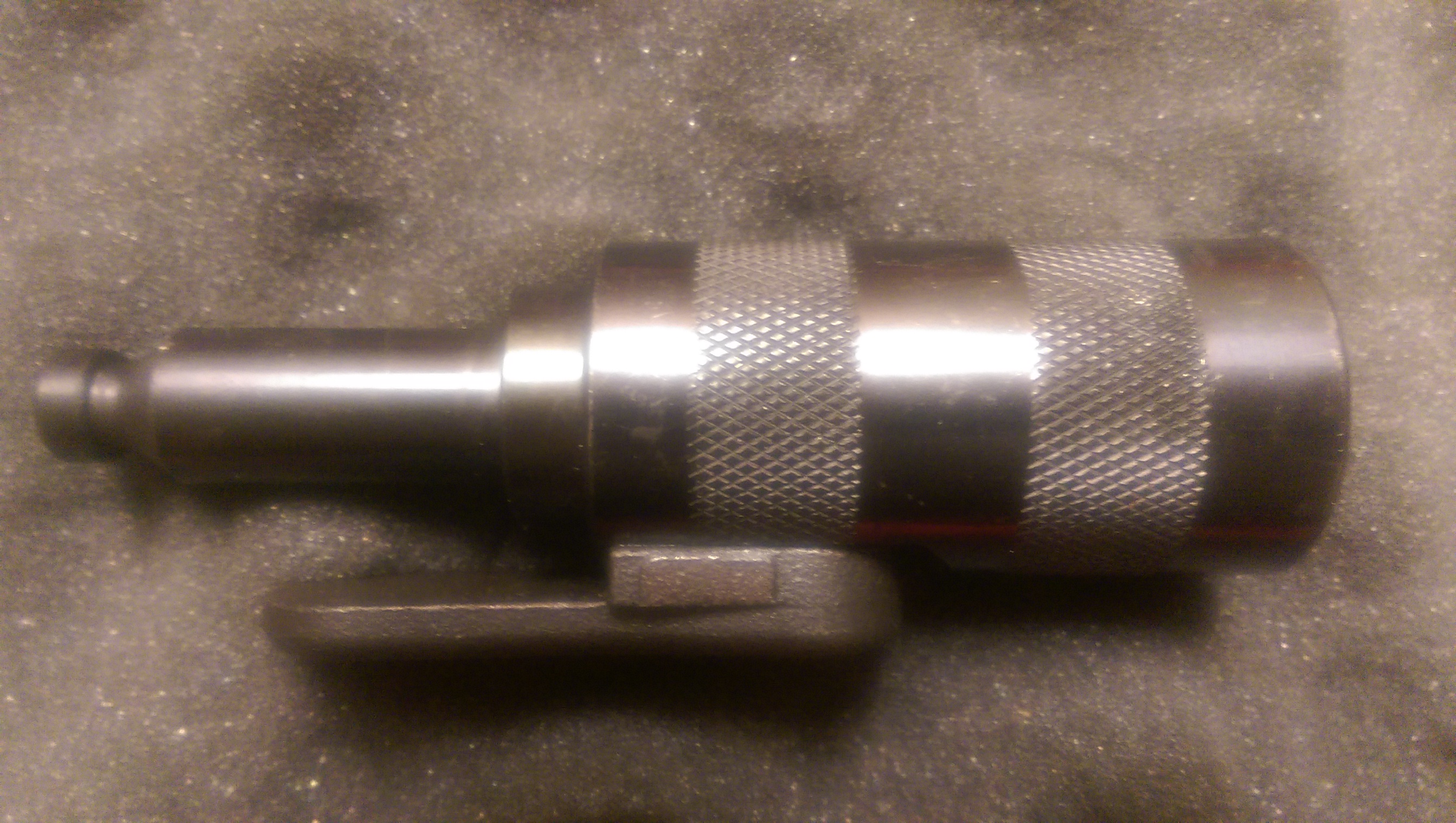

I've done a timing belt replacement. I can make sure it's lined up just like the TB replacement.
This time your be taking the timing sprocket and oil pump out. I would think, the oil pump and timing timing sprocket are keyed so that they can only be installed one way in reference to the crankshaft. But I don't know, never been in there. Keying is what I think I would do if engineering the thing.
If you take care not to lose the crankshaft datum in the disassembly, you can put it back together without the crankshaft alignment pin. If you lose the datum, you will need a crankshaft alignment pin to get find the datum on the crankshaft.
A Volvo Camshaft / Crankshaft Alignment Kit will run about $45.00 on Ebay.
https://www.ebay.com/itm/Volvo-Cranksha ... SwbYZXWPsP
Here is what the Crankshaft alignment pin looks like. I know on the six cylinders you got to pull the starter to insert the pin. I'll need to look it up for the 5 cylinders.
