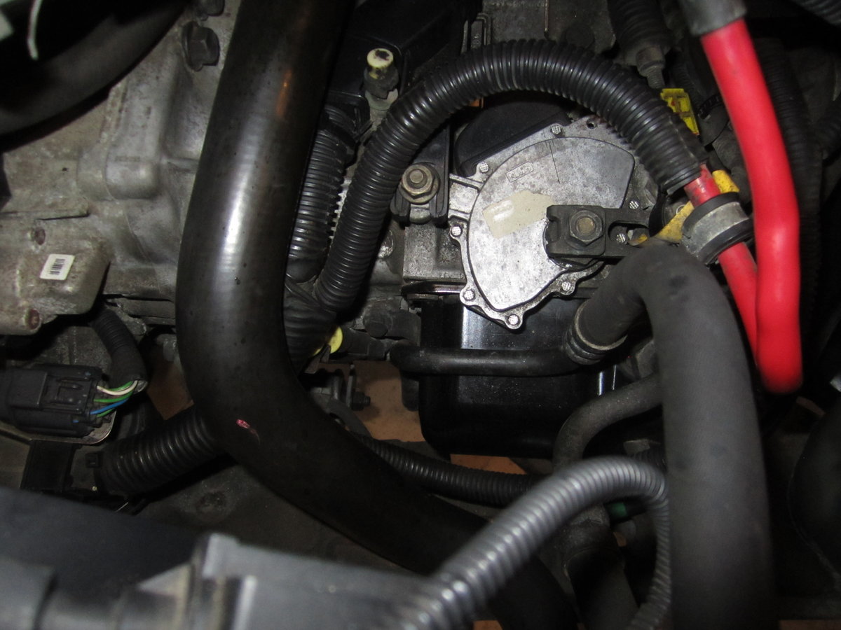

One other thing to check is the PnP switch/cable has not broken on the top of the transmission.
The switch is the silver colored crescent shaped think in the middle of the picture with one nut in the middle and one on the left holding the trans shifter cable in place. Have someone move the shifter cable and see if this end moves. Even if it moves it could have failed internally.
