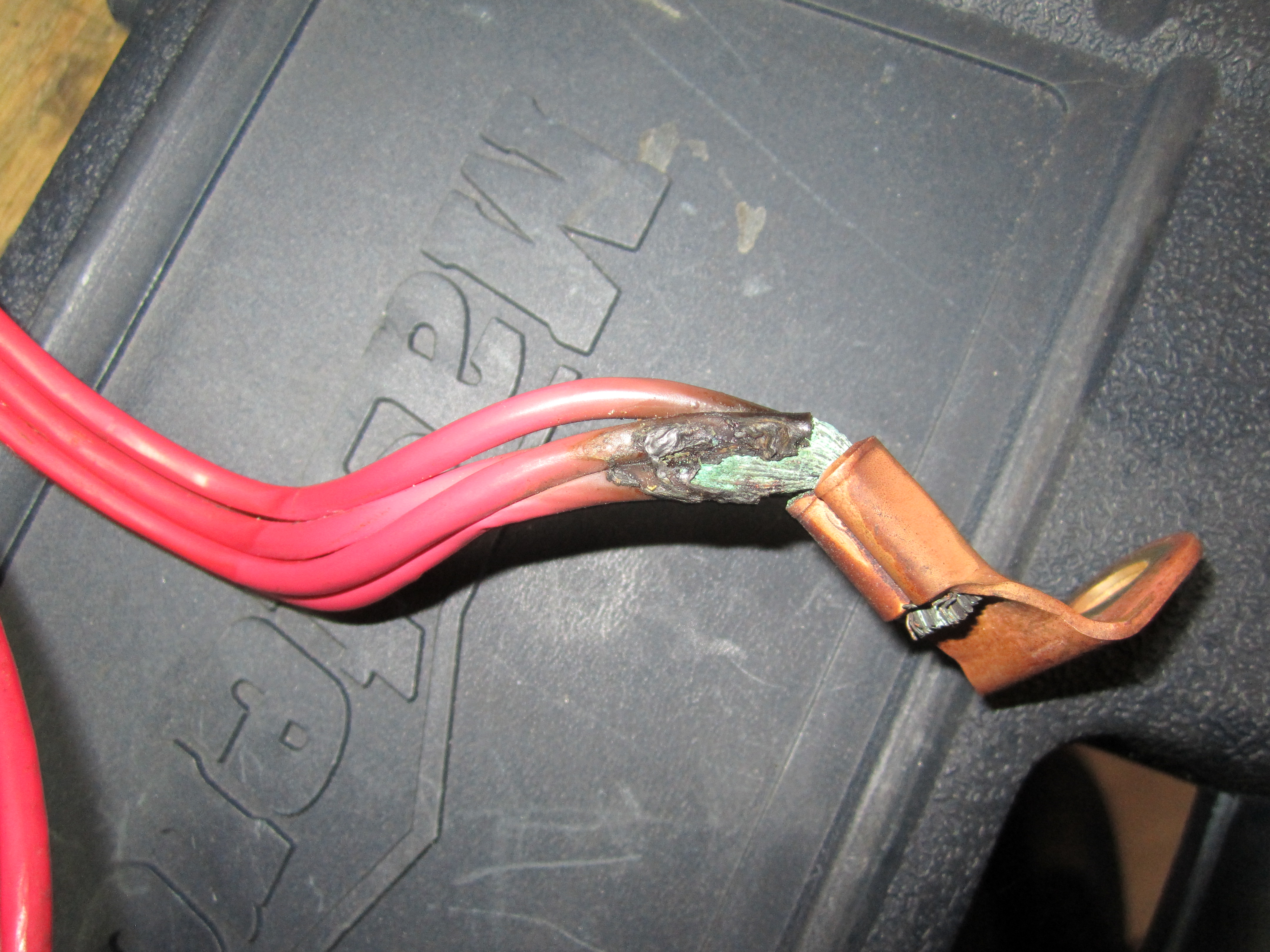

As you have a 99 car have the B+ cable from the +ve battery terminal cable (it is usually about 3-4 red wired twisted together), runs under the battery tray and along the LHS plastic wire cover and up to the kidney shaped main fuse box infront of the brake booster. Then remove the top of that fuse box and check the termination of the wire. It enters the front of the box and had a bras colored nut holding it in place. If this nut and wire end are discolored or matte colored, you need to check the wire under where it mounts. The wore melts and shorts out and can set the car on fire at worst case. Mine was totally melted and could easily have shorted to the ground plate in there. It is a known problem with later P80's and seems to affect 99-00 much more than the earlier 98 and older but is not exclusive.

Thanks Neil, I know the wire youre talking about and just took a look at it. Its in such good shape I wouldnt be suprised if its not original to the car.scot850 wrote: 15 Jan 2018, 10:33 As you have a 99 car have the B+ cable from the +ve battery terminal cable (it is usually about 3-4 red wired twisted together), runs under the battery tray and along the LHS plastic wire cover and up to the kidney shaped main fuse box infront of the brake booster. Then remove the top of that fuse box and check the termination of the wire. It enters the front of the box and had a bras colored nut holding it in place. If this nut and wire end are discolored or matte colored, you need to check the wire under where it mounts. The wore melts and shorts out and can set the car on fire at worst case. Mine was totally melted and could easily have shorted to the ground plate in there. It is a known problem with later P80's and seems to affect 99-00 much more than the earlier 98 and older but is not exclusive.
I hope this ends up being something like melting plastic on the exhaust, seems electrical the more I think about it or an intermittent pulley locking up. The smell goes away immediately when the care is turned off.

That does sound like something is touching something hot somewhere, and again hopefully it is the plastic bag thing...!
Above is what my B+ cable was like. Initially I thought it was fine until I was able to lift it after disconnecting it at the fuse box. I'm sure you have checked it well but don't be fooled by first impressions.
Good luck finding the source.
Do also check that no wire at the back of the engine has fallen down onto the muffler or manifold.
