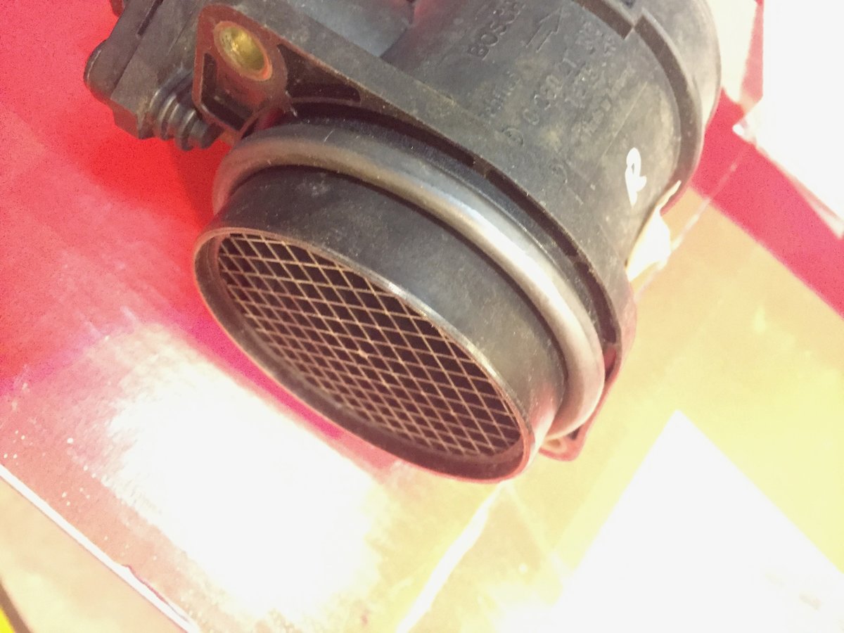

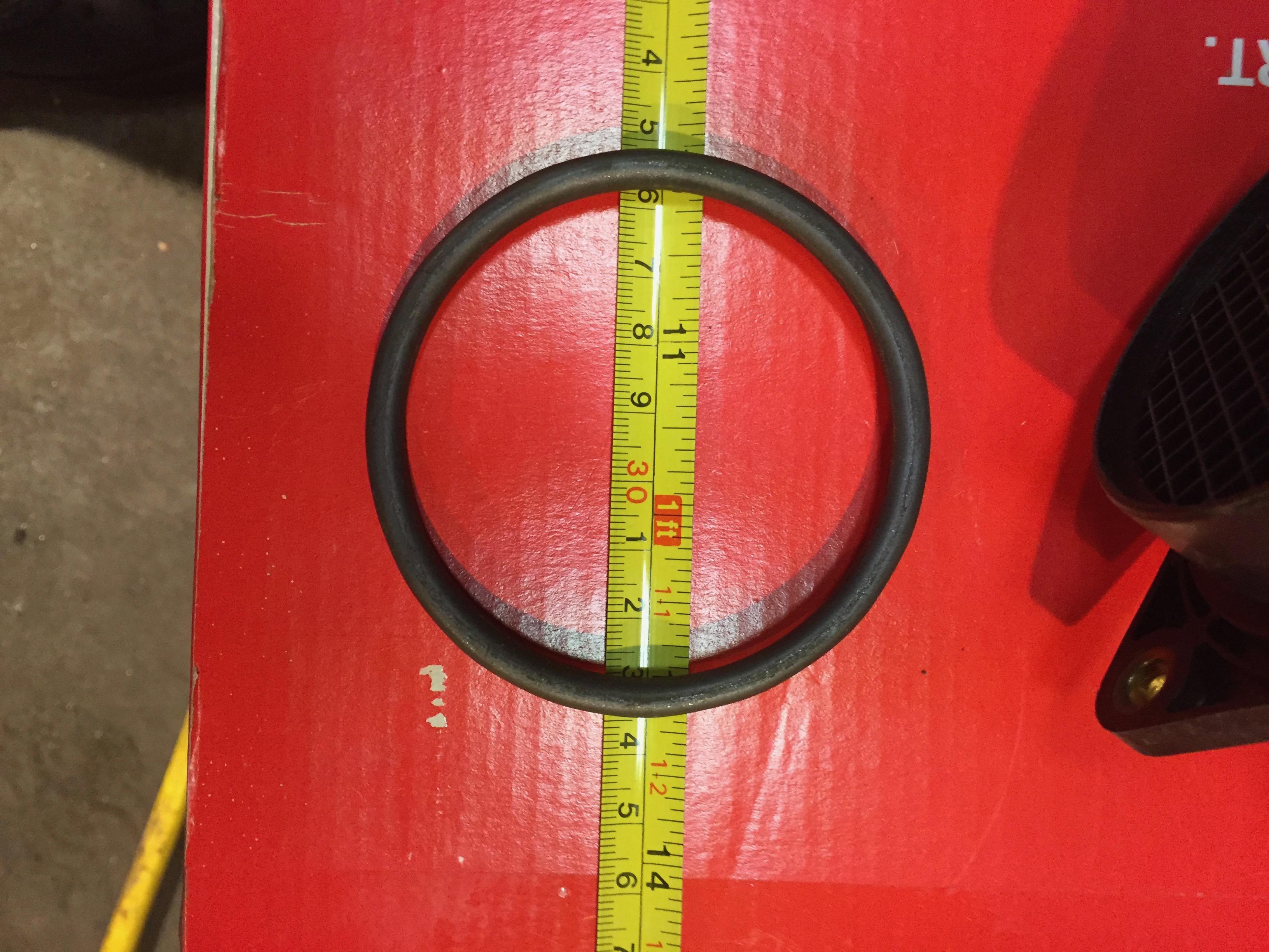

I just measured it at 81 mm, Neil's math checks out. All measurements are with calipers. Here are some photos:
You are a saint. That's the closest we've gotten to the right o-ring all day. How much searching did it take to find that diagram? Thanks for the pictures, now I actually have some idea of what this is suppose to look like.
