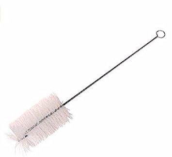

I have a idea for cleaning up the water jackets around the cylinder walls. Use a long handle bottle brush. Wall mart and Lowe's sells plenty of versions available. I would not use acidic chemical as residual might continue to eat the aluminum. June
Afterthought on my part; I think I have seen this type of brush with wire bristles.

I have a cylinder head that was stored where it was exposed to atmospheric moisture, it had some buildup like that. There was no other substance in the moisture. I cleaned it up with a brass wire brush and a skinny wire version of the type June shows. I think I bought the brush set at Harbor Freight.
It cleaned up well, tho there is a slight discoloration where the corrosion was. Not sure if that means anything.
