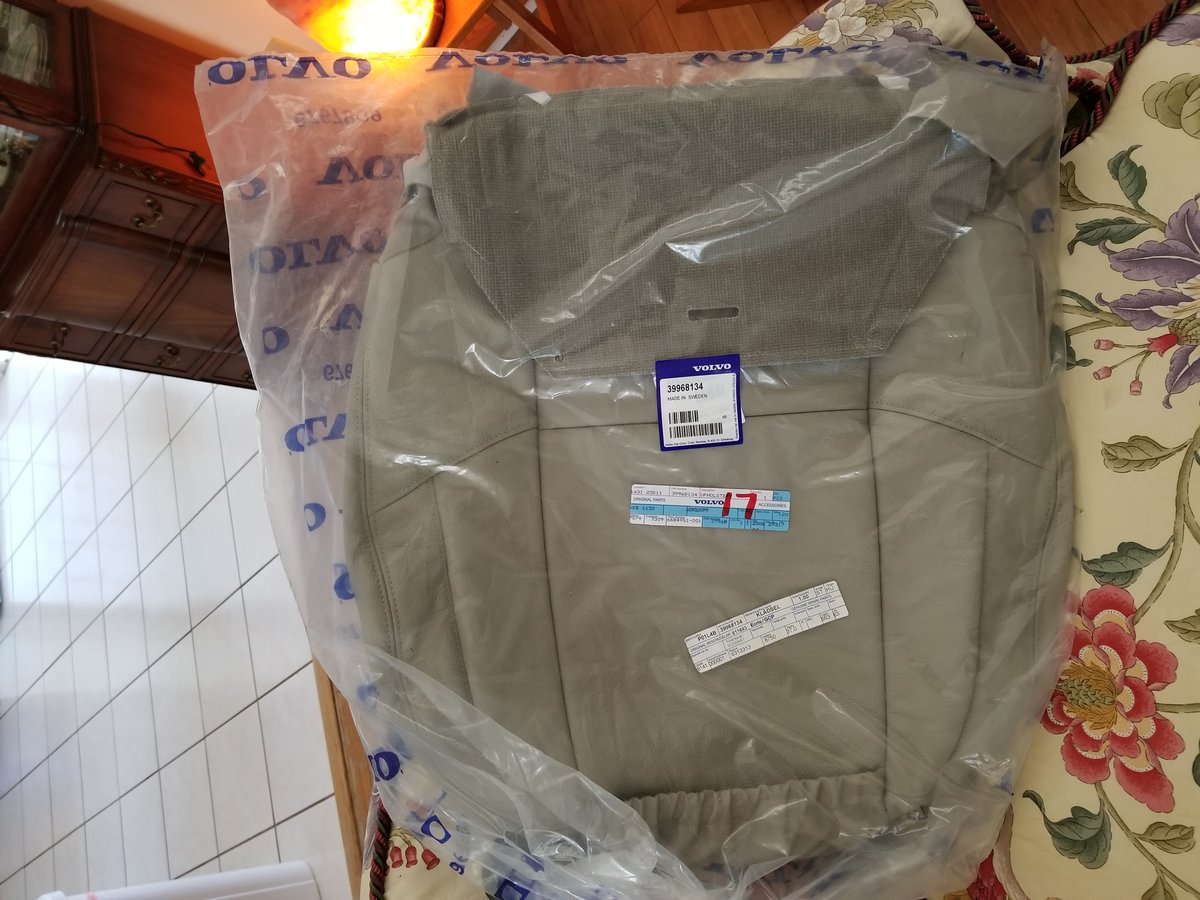

Seat leather problem? Check with one of MVS sponsor's OEM Parts direct! Just ask my hubby... BTW the seat bottom arrived today, so now I can have the new seat covers installed. I can't wait to have my seat feeling good again. June

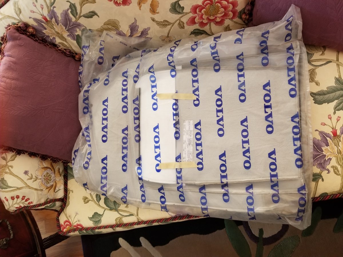

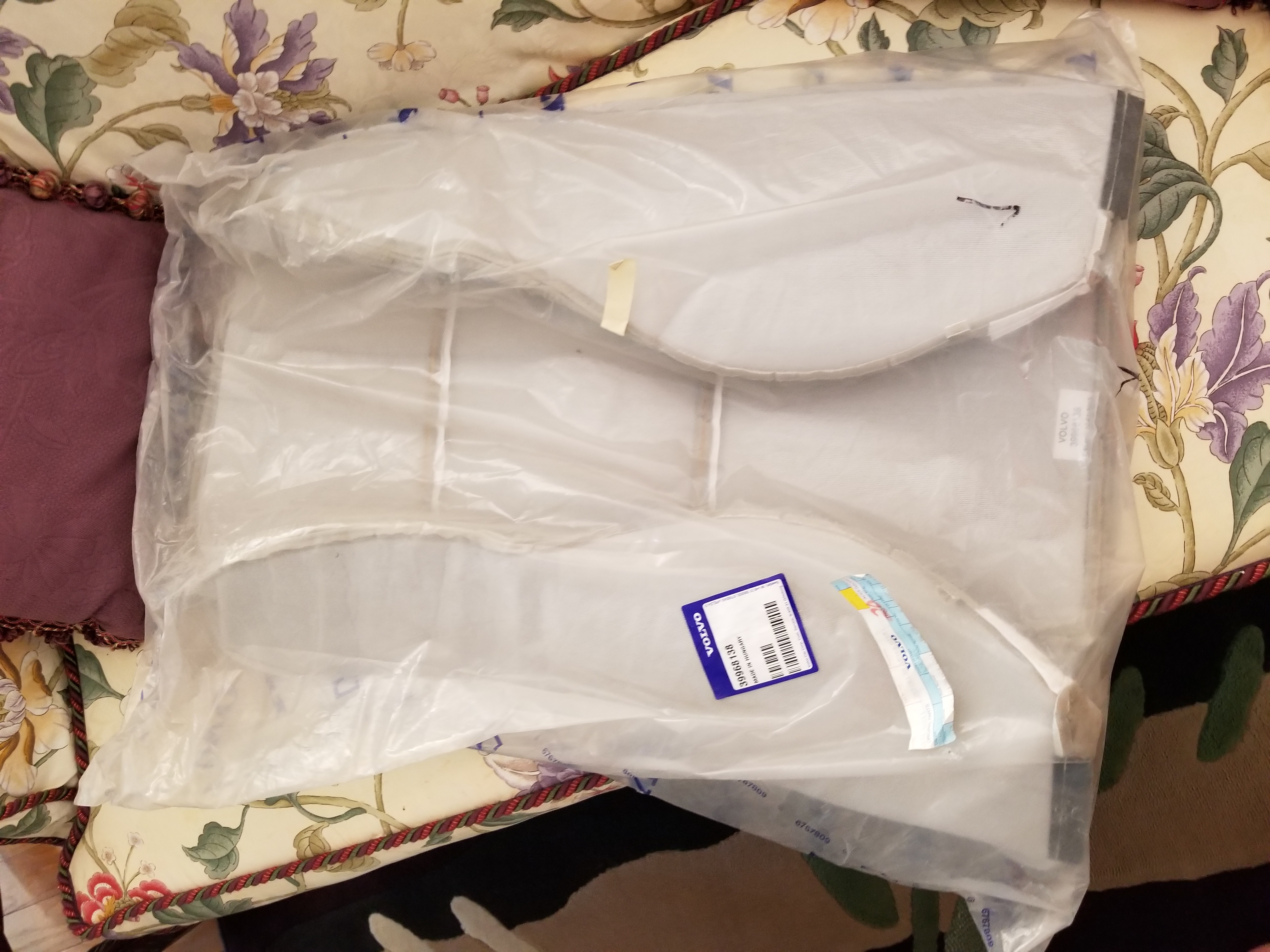

I was wondering the same thing! Since the headrest is stationary it does not just lift off. It must fasten in the back frame. My thought is remove the bottom fasteners than peel the leather up exposing the entire back framework making the seatcover wrong way out still attached by the headrest. Notice my sealed new Volvo seatcover for the back came wrong side out, but the bottom seatcover came right side out. It must come that way for a reason. Look at the photos I posted earlier. With the seatcover peeled up see what attaches the headrest. Being proficient in sewing that is what seems to me the way to go. June
